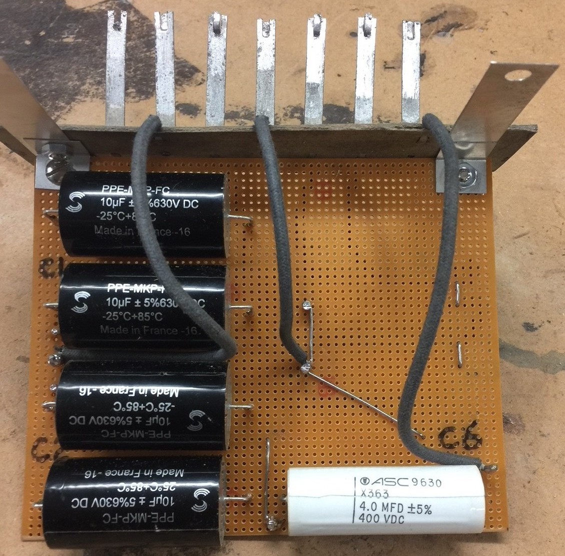

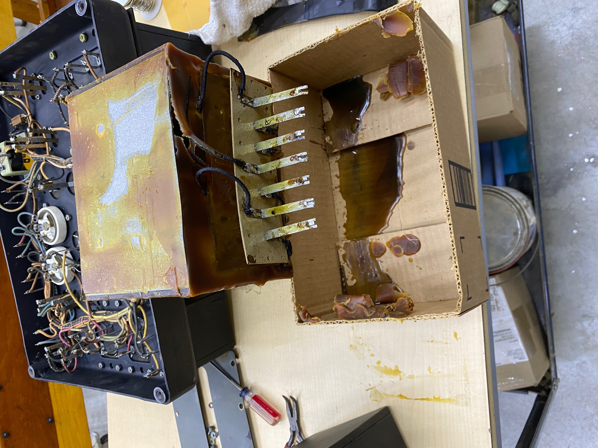

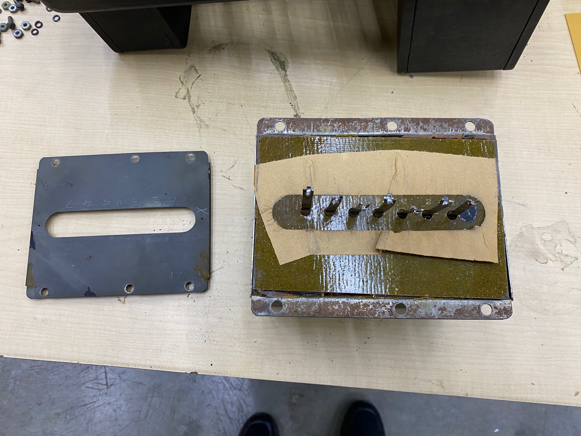

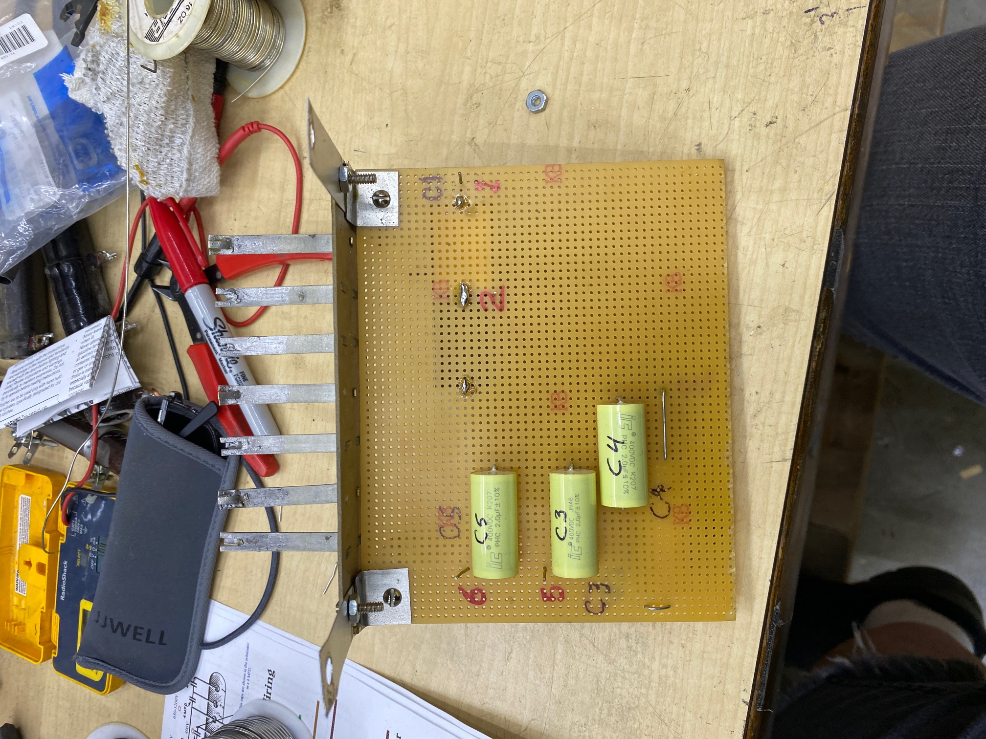

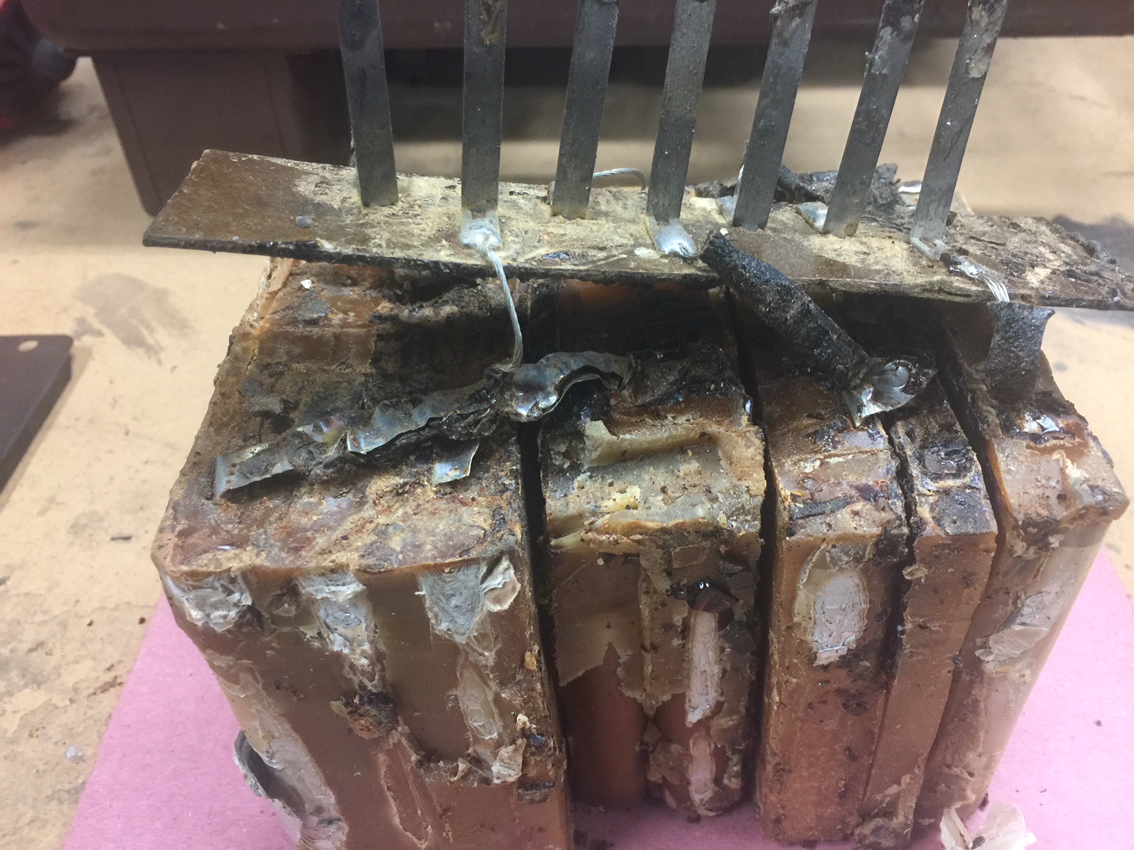

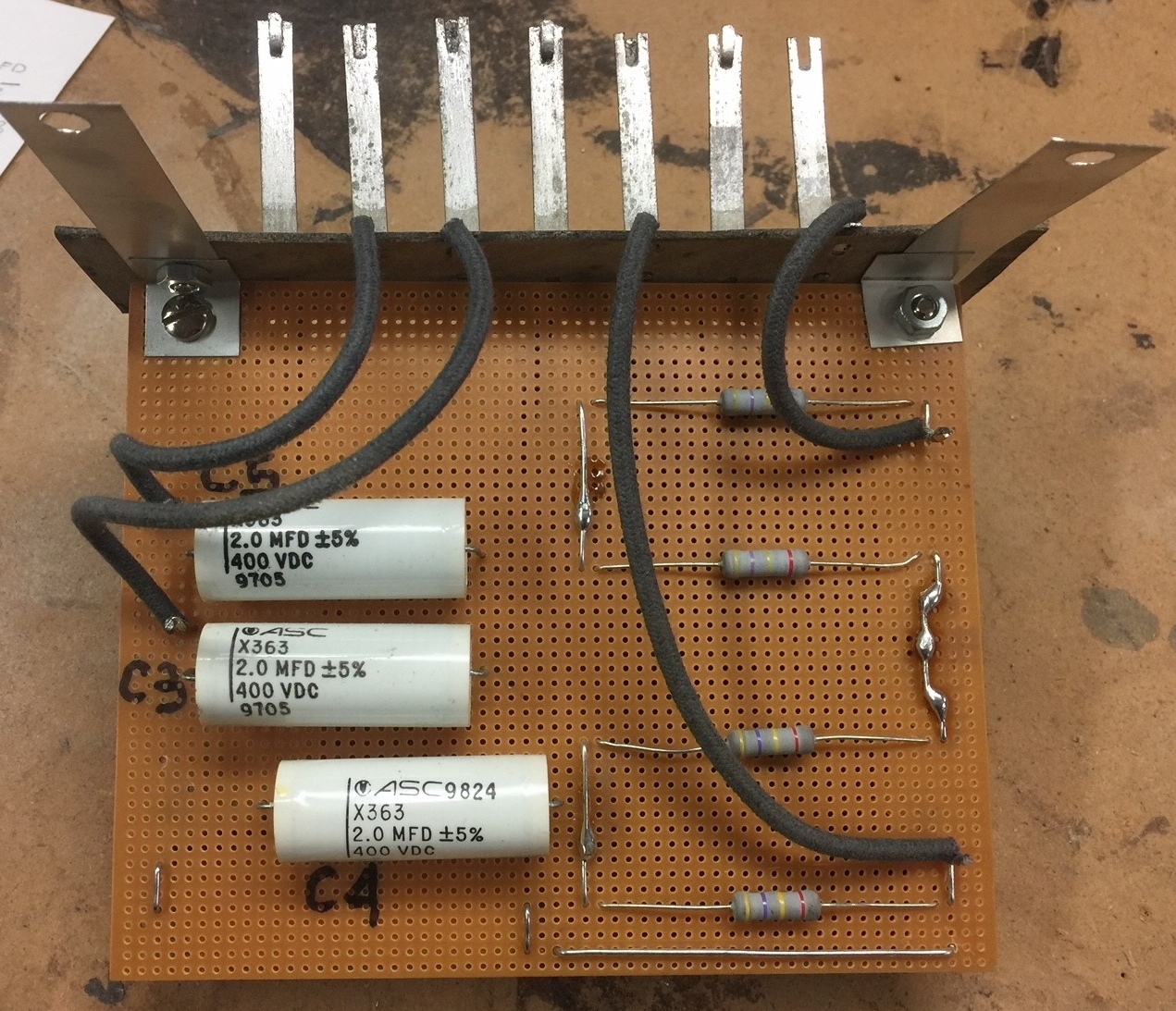

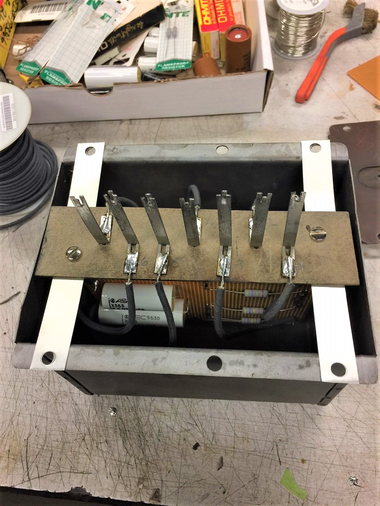

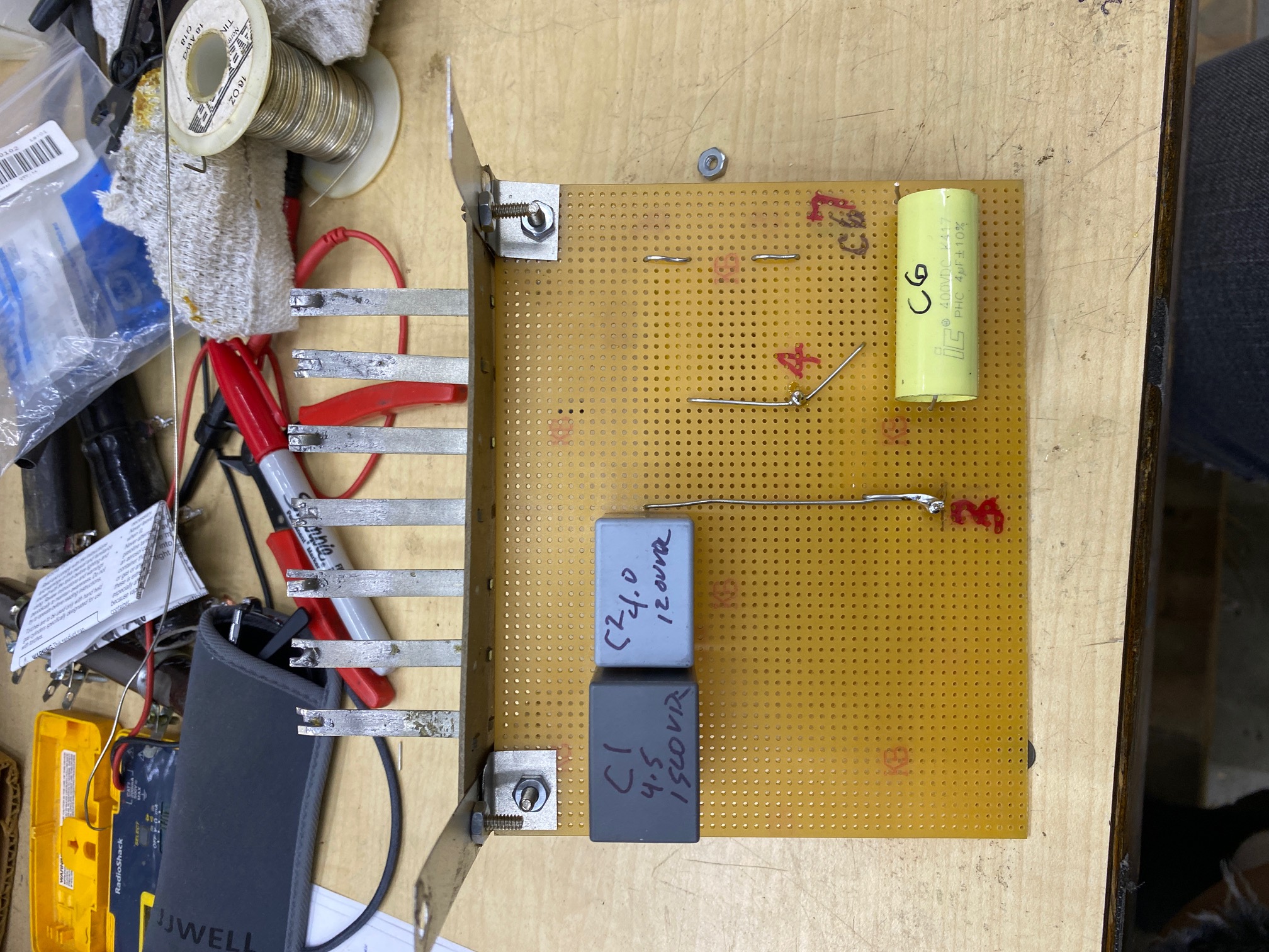

Photos of my Capacitor restoration..... doing it the neat way. Note: the capacitors are in wax not tar as someone else inferred. Much easier to melt out. ;-)
Carlton
Last edited by electrolaman 64 on Sat Feb 10, 2024 8:55 pm, edited 1 time in total.
