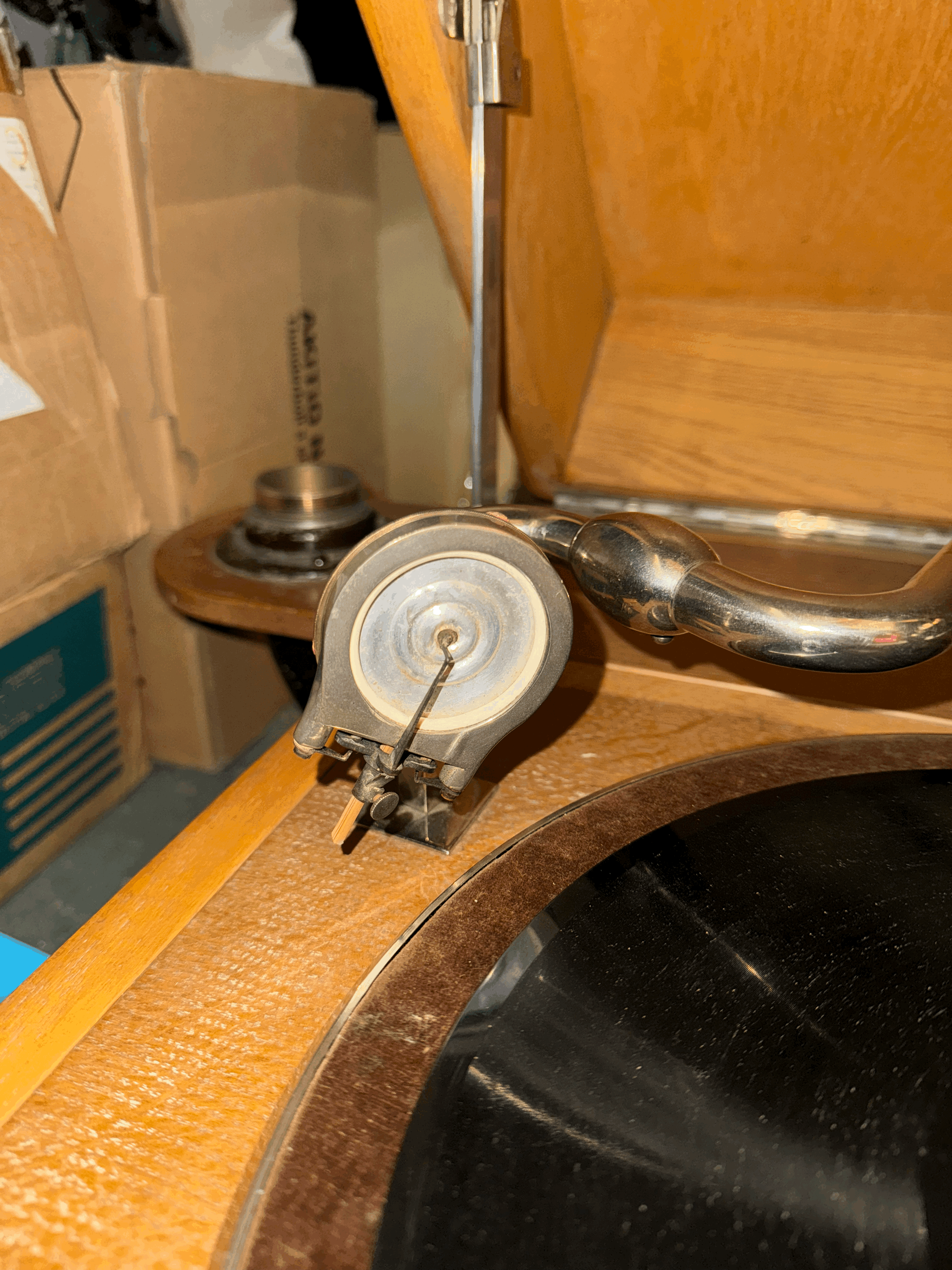

Here is the Mark IX I won from the auction. The identification number is ‘885’, but I am unsure of the exact production date this relates to. It would be great if anyone could help! I did use the forum, 'EMG Register to assist dating and EMG/Expert synopsis', but the links appear to have all expired.
The gramophone came with an off-brand soundbox. I used an Expert soundbox initially, but I really needed an E.M.G. horseshoe style. To my surprise, two days after I got the E.M.G., I saw a listing on Facebook Marketplace for many gramophone-related things (soundboxes, needle tins and more). Within this listing, I saw what appeared to be an EMG horseshoe soundbox. I messaged the seller at 1 am (when I saw the listing). To my surprise, he responded instantly. The following day, I set off on a 10-hour round trip at 8 am to collect the lot. I changed the rubber on the soundbox as it was in poor condition.
An unusual turn of events! I have attached images to this post.

Well Adam, many congratulations---that is quite a story ! To find the correct soundbox so quickly is extraordinary---well done indeed. What an exciting journey you must have had.
Thank you for showing the number which does give a vague idea as to date of manufacture. EMGs were numbered in the nineteen-thirties and post WW2 (Experts had no numbers) but there was no distinction made between models. Also, sadly, there are no records that anyone has found so far showing what exact dates those numbers referred to so it is usually necessary to make an educated guess. I have a note on file from Frank James saying that a Mk 10a No.412 is known to have been made in 1932. I own a Mk IX which had a broken horn when I bought it revealing the newspaper from which it was made. The Daily Mirror was able to confirm the date as 8th July 1948. The stamping on the deck-board shows No.2118. We thus have definite parameters and it would seem that your No.883 may have started life in the mid nineteen-thirties ?
I am fascinated by the fact that you had an Expert Senior four-spring soundbox in stock ?!
