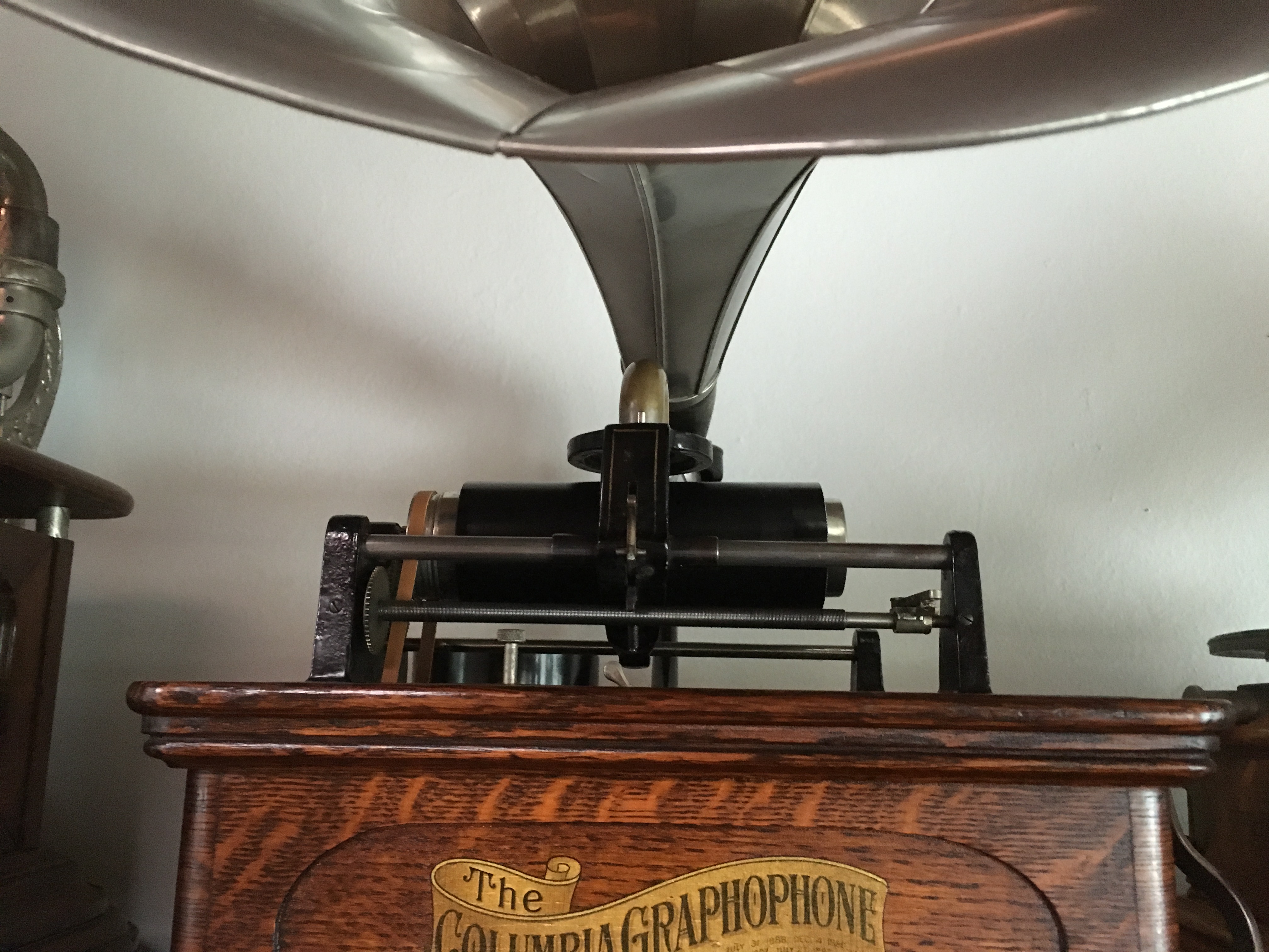

The BO did have a 2/4 minute option. I've owned mine since 1963, and it has a 2/4 speed control lever. It works perfectly.
- Curt A
- Posts: 6882
Re: Wanted 2/4 minute gearing for a BO Columbia Graphophone

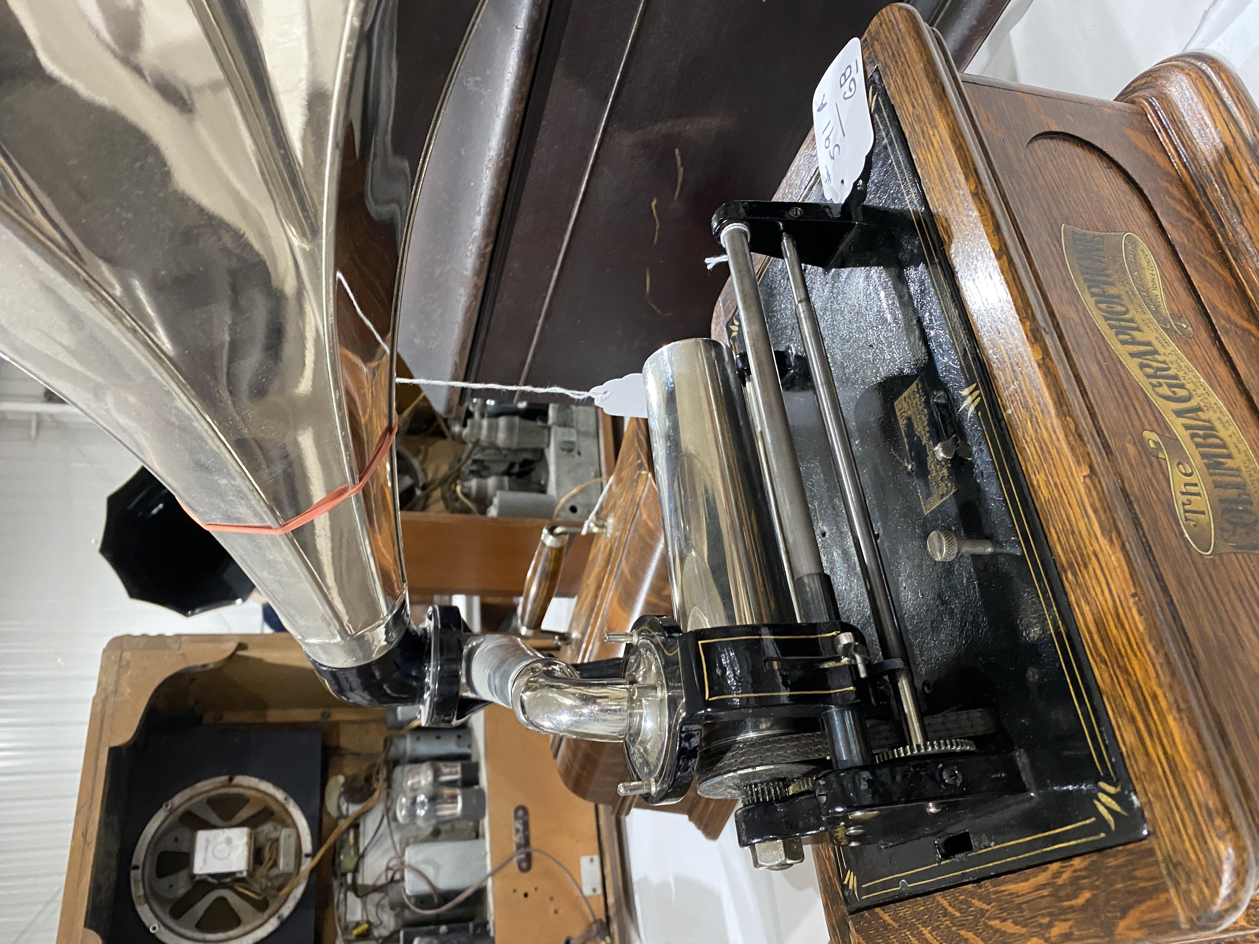

There are several types of Columbia 2/4 min conversions. You need to find the correct one for your machine. My BKT has a type with two levers on the feedscrew and my BFT has a round gear box attached to the end of the feedscrew. They are not interchangeable and both operate differently...
pallophotophone
- Posts: 364
- Joined: Tue Aug 14, 2018 7:35 pm
- Location: Syracuse N.Y.
Very interesting ! I know the gearbox at the end of the feedscrew shaft works via planetary gearing, but how does the 2 lever device work ?
