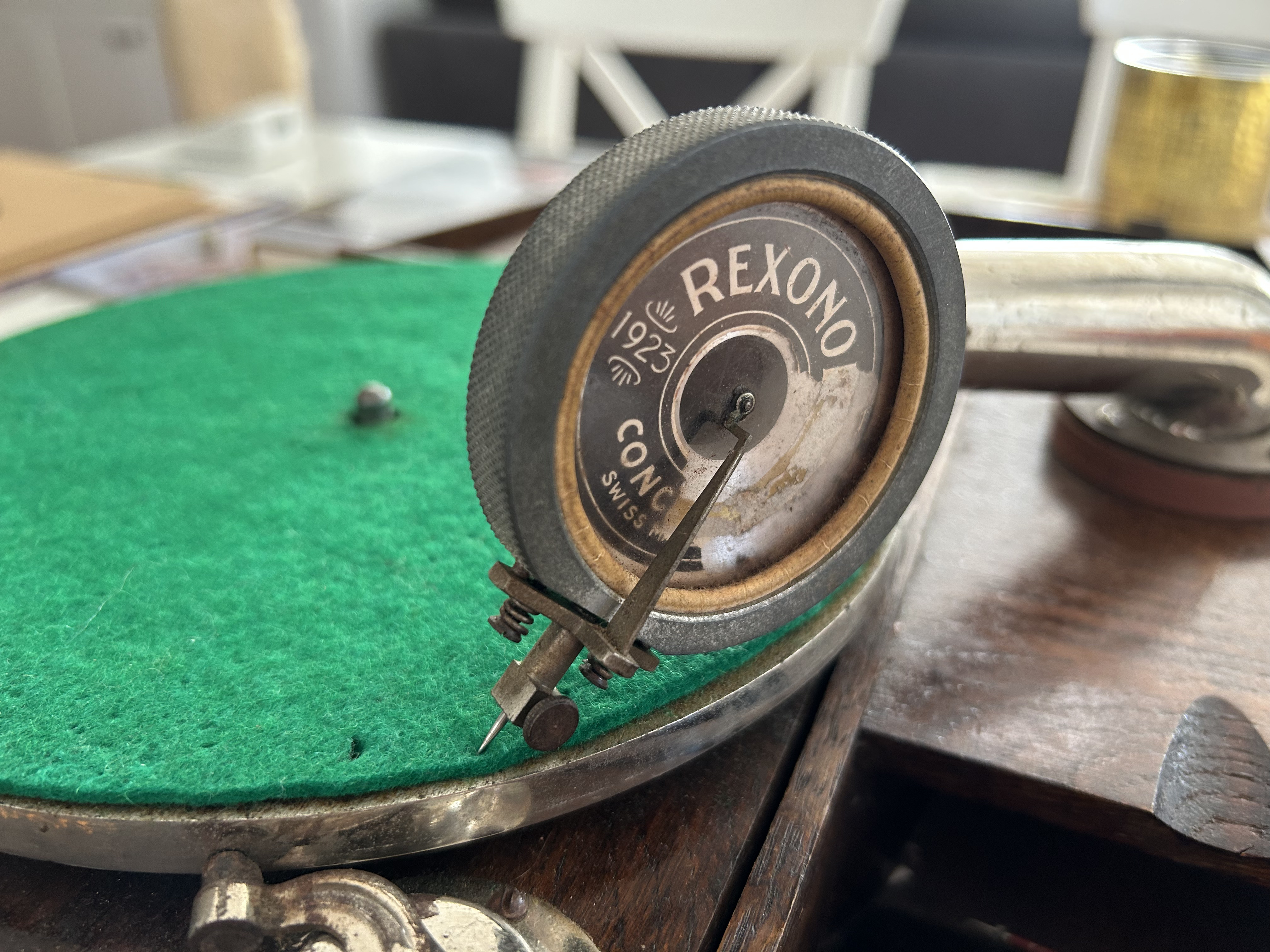

Well, it took me a while, but I've finally got around to having a proper look at the gramophone and taking some pictures. I actually clean forgot about it, which I feel a bit bad about!
Anyway, here are some pictures (finally!) of the gramophone in question:

Your reproducer appears to be in great overall condition, but will need to have the gaskets replaced.

Ok, I'll get straight onto it this time! I suppose it's simple enough to do? I'll probably need a bit of guidance, as I want to preserve the diaphragm at all costs.JerryVan wrote: Fri Jan 31, 2025 6:38 am Your reproducer appears to be in great overall condition, but will need to have the gaskets replaced.
I had a look on the web, and found some promising looking gasket material: https://www.ebay.com.au/itm/15413877834 ... xPYZSEUSAU
Do you think that would cut it? If so, I'll get some right away.
