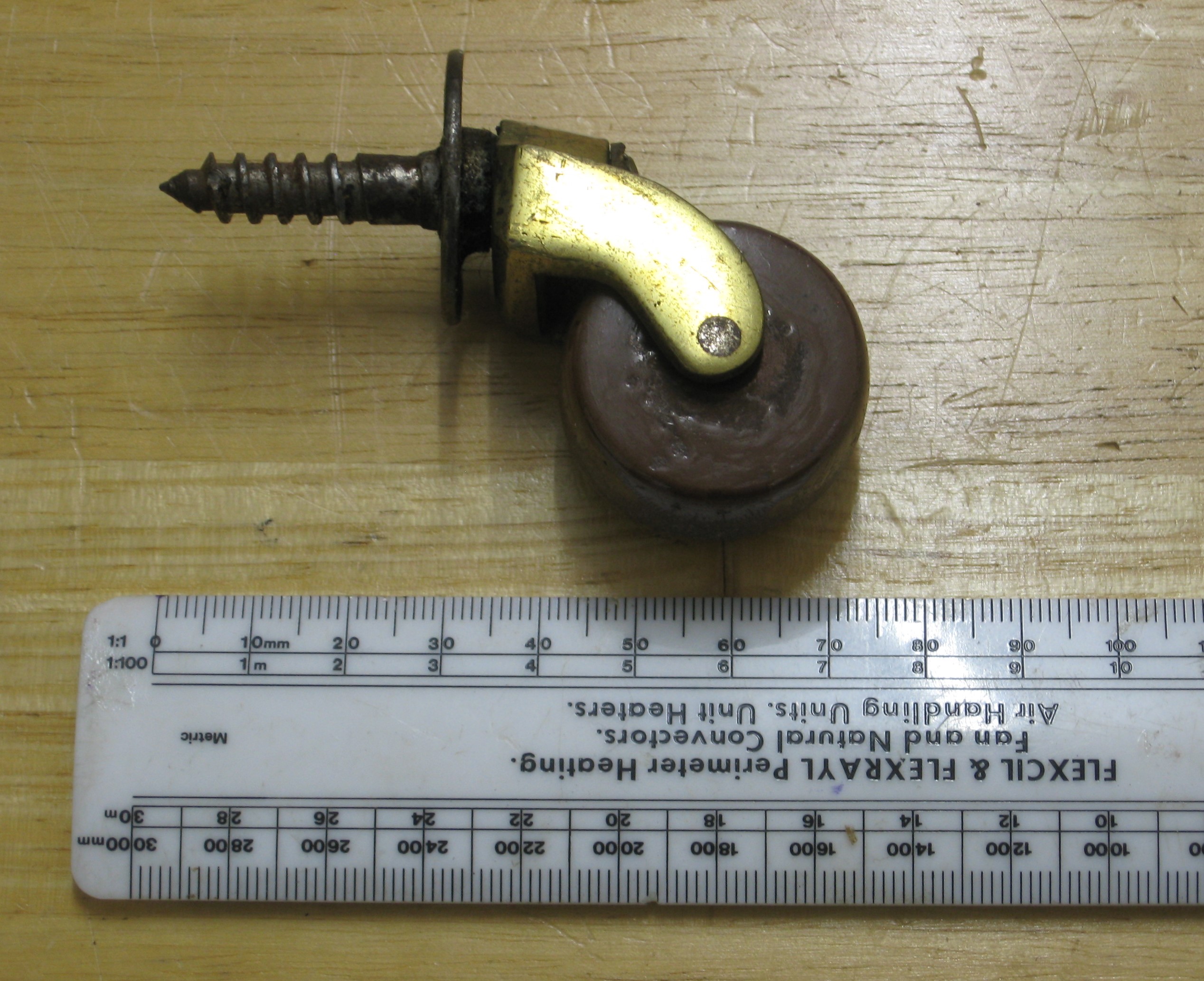

I have had this set of antique brass and ceramic casters for many years. To make it easier to move about I am considering fitting them to my HMV193, whose legs are 55mm square, but will the casters take it's considerable weight? If anyone has fitted similar casters to a large cabinet machine, could they please share their experiences.

Thank you Inigo. The casters which I propose to use are at least as old as the 193, but until I have help available I cannot lay it on it's back to work on it. If the casters prove unsuccessful I can always remove them and replace the original metal "feet", leaving my efforts undetectable.

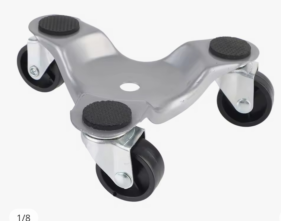

I've seen those little platforms with three wheels that you place under the legs (one under each leg) and this looks interesting and much more stable. Although they protrude out of the leg and could be disturbing when walking around the machine.
