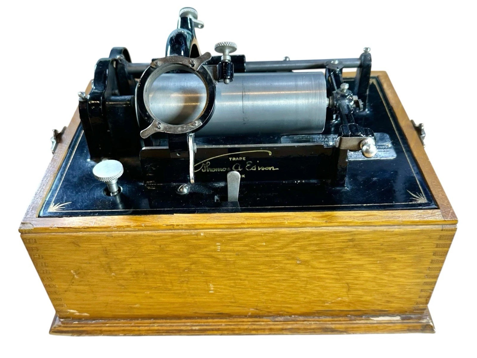

What would be the correct original reproducer for an Edison 2 clip Standard?
I'm thinking an Automatic or a Winged B?
Also would the original horn be 14" all brass?
Thanks in advance, Bob S.

Definitely an automatic. These can be 1898/1899, so I also think the all brass horn would be the one.

Yours is a 2-clip, so it's earlier than the more often-seen 4-clip. A more appropriate horn would be a black funnel.
