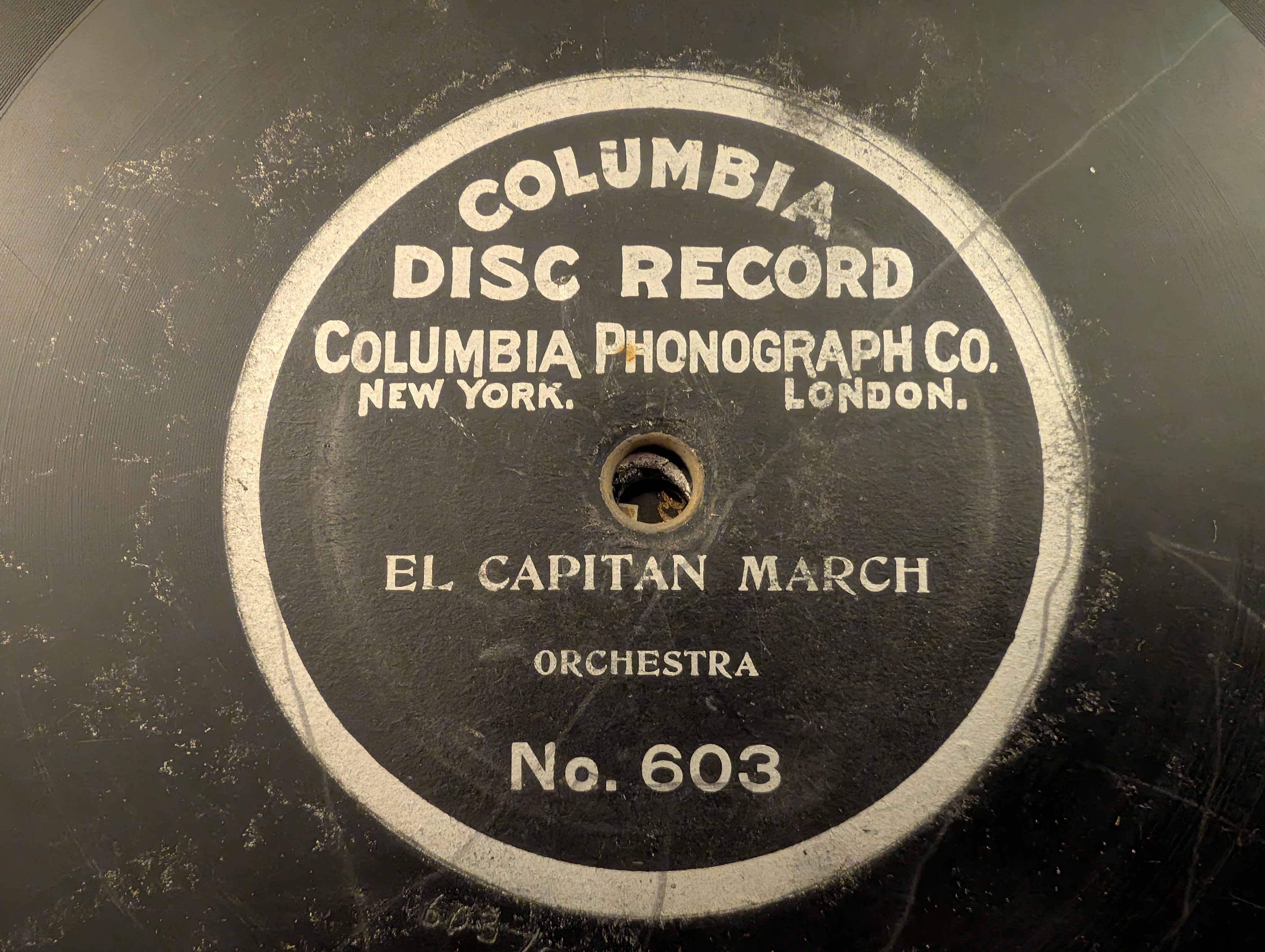

Greetings. I went to a local garage sale this weekend and found 5 pre-conditions Columbia 10-inch disc records, 4 with the silver ring around the rim of the label. Only one of those is of the very earliest type (according to "Note the Notes" -- a great resource, if you don't have it), without the patent dates. I'm not sure I have another one that old, and it raises a few questions:

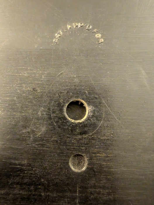

1. Is that a metal grommet in the spindle hole? I've seen those on 7" records, but never on a 10". None of the ones with conditions labels have them.

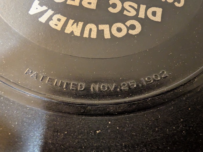

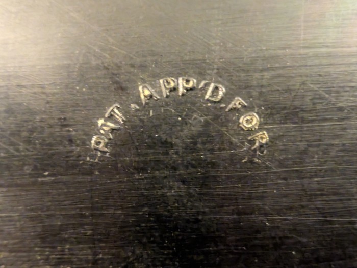

2. On the back it says "PAT. APP'D FOR." The record without the ring has a patent date stamped on it (see last picture), which makes me think this record must have been pressed before November 1902. Anyway: What was the patent for, exactly?
3. What is that round depression in the back of the record near the spindle hole (see second picture)? Why is it there? All of these discs have it.
The grommet is a vestigial remnant of the Globe Record Company's manufacturing technique. The transition from Globe to Columbia has been detailed in articles in the APS magazine, as well as in The Talking Machine Compendium and Discovering Antique Phonographs.
Offhand, I don't recall, but you can look that up on Google Patents.
That's another feature of Globe pressings which carried over into early Columbia pressings after the pressing plant was moved to Bridgeport. The original purpose of the depression was to engage the pin in a Zonophone turntable. Again, the relationship between Zonophone, Globe, and Columbia can be found in a number of places, including those mentioned above.

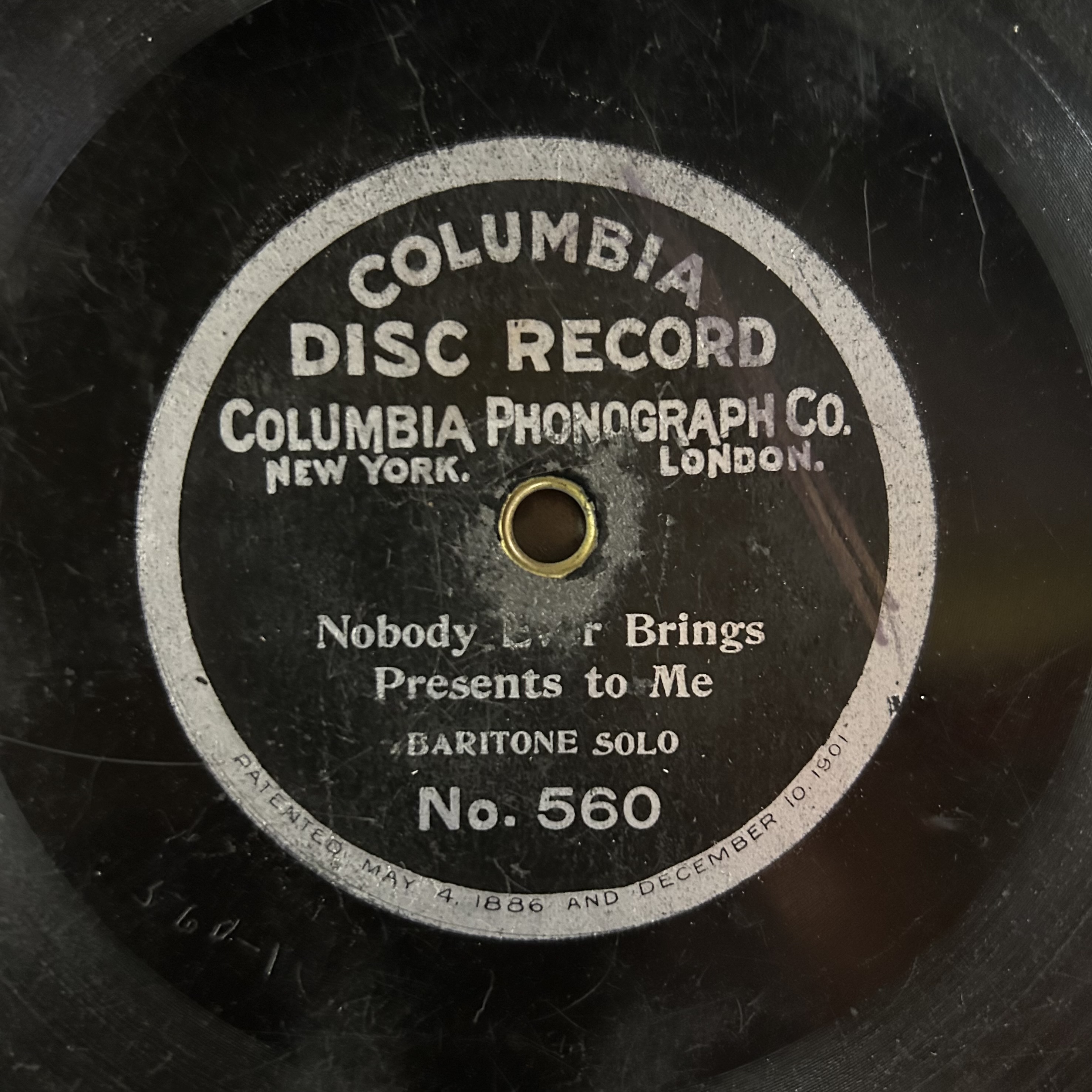

I found my record - 10” Columbia No.560, Nobody Ever Brings Presents To Me, which the DAHR says was recorded sometime between 1902 and 1905, though they list it as a 7-inch disc. Perhaps mine is a slightly later pressing? When were 7” discs phased out?
There is no label on the back, or any sign that there was one.
It is announced, “by Mr J.W. Myers”.
I wonder why the label just says baritone solo, when the artist is announced on the record.

Hoodoo wrote: Sun Dec 28, 2025 5:51 pm I found my record - 10” Columbia No.560, Nobody Ever Brings Presents To Me, which the DAHR says was recorded sometime between 1902 and 1905, though they list it as a 7-inch disc. Perhaps mine is a slightly later pressing? When were 7” discs phased out?
Victor and Columbia recorded the same titles in both 7" and 10" formats. 7" discs weren't phased out until 1905-1906.
Hoodoo wrote: Sun Dec 28, 2025 5:51 pm There is no label on the back, or any sign that there was one.
The major record companies often had the same selection recorded by different artists. Sometimes artists died or were otherwise unavailable. When that happened, another artist was called in to record the selection when the matrices wore out. If the label didn't specify the artist, the old labels could be used rather than thrown away.
