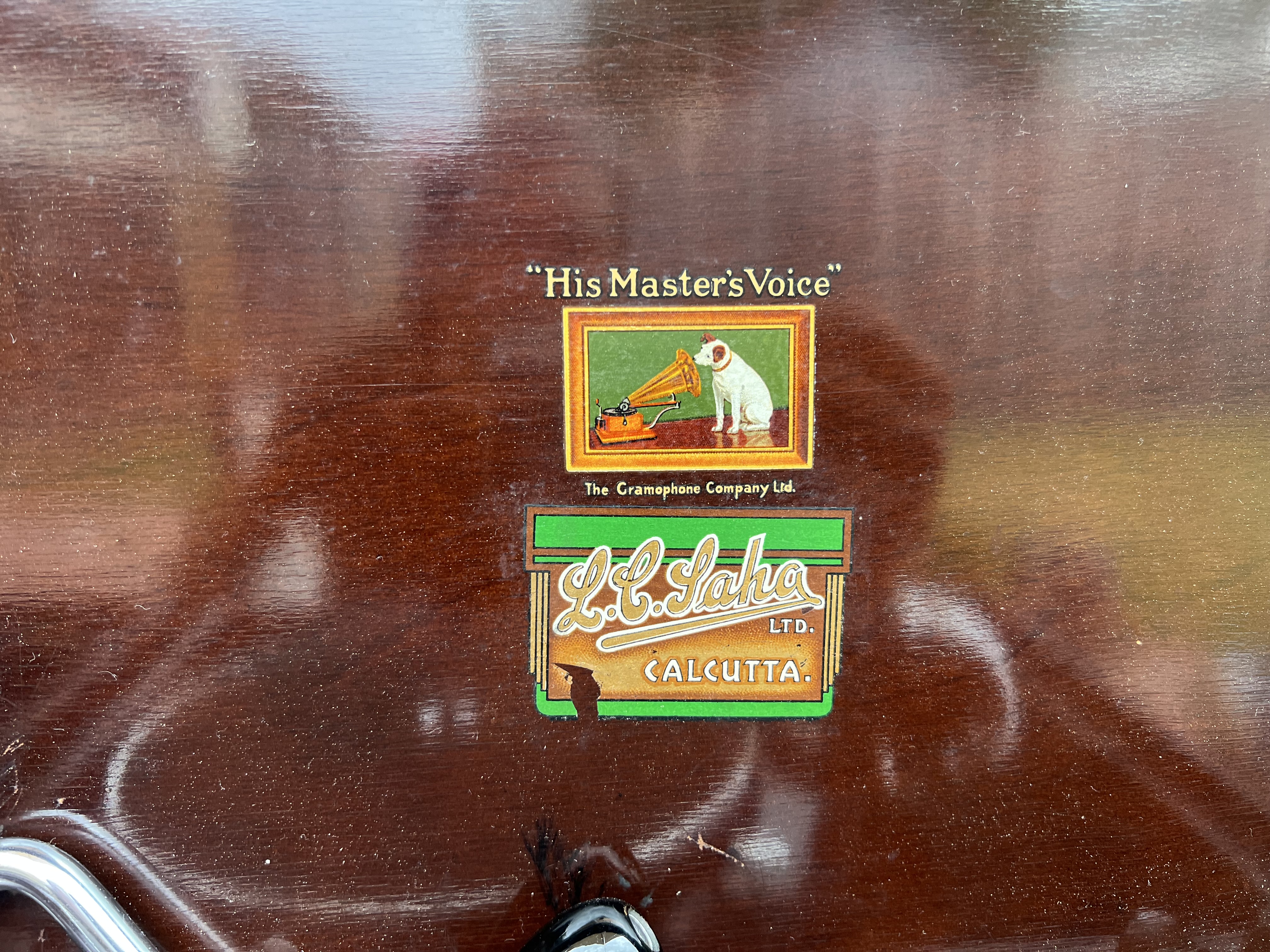

The custom water decals made especially for this 118 machine by Eduardo were excellent, but looked a bit too bright and modern. Covered them under a thin layer of ruby shellac and now they look even more vintage than the orgininals.
Watanabehi
Posts: 343
Re: Project HMV 118. Too far gone?
Post by Watanabehi »
Jaso wrote: Tue Feb 10, 2026 11:03 pm The custom water decals made especially for this 118 machine by Eduardo were excellent, but looked a bit too bright and modern. Covered them under a thin layer of ruby shellac and now they look even more vintage than the orgininals.
Wonderful work!! It is just beautiful. Thank you for showing your amazing restoration work.
