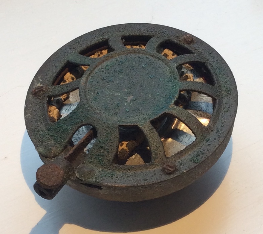

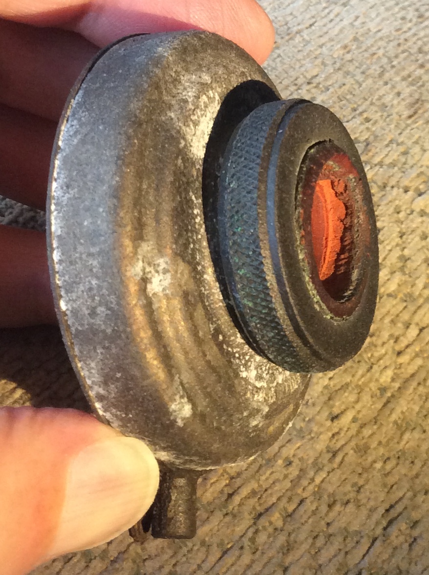

Coincidentally I have just acquired a Meltrope 3 soundbox. A derelict one found attached to an equally derelict HMV hornless machine from an attic. But can it be saved?

If the diaphragm is okay then I would say it definitely can be saved.
I wonder if the back twists off ? - I have several different versions of this style of Meltrope 3 and non of them do. However, they can be connected to the tone-arm quite easily with a new rubber part.

The diaphragm has a couple of creases at the edge but I believe they could be flattened. The back should unscrew but is seized.

Sounds restorable then I think.
It may not 'look pretty' to some but hey, I think it deserves a second chance.
I meant to say earlier that three of my Meltrope 3's with this specific style of front cover have all got seized back covers. I guess it is a common problem. Trying to 'force it' off of course could well cause the sound-box to break. (Pot metal swelling apparently).
However, replacing the old 'red/pink' rear rubber fixing with one of the newly made soft 'red/pink rear rubber fixing / rings found on ebay should ensure that it fits onto the tone-arm easily without any unscewing being required. (Famous last words) ...
I did this to my 'daily play sound-box' (marked 'Meltrope 4') and it sounds very good indeed.

Before a new rubber can be fitted the old rubber needs to be removed, and this can be difficult with the compression ring seized on.
The old rubber can degrade to the consistency of hardened glue. Don't ask me how I know......
