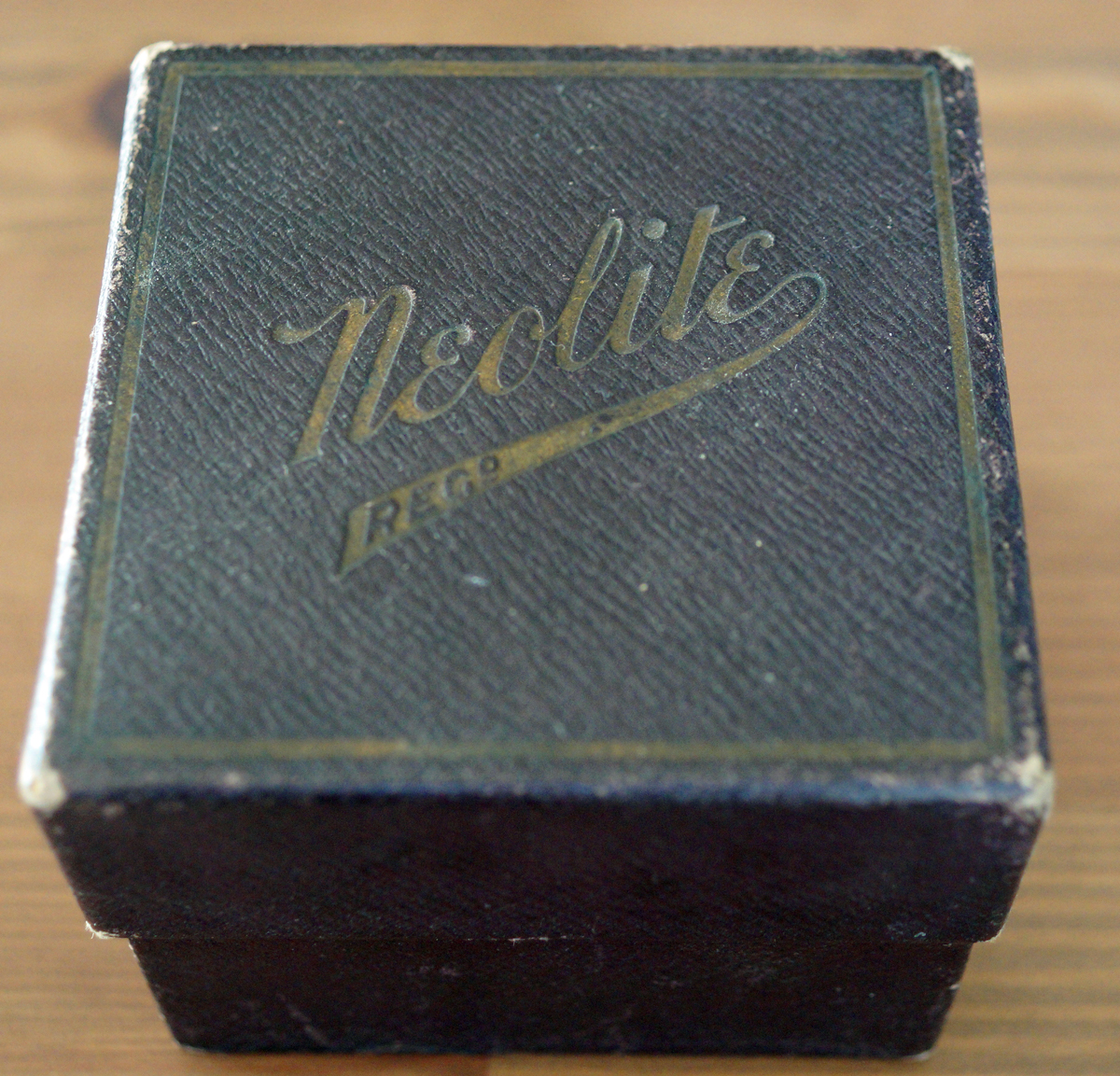

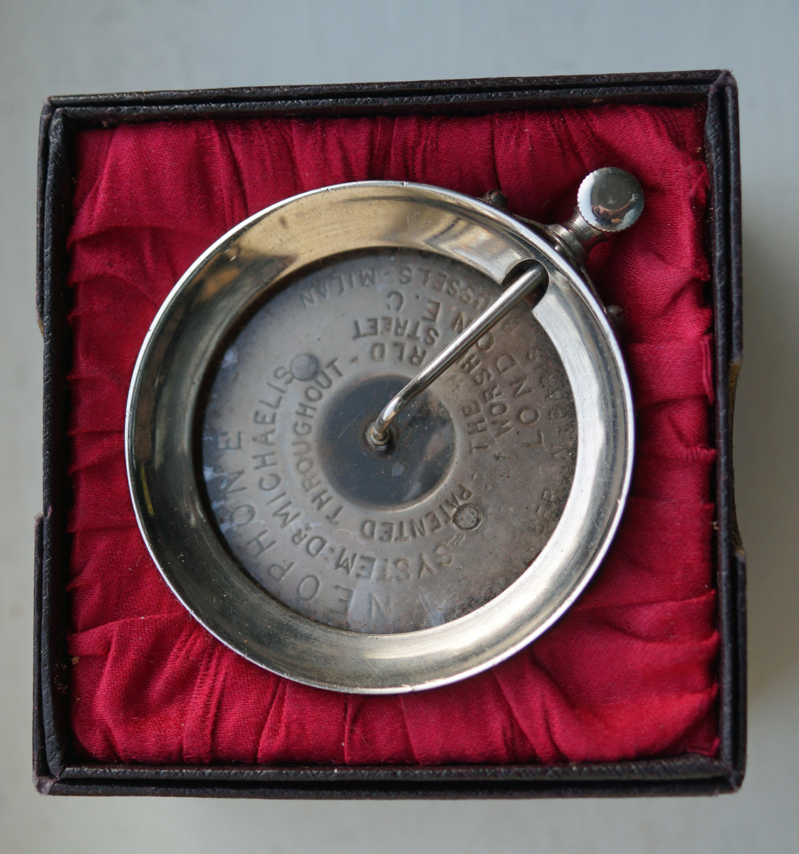

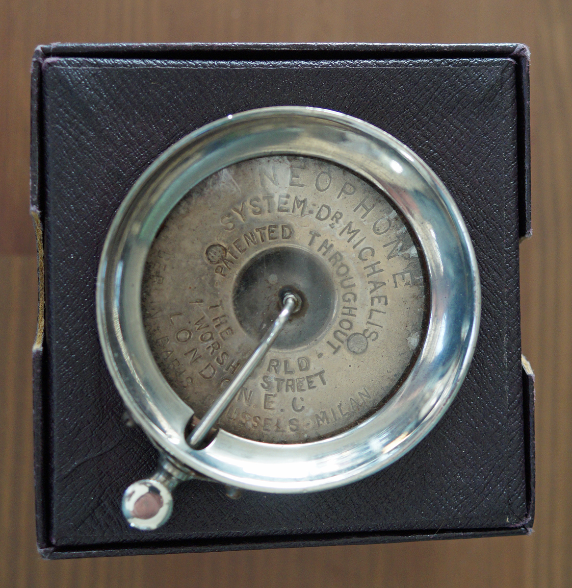

Post by poodling around »
I don't really know anything about this sound-box.
I looked on the internet and still am 'non-the-wiser' ........... well not much.
I wonder what kind of gramophone it was used on ?
Any further /other information would also really be appreciated too.
Thank you as always.

Thank you for posting. I think this is a rare soundbox dating to around 1906-08. ‘Neolite’ was the name given to the material Neophone records were made of which are also very rare. This appears to be a kit you could buy to convert your gramophone to play the Neophone records which were vertically cut.

jamiegramo wrote: Sun Feb 22, 2026 9:08 am Thank you for posting. I think this is a rare soundbox dating to around 1906-08. ‘Neolite’ was the name given to the material Neophone records were made of which are also very rare. This appears to be a kit you could buy to convert your gramophone to play the Neophone records which were vertically cut.
Very interesting information indeed.
I would never have guessed, but now you say it, I understand that it is a 'kit' and could fit many different types of gramophone of 'the time'.

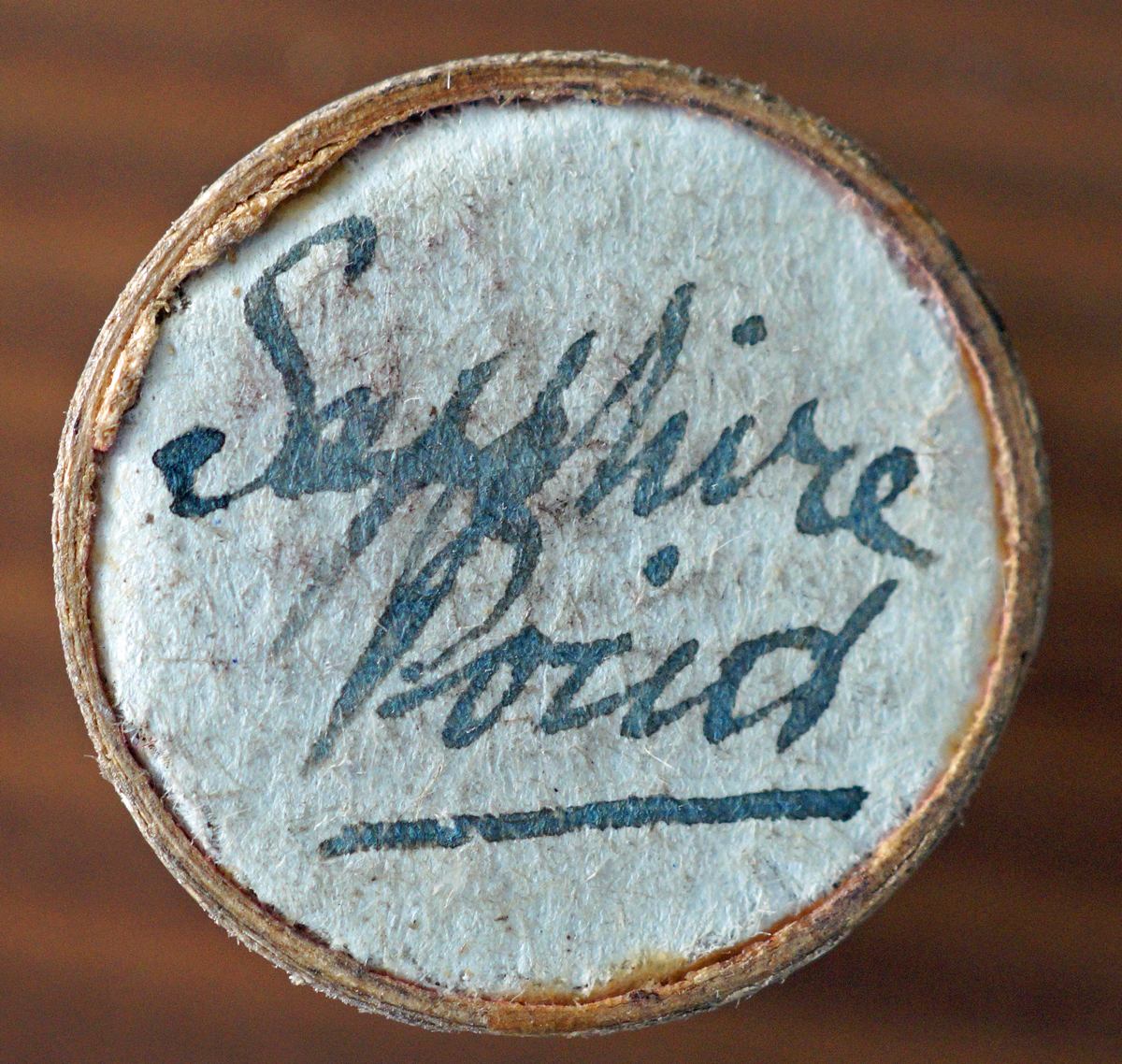

In light of the label "sapphire point," I'm wondering: Did the records have the same sort of "sapphire ball" type groove as Pathé discs? I'd always thought Pathé originated that geometry, but if Neophone used it first, I guess Pathé simply would have popularized it.
Posts: 5822
Re: Neolite / Neophone Sound-Box
drh wrote: Mon Feb 23, 2026 11:35 am In light of the label "sapphire point," I'm wondering: Did the records have the same sort of "sapphire ball" type groove as Pathé discs? I'd always thought Pathé originated that geometry, but if Neophone used it first, I guess Pathé simply would have popularized it.
They certainly used a sapphire, but whether it was a ball sapphire I cannot say. I have never seen a Neophone one.

Whether Pathé or other company started the production of flat records with sapphire balls playing vertical grooves, the concept was already being applied in the phonographs before the flat discs were created, all playing vertical grooves with sapphire balls.

Perhaps the sapphire point is still present with the accessories? If so maybe poodling could photograph it or describe it. Potentially a rare glimpse at the geometry of Neophone records.

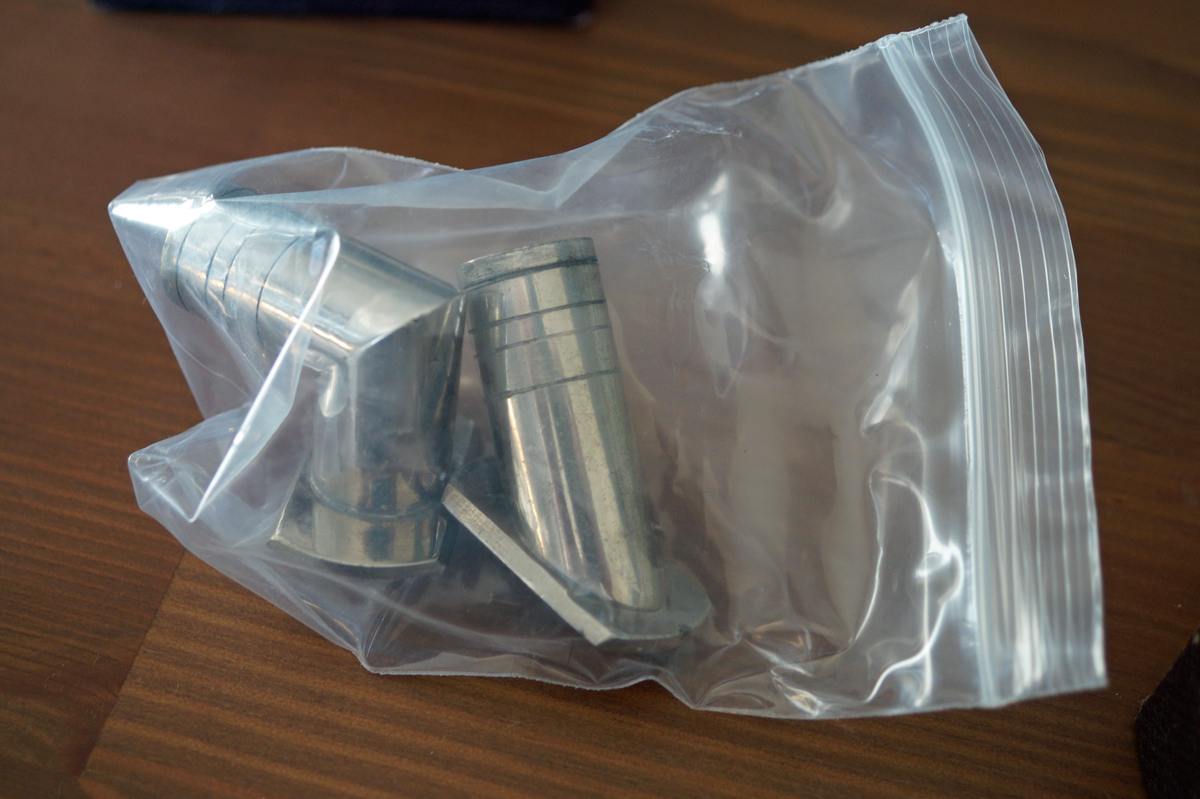

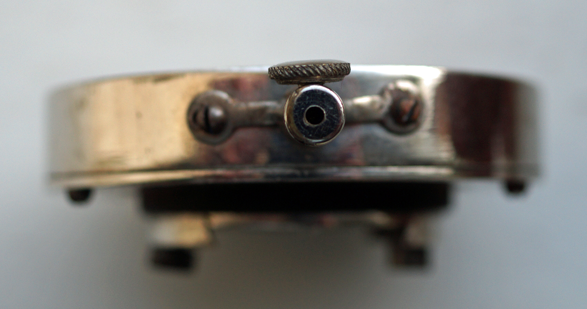

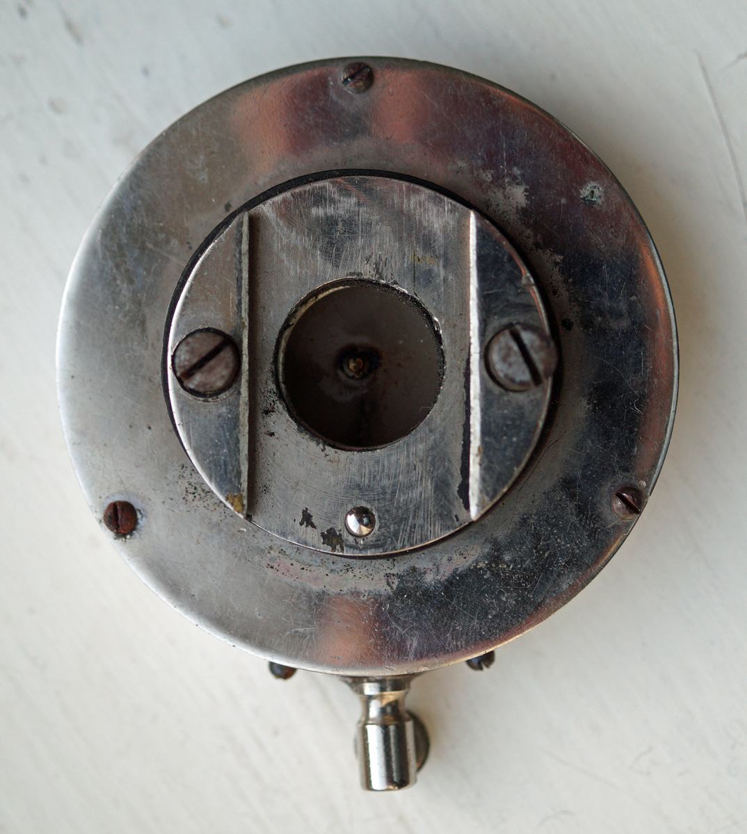

poodling around
Posts: 2497
jamiegramo wrote: Tue Feb 24, 2026 11:25 am Perhaps the sapphire point is still present with the accessories? If so maybe poodling could photograph it or describe it. Potentially a rare glimpse at the geometry of Neophone records.
I wish I could help, but the 'sapphire point' container end cap (as shown 'above') is all I have. I suppose it does show that they were still called a 'point' ...........
Maybe in the future ? I wouldn't bet my socks on it but who knows .....
It is little consolation but I attach 3 more photographs 'below' showing the 'chuck' (being round). the sound-box reverse side and how the sound-box would have been displayed in the box originally (the red, plush material was previously up-side down and hidden from me previously.
