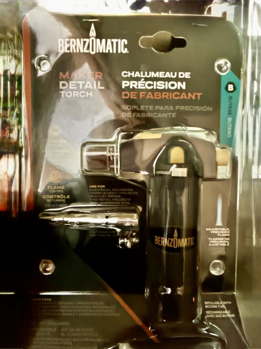

Ok I bought a torch. I hope this is the correct one…Dave D wrote: Mon Apr 20, 2026 5:39 pm Many people use vise grips on the mandrel shaft where the pulley will hide any damage. Just be very careful that you don't bend the mandrel shaft or you will never get an even sound out of this.
You can get a mini torch at Harbor Freight which will produce a small flame to accomplish what Jerry Van suggested. A heat gun will be too broad with the heat. You want it very localized. Heat it until you see the oil turn to liquid again.
Dave D
- Posts: 6942
Re: I like a good project. (First machine of 2026)
That should work. (If you don't like open flames, use it outdoors.)

I’ll try my soldering iron first just in case, but yep this is a outdoors job!JerryVan wrote: Tue Apr 21, 2026 1:42 pm That should work. (If you don't like open flames, use it outdoors.)
