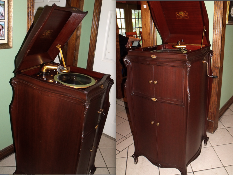

If you are going to just own one I would buy a Victor victrola. You'll always be able to get parts and most likely you won't ever need them because the parts on most models are well made. (other than some pot metal in the final years of Victor) If you don't get in a hurry you can find a nice gold plated XVI for under $400 and as low as $200 and it will look grand and expensive compared to the off-brand models. Columbias are nice too and Edison's are well made but most of them only play edison records. Hold out for a Victor 16 or 17 or 8-30 model. It's like comparing Yugos to Mercedes.
To give you an idea, and this is the exception but great machines at good prices are out there. I bought this machine 2 months ago for $200. This a a victor XVII and would run $500-$700 at a phonograph show. And a XVI is the same size and gold plated but the sides are flat and they can be found all the time for under $400. Compare it to some of the off brand machines you've found and you'll see it would be worth the wait. I bet there is a collector near your home that reads this forum that would sell a 11, 14 or 16 at a nice price.
Gorgeous! I would certainly pay $200 for that. Is there an organization or group for SC to get some information on someone looking to sell? I am not going to try CL-too much crap and shady sellers, especially around our area.
