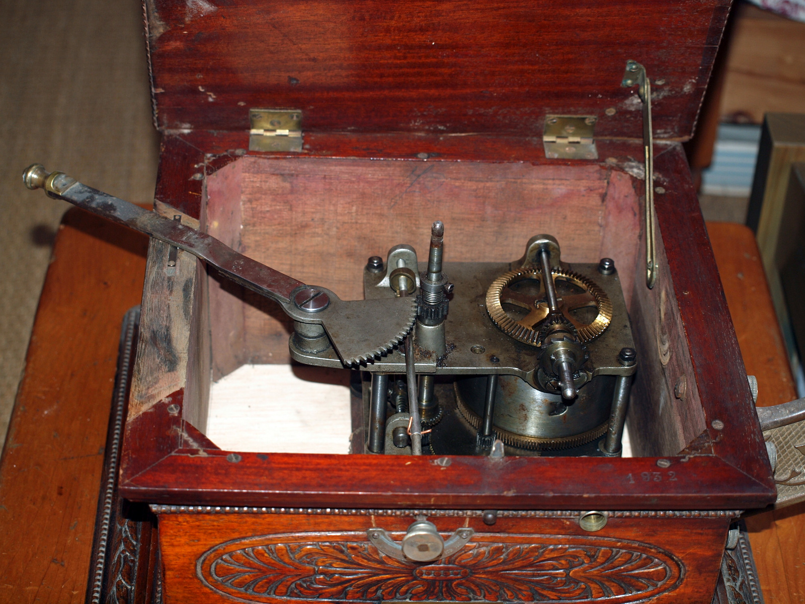

You also remarked, "...with the possible exception of the later cheaper 'Diamond' range which have smaller pillar and plate motors...." You can safely delete the word "possible"; my Pathé/Diamond Diffusor (my profile picture machine) barely plays one of the 11.25" disks on a winding, and not all of those. Given that I have a low-end Pathé cylinder machine with a similar problem, I've been rather fixated on Pathé motors, determined that when I do finally latch onto an open horn Pathé disc machine, it will play all my records without such issues. I've been especially concerned that they all seem to be single-spring--hard to tell from an eBay listing or what have you whether it's single-spring like Edison diamond disc single-spring, powerful enough to handle whatever is thrown its way, or single-spring like the motor in a Victrola I-I that once graced my home, barely strong enough to handle a single routine record on a winding.

The single springs on the older Pathé's are quite sturdy, not unlike the Edison motors. The concert A motor in particular is very powerful, designed to play the very heavy 50 cm records at around 90-100 rpm. Indeed the price of the one in the ebay ad is attractive, too bad I have one already or I would be tempted to make a day trip to Paris.

CarlosV: I will not open the barrel of my Pathé Concert A as it could be dangerous… However, I’m sure it’s a large single spring motor and it does play 20’’ records without any issue.

Yes, it is a very large, strong and dangeours single spring. I keep a spare spring in case it is needed, but after buying it I got second thoughts about undertaking the replacement work myself. Once I replaced both springs of my Edison Opera, and it was a quite daunting task.
