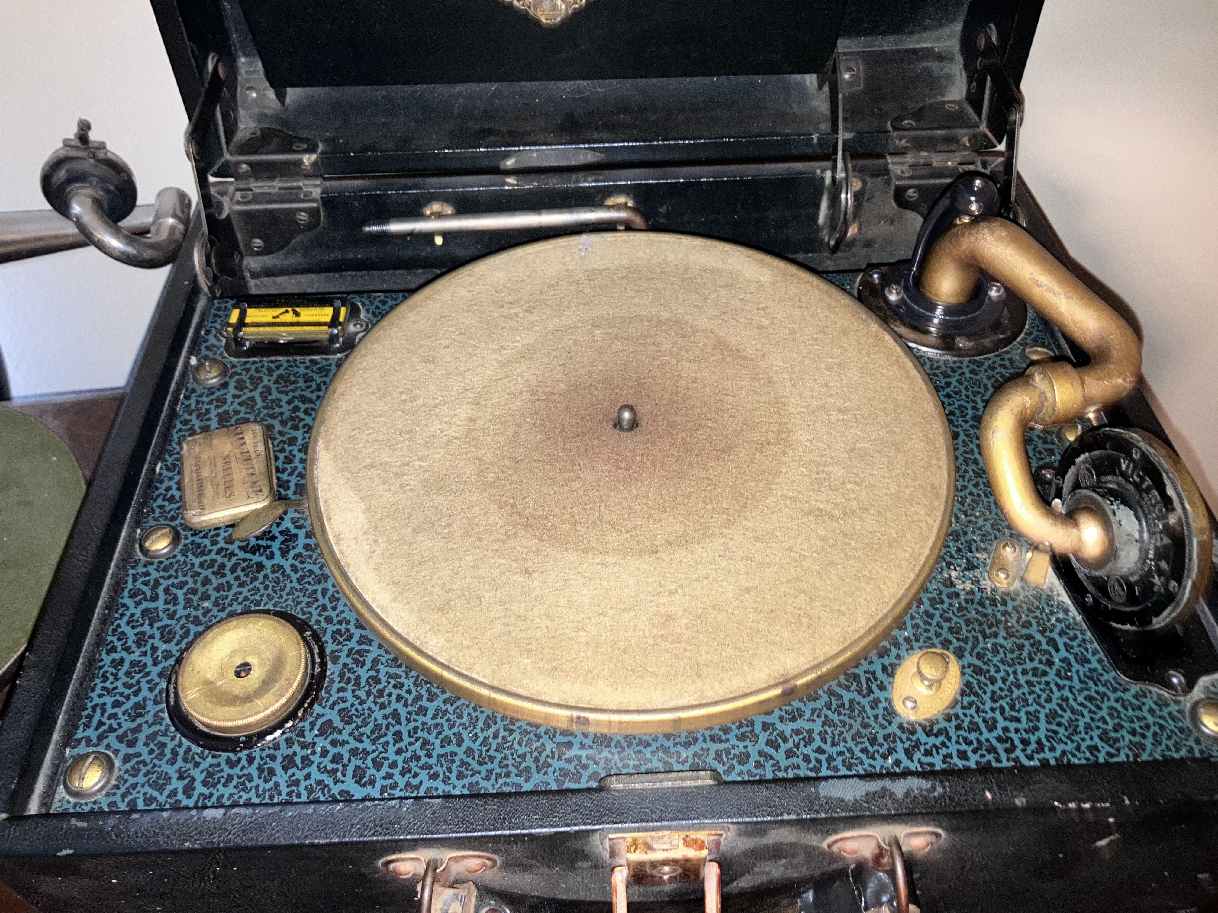

Andy,
The second photo that you posted of your pin shows that it's a home made version. Notice how the pointed end of the other one pictured is nice and smooth, while yours looks kind of rough & crude? That being the case, yours may be just a tad too large to fit the hole. Inspect it carefully for any small burrs, due to the crudeness of its manufacture, and sand them down. It may work then.

Well that explains a lot! I heard Ron Sitko makes new tonearm brackets for this model. Does it include the pin?JerryVan wrote:Andy,
- Posts: 6942
Re: Vv 2-60 question.
I am surprised to read that. But, I believe that if in fact he does make them, it would include the pin.AmberolaAndy wrote:Well that explains a lot! I heard Ron Sitko makes new tonearm brackets for this model. Does it include the pin?JerryVan wrote:Andy,

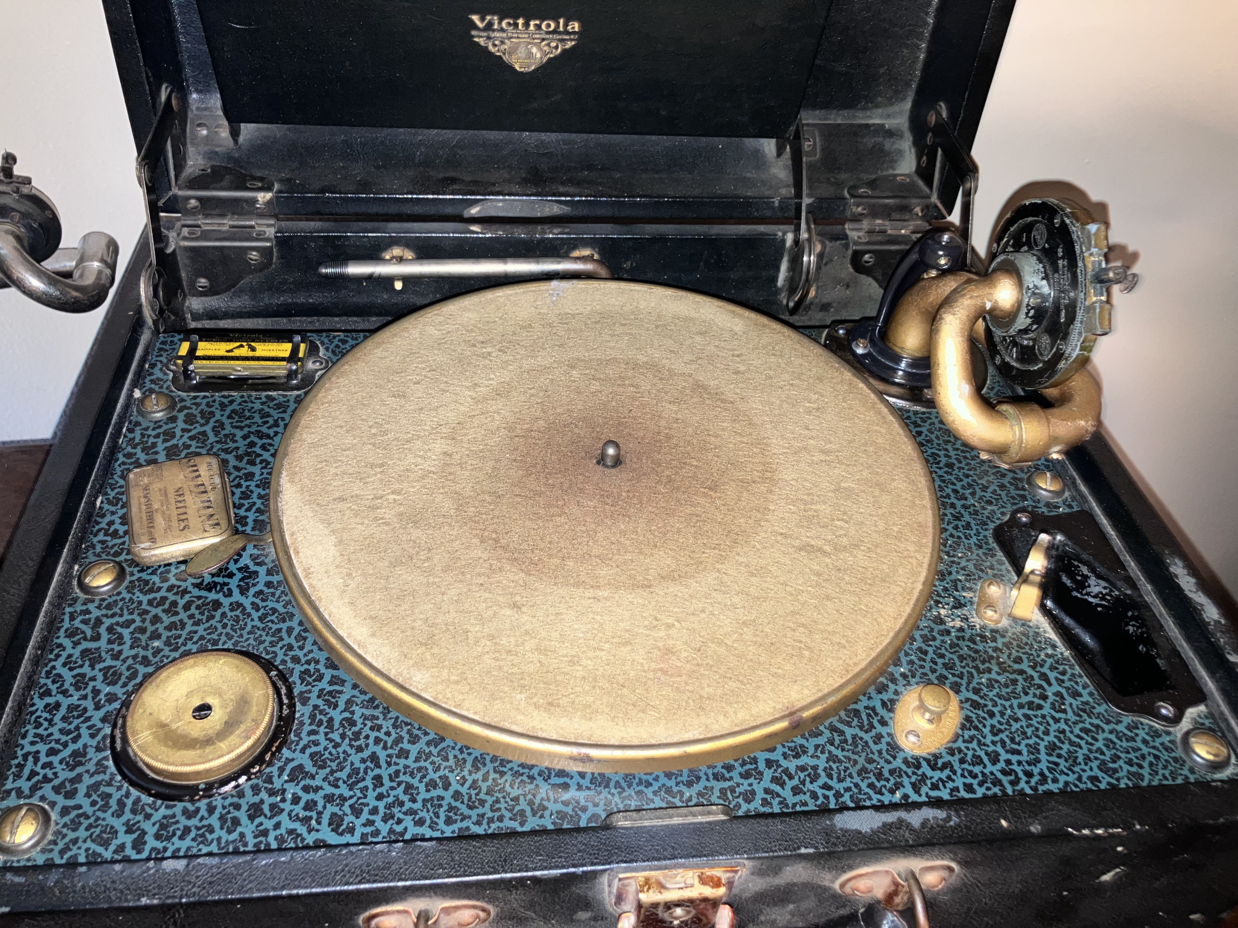

FINALLY!! After SEVEN YEARS I found a Ebay seller that is making VV-2-60 and VV 2-55 tonearm back brackets!!!! And I have ordered both!!! I am so excited!!!

And here we are! All put together!
I've waited since 2018 to do this!!!!
