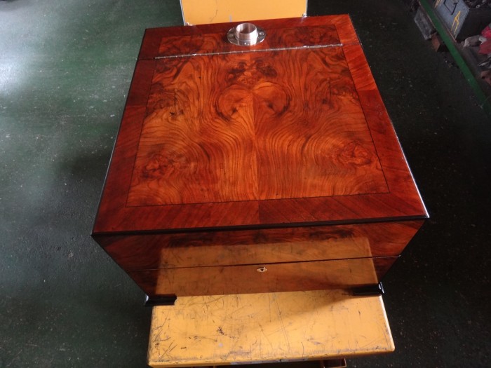

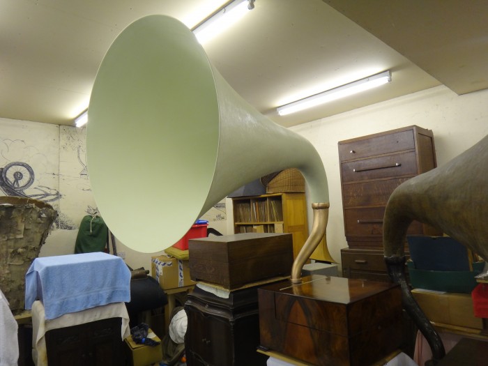

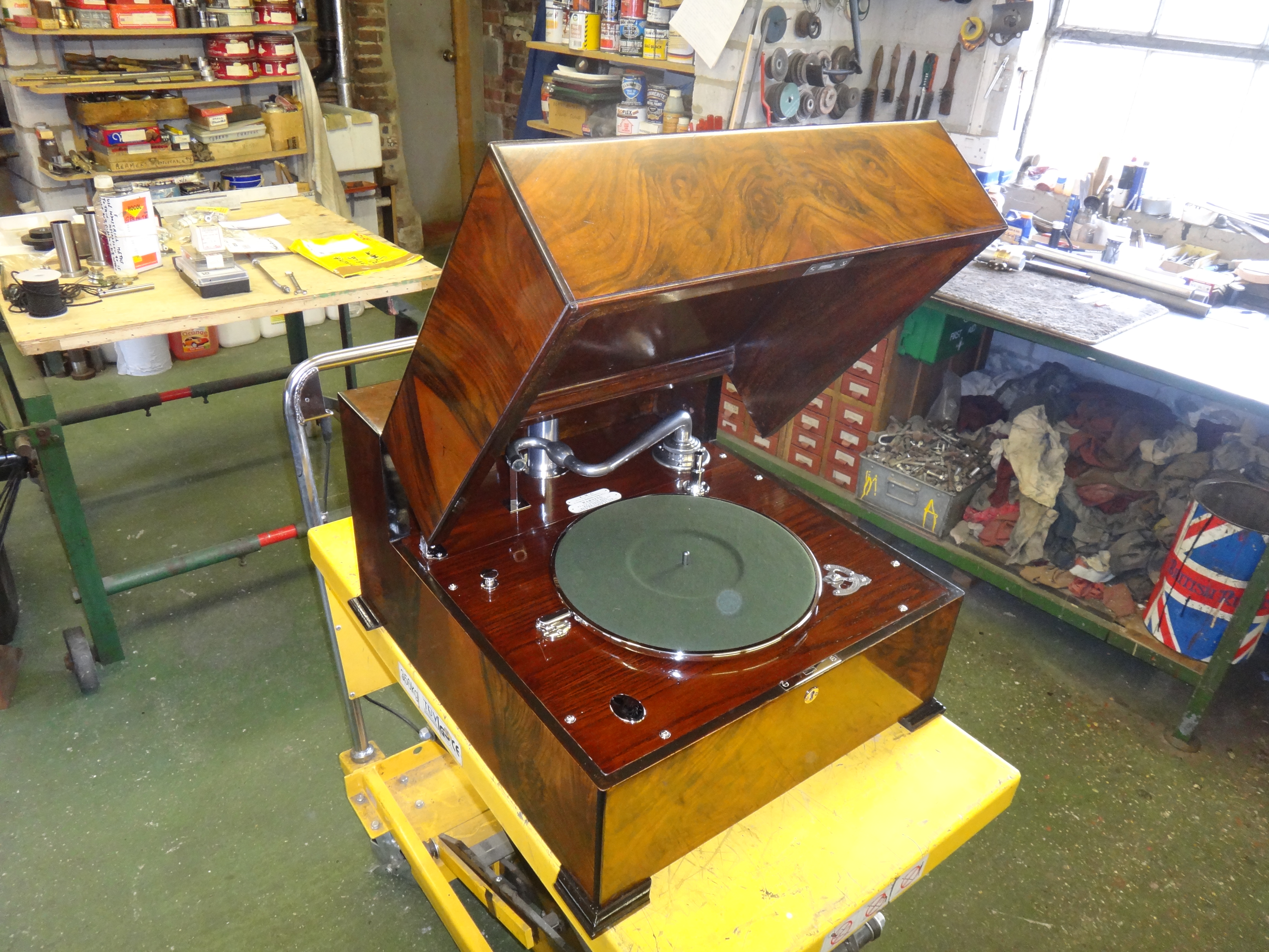

Well, Strobedisc kindly agreed to sell the empty wooden case to me and here, some two and a half years later, is the situation following a full restoration and return to original specification---and what it sounds like with new EMG Xb Oversize horn with GRP (fibreglass) bell.

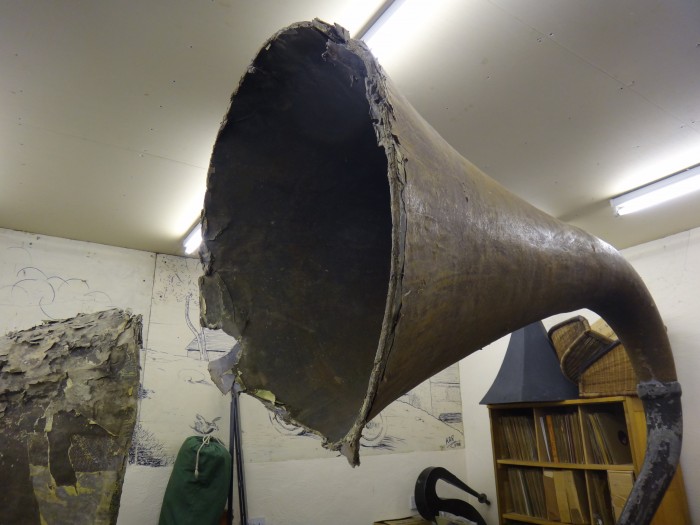

The initial part of the horn casting is an original aluminium item sourced from an itinerant derelict and damaged standard Xb horn (final bell diameter 29 ½") found in France a few years ago. The opportunity has been taken to upgrade to the larger Xb Oversize specification (final bell diameter 33 ½") much as might have been done during the nineteen-thirties. Light green pigmentation has been added to the fibreglass. The spring motor is a Paillard GGR 255 (also found in France) which, ascertained from the winding hole geometry, was what it was originally supplied with. The internal conduit is new but tonearm and soundbox are original EMG equipment.

The residual paper from the original horn bell will be used to restore other damaged extant horns as they appear.

John, this instrument is completely devoid of any electrical operation and the Paillard motor is a spring-driven (wind-up) item---such was the exact specification when new in the nineteen-thirties---a totally acoustic, mechanically-driven, gramophone. Many owners did indeed convert to electric motors during the nineteen-thirties as electric power was introduced into homes thus a restoration to either type could reasonably be thought of as appropriate. However, after many years of trying to decide which is preferable, I find I now come down on the side of the wind-up power source as being both reliable and cathartic---effort in, to obtain benefit out ! Additionally, power cuts are now irrelevant ! The party goes on unchallenged........................!jboger wrote: Mon Sep 20, 2021 4:30 pm Interesting machine with an interesting history. May I comment on the case? It's simple lines, the sorta French feet, and how the veneers are used all remind me of Hepplewhite/Sheraton furniture. Bothe Hepplewhite and Sheraton reacted to the Baroque Chippendale by simplifying the lines and relying on beautiful veneers.

I am afraid the horns are not readily available, primarily due to the worldwide demand being so small. I also took the decision many years ago only to reconstruct complete gramophones. The original project was to make twelve instruments, all of which have now found new homes except one. This example is one of two further items which have come about as a result of subsequent discoveries producing two further castings. Thus there are now fourteen in all. I still have all the patterns, formers and jigs, of course, but for any more to be made I should need firm orders for at least a further dozen due to the immense amount of work involved. Sadly, I cannot see such a situation arising.
