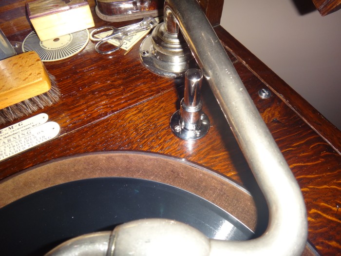

This feature is commonly found on German pressings, notably Odeon. If the soundbox is not lifted before it reaches the abrupt run out groove, it can sometimes be hurled across the label with adverse consequences to both label and soundbox.
Onlineemgcr
- Posts: 1187
Re: The HMV Archive Series
Perhaps fit a spring-loaded tonearm stop ? These are very easy to use and have saved many of my soundbox diaphragms from destruction, particularly when playing early discs with poor or non-existent run-out grooves, although many later recordings can also prove problematic in an unexpected way. I have one or two left.

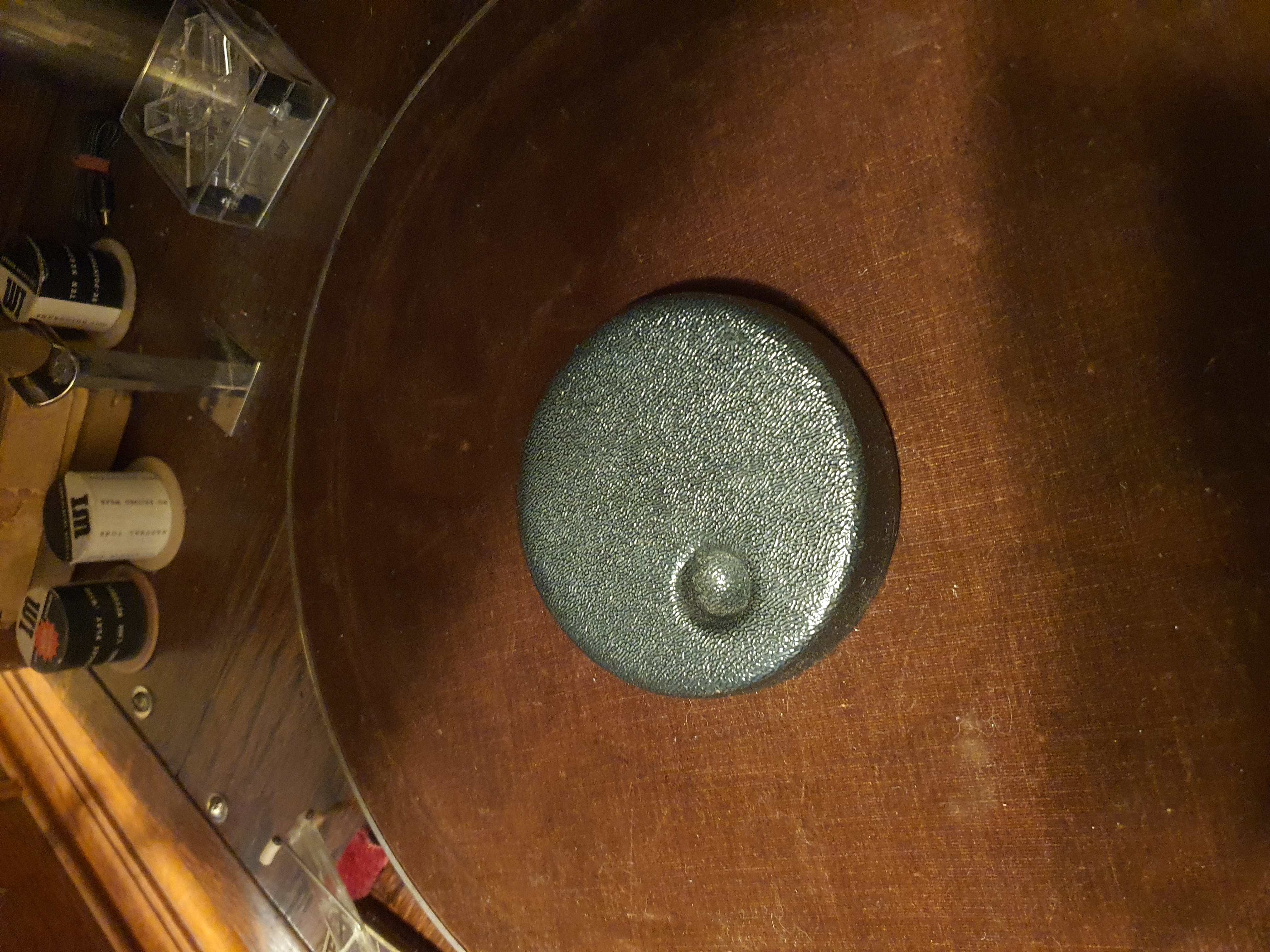

I had that experience with the killer groove a couple of times. Now I play these records with a cap on the label. I utilize one originally made for a cleaning machine - see photo - but record weights for LPs can also be used. It acts as a barrier to prevent the soundbox from flying away.epigramophone wrote: Thu May 15, 2025 1:39 pm [If the soundbox is not lifted before it reaches the abrupt run out groove, it can sometimes be hurled across the label with adverse consequences to both label and soundbox.
