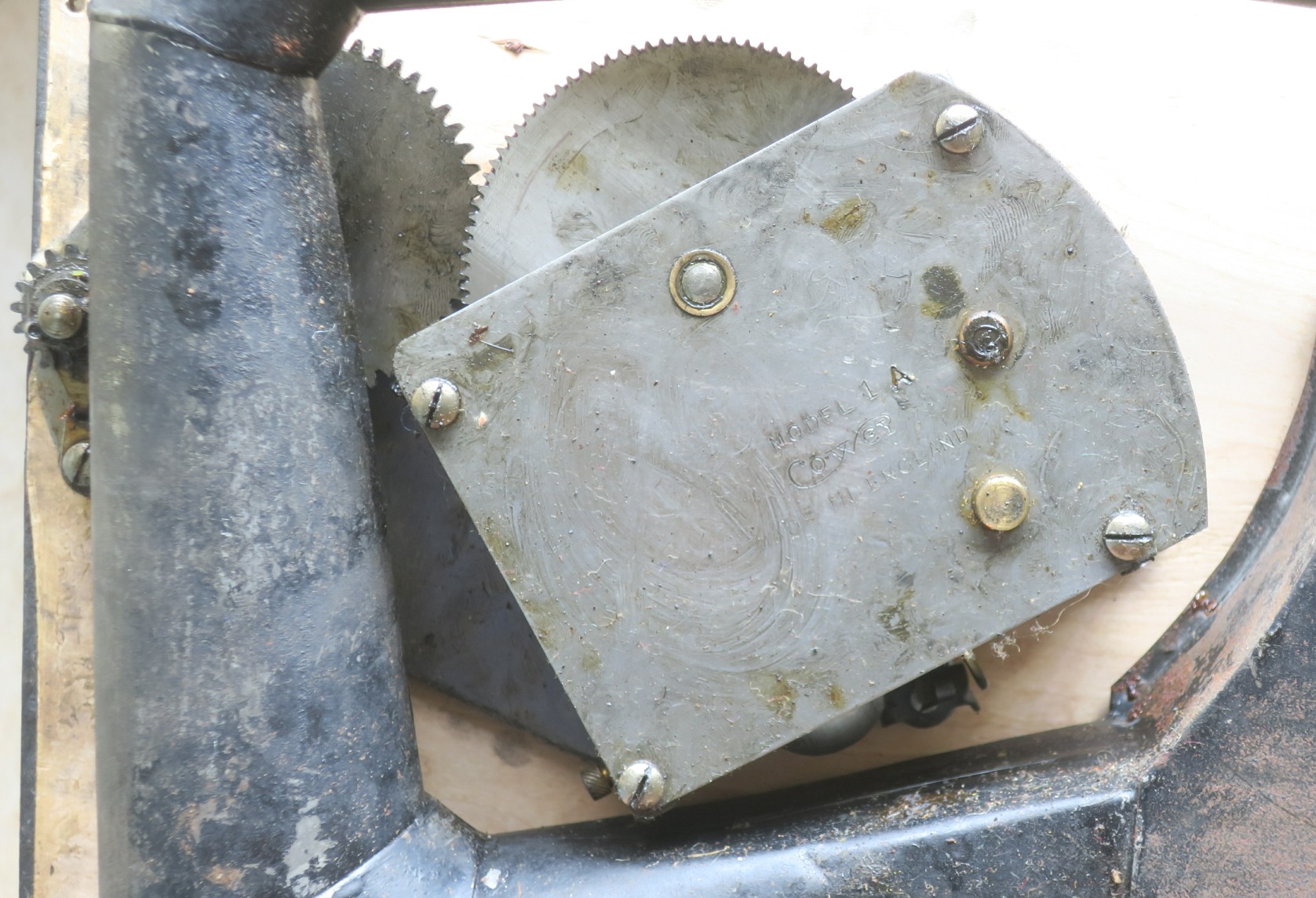

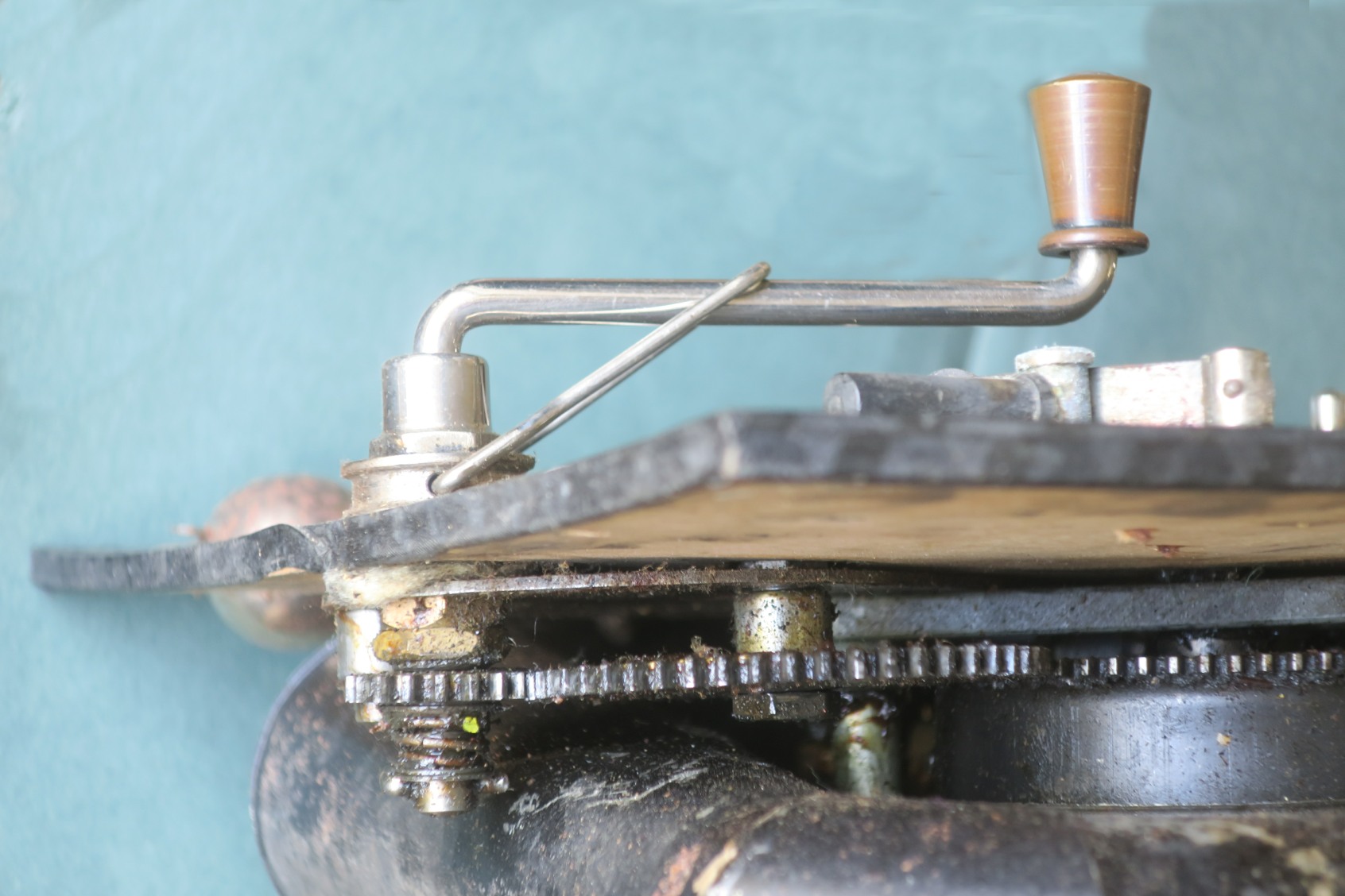

The No 1 portable has a 1A motor, wound from the top but through gears rather than chain. Mine is black, (dated 23.12.30) and looks the same as the No. 3 in all other respects, except that the winder and speed control have swapped places, perhaps indicating a different motor.
I am attaching two photos of it to show the winding arrangement (what does that wire loop do? I've no idea) and also a scan of a 1931 Handicrafts catalogue showing the Cowey No 1 and No. 1A motors. The No 1 was still shown in the1932 catalogue, but in 1933, it and all other brands except Garrard had been removed. Both the Cowey motors on general sale had conventional side winding.

Very interesting indeed ! Thanks for such great information.Oedipus wrote: Sun Nov 19, 2023 7:25 am I wrote about the Cowey Multigram in For the Record No 28 (Winter 2008, page 220). From the illustration there, it can be seen that the chain and sprocket arrangement related to the six-spring motor, which consisted of a standard 2-springer with an extra four springs added below.
The 'wire loop' seems to keep the winding handle in a particular position to allow the lid to be closed safely. It is moved away during winding. I have a red No. 1 and that is what it seems to do. (I have seen photographs of the black version and think it is a stunning colour / design !).
Interesting to see the gears and that there is no chain. It is a very smooth system.

Interesting; the wire loop on mine is free to revolve with the winder, which is why I couldn't see its purpose.
