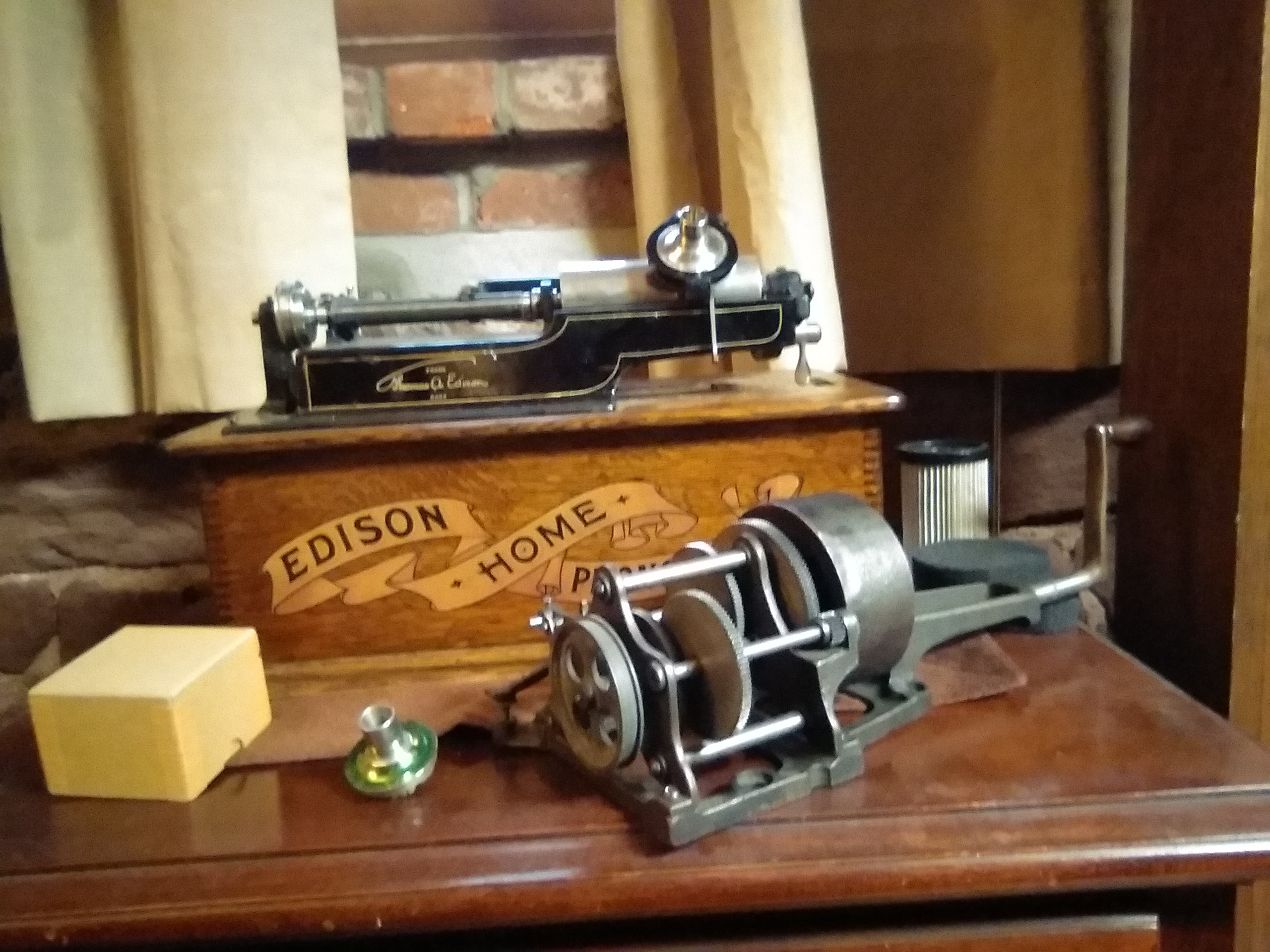

VanEpsFan1914
Posts: 3384
Location: South Carolina
Re: Home Model B follow-the-restoration.
Post by VanEpsFan1914 »
Sorry for the blurry cell phone picture.
There is still a Tupperware full of parts in the desk that need to go back on this phonograph, so I will have to see what I can do. It's an interesting mess. But having a spring helps, and having both the C and the H reproducers helps as well!
It is going to be very rewarding when this crazy thing finally fires up & plays, considering I dragged it home as a pile of restoration bones in October 2020. This is the 13th month of this project and it's followed me from South Carolina to Connecticut without being anything like a functioning record player. Hopefully I can get it ready to go shortly--but I've been saying that for how long now?
The vacuum cleaner parts in the back are not affiliated with the Home restoration in any way. An advisor at the college had a friend with a broken vacuum cleaner and I had to fix it. That took all of 5 minutes. The new model vacuums had some unusual locations for the filters, and it had clogged up & started overheating--easiest fix in the world but not the most intuitive.
