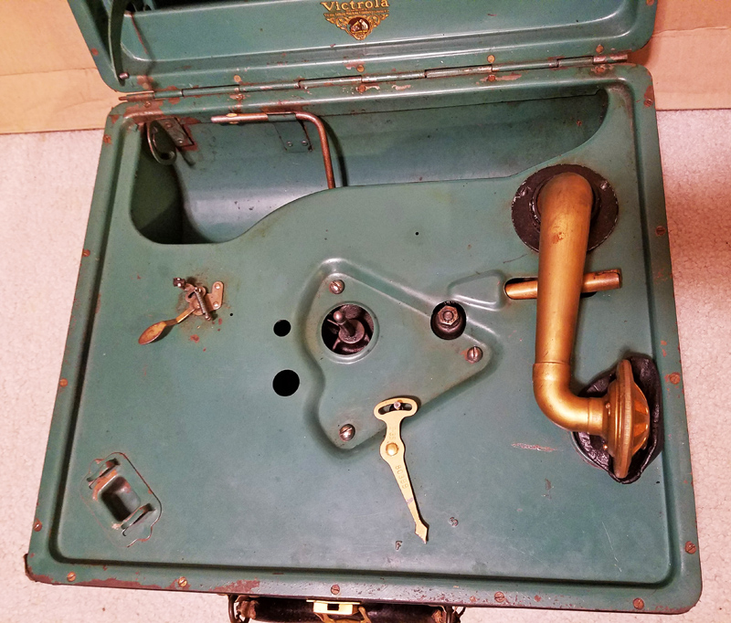

I picked up a Victor VV2-35 last year and now that I'm getting around to checking it out I had to see what's been written about them here. I enjoyed seeing the example that dischoard found and noticed the serial number on his is on a plate fastened to the motor board. Mine doesn't have that plate, but has 'VV2-35 80399' stamped on the speed control arm. The Victor-Victrola site says that the latest serial number in their database is 54819 but that this does not include models marked as "RCA" products. Is mine an RCA product? I don't see RCA on it anywhere and it has the Victor Talking Machine decal on it.

I have two VV 2-55 machines and one has a stamped plate and the other has it on the speed control as well, must be just a change in practice along the production run.

The reproducer on mine sounds great at low and average volume but not as good during loud music passages. I'm not sure how to describe the sound, I don't hear any rattles or anything indicating the reproducer is failing, but it just seems like it is overloaded if the music is too loud. The sound isn't as clear as at lower volumes. My VV2-55 is definitely better. I was debating if I should sell this VV2-35 but since posting it here about a week ago I contacted Paul at the Victor-Victrola website and he confirmed that it all looks correct, and of over 1600 VV2-35's in his database, this one has the highest serial number (80399) reported so far. This makes it more interesting, and since it plays fine and is all correct, I'll be hanging onto it.
