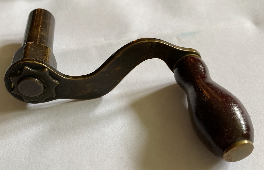

I had one of those "transitional" Zonos and if I remember correctly, the crank was an "S" shaped "drop off" crank...
Curt A
Posts: 6823
Re: Zonophone phonograph
Post by Curt A »
I handmade this crank from flat brass stock for my Symphonion music box, using a pattern made from my Zonophone crank. I don't know which style is appropriate for your particular Zono, but this style was original to mine...
