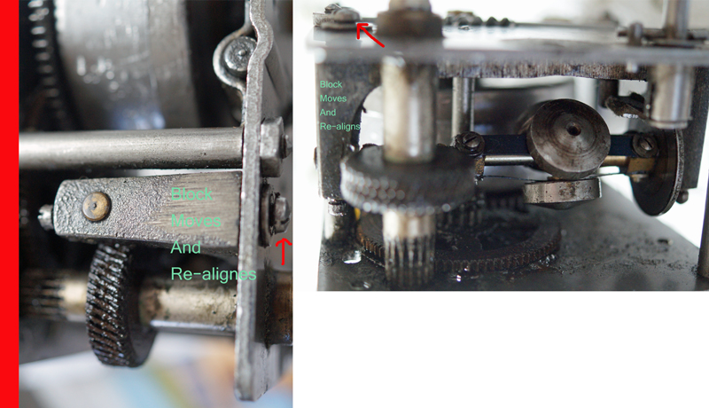

Interestingly, when I cleaned that area a little, there is no ball bearing !
Anyway, it is now fully mended ! The washers etc kept on.
The answer was that there is a screw which can adjust the position of the 'Block' which holds the governor and align everything. I hope the photographs below show what I mean.
It's a miracle !!!!!!!!!!!!!!!!!! I am so very pleased ! :)

Wonderful! That adjusting system I didn't know! One never stops learning, thanks!

Well, there was a raised part between the two sets of washers which I was unsure how it could be removed. But, assumed it could be prised off.
I will see if it continues to work smoothly and if there are any problems I will try to remove the middle bit and washers.
Therefore, I may return ..........................................................................
Posts: 4682
Re: Motor repair advice please
If it has been working assembled that way, the intermediate raised portion could be dry grease cake... If you apply some gasoline to clean it, you will see what it is. The lost ball might be into the cake, be careful!
