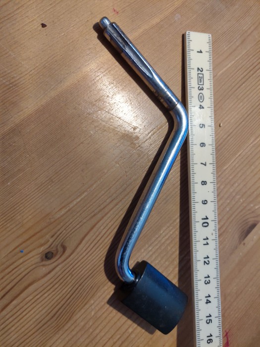

I wish you all luck in restoring your Columbia 114 portable. Here are the photos of the winding handle, I hope they can be of use.

Thank you! Is that basically the same crank as an HMV 102?

The Columbia winding handle is thinner, it does not fit a HMV 102, to assure..I just tested, since I am today finishing servicing a 102.
I do not have the equipment at hand to show the diameter of the winding handle, but if someone else is not doing it before me, I will be able to measure it in a day or two, when I visit my repair room.
In all honesty, I have not yet serviced a Japan made Columbia, it is on my long list of machines to service, so I can't really tell right here and now what motor(s) are found in these portables, without checking inside one of them. The only one I have at home is the 114, the rest is in my storage locker.

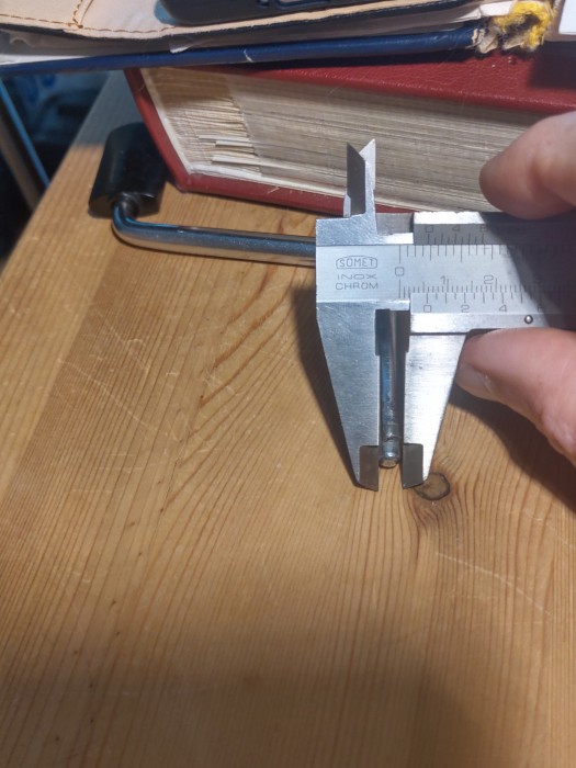

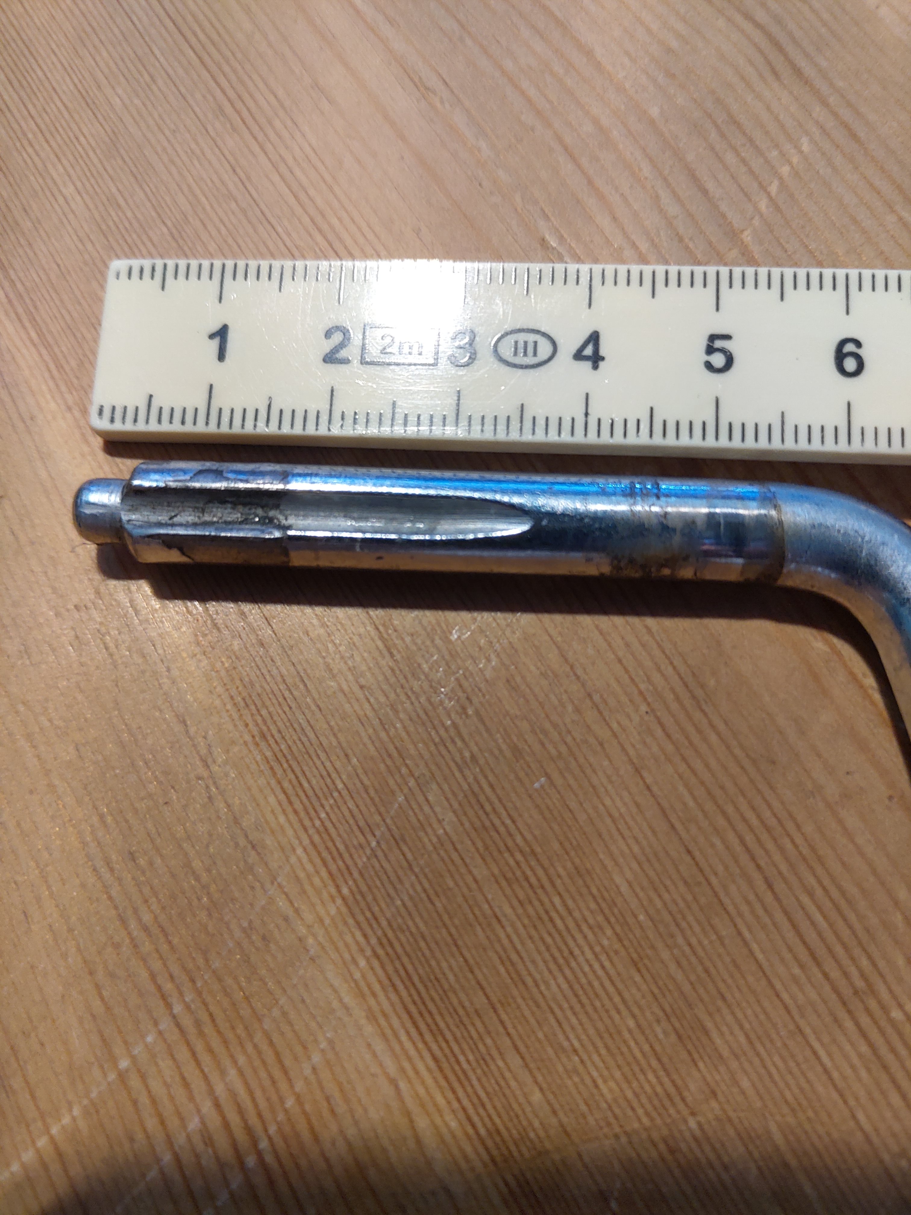

Is there only one groove in the crank? If so, it should be relatively easy for me to eventually make one if I cannot find one!
nostalgia
Posts: 1440
Re: Columbia model 214 portable
Post by nostalgia »
No, it has three grooves, like the 102 handle.

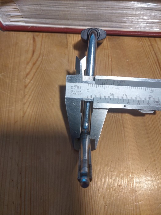

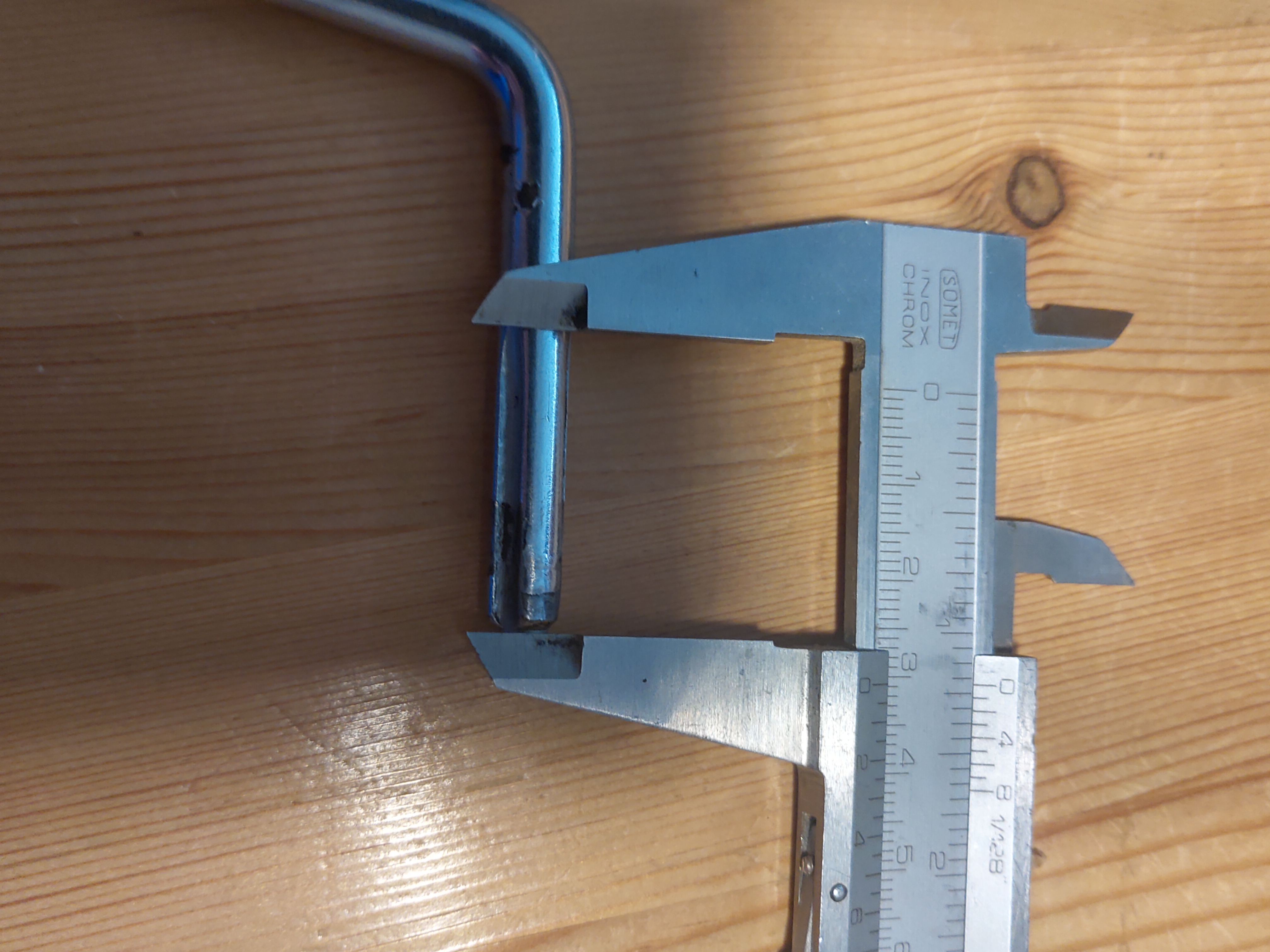

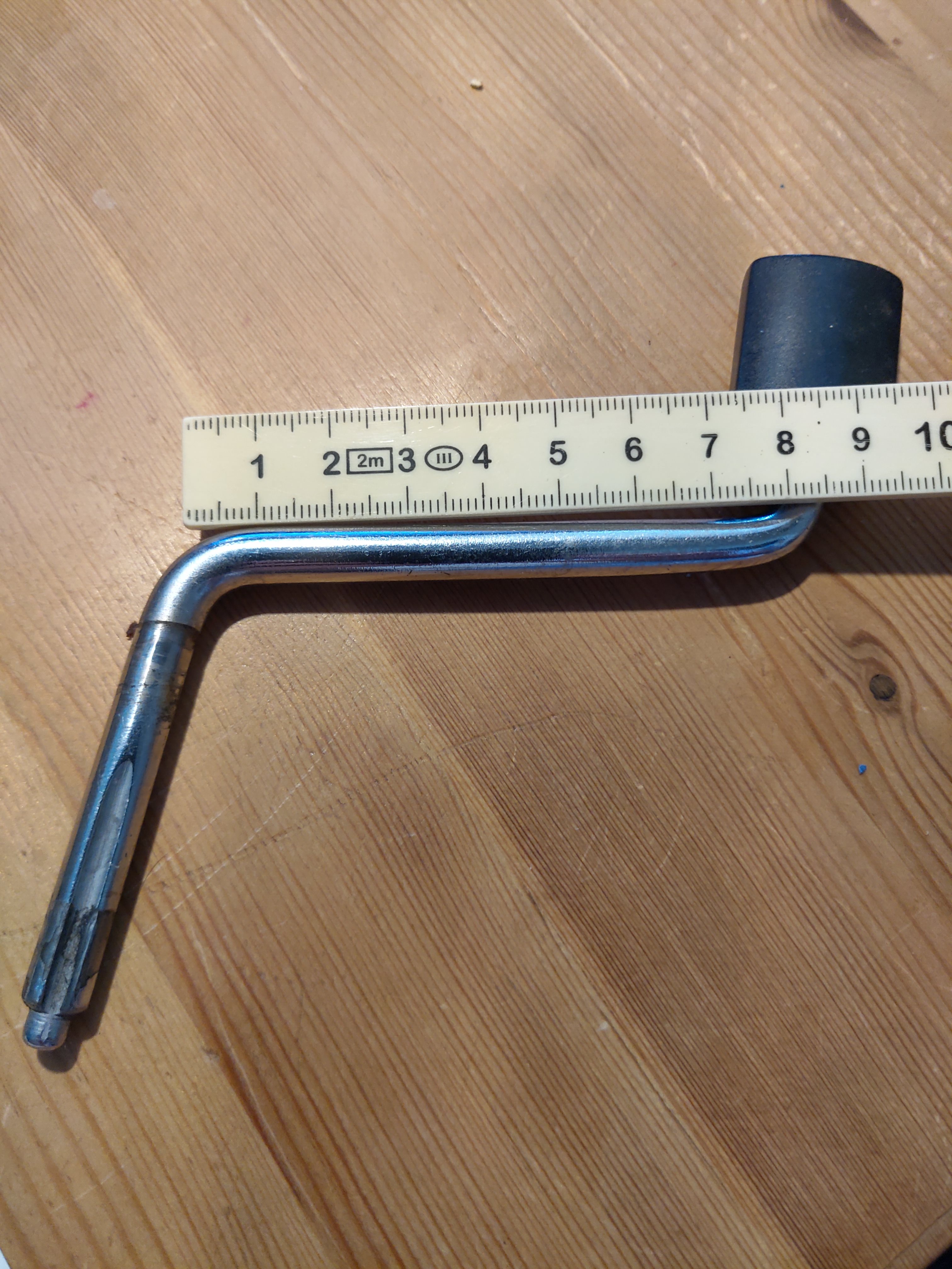

Thanks! if you get the chance to measure accurately the outside diameter, and the width and depth and length of the grooves, I would appreciate it! it looks like a good motor, and I hate to see mine sit idle for lack of a crank! I can probably find a way to fake it, but having the proper measurements would make it much easier to source or make one.

Here are the measurements. The depth of the grooves are the difference between the measures of the outer and inner part of the shaft (3 mm).
Good luck !
