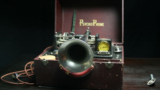

What it isn't: It is NOT a Psychophone. A Psychophone is a phonograph/quack medical device that played Psycho records when you sleep.

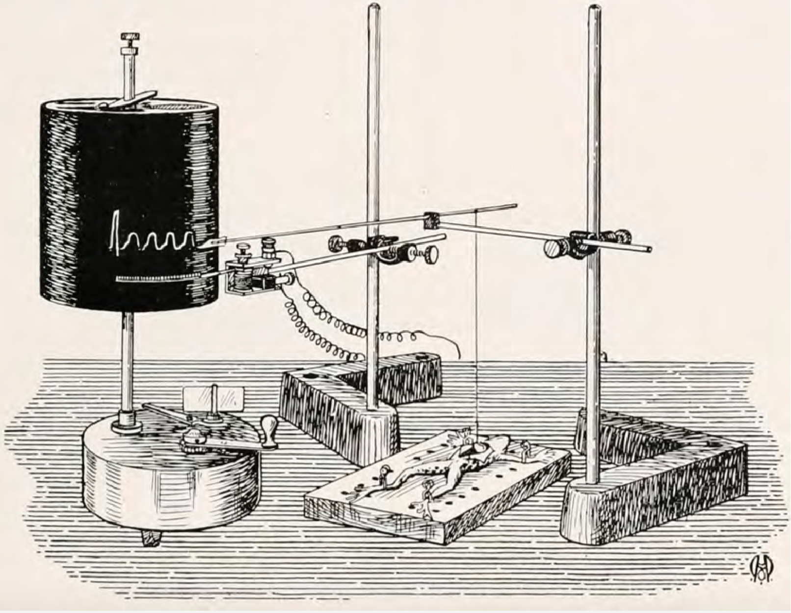

Your device is also NOT related to phonograph cylinder recording. John C. Hoyer's "cylinder recording device" recorded scientific data on rotating "paper cylinders".
What it is: It is the base for a home made Kymograph, which records scientific data on vertical, rotating, paper cylinders - using a clockwork motor to spin the cylinders.

Not to get too off-topic or anything, but Tim Fabrizio was involved in a History Detectives episode aired on PBS many years ago and provided help on the topic of the Psycho-Phone. Although unfortunately, I can't locate a video on the great wide cyber-world, I did locate an excerpt.
I hope this helps to further clarify what the OP's device is not.
https://m.sdparanormal.com/page/page/265918.htm
