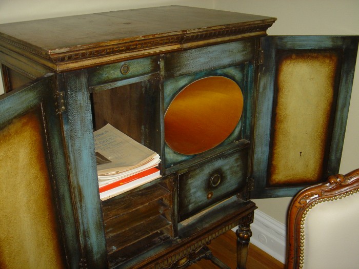

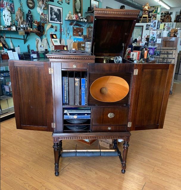

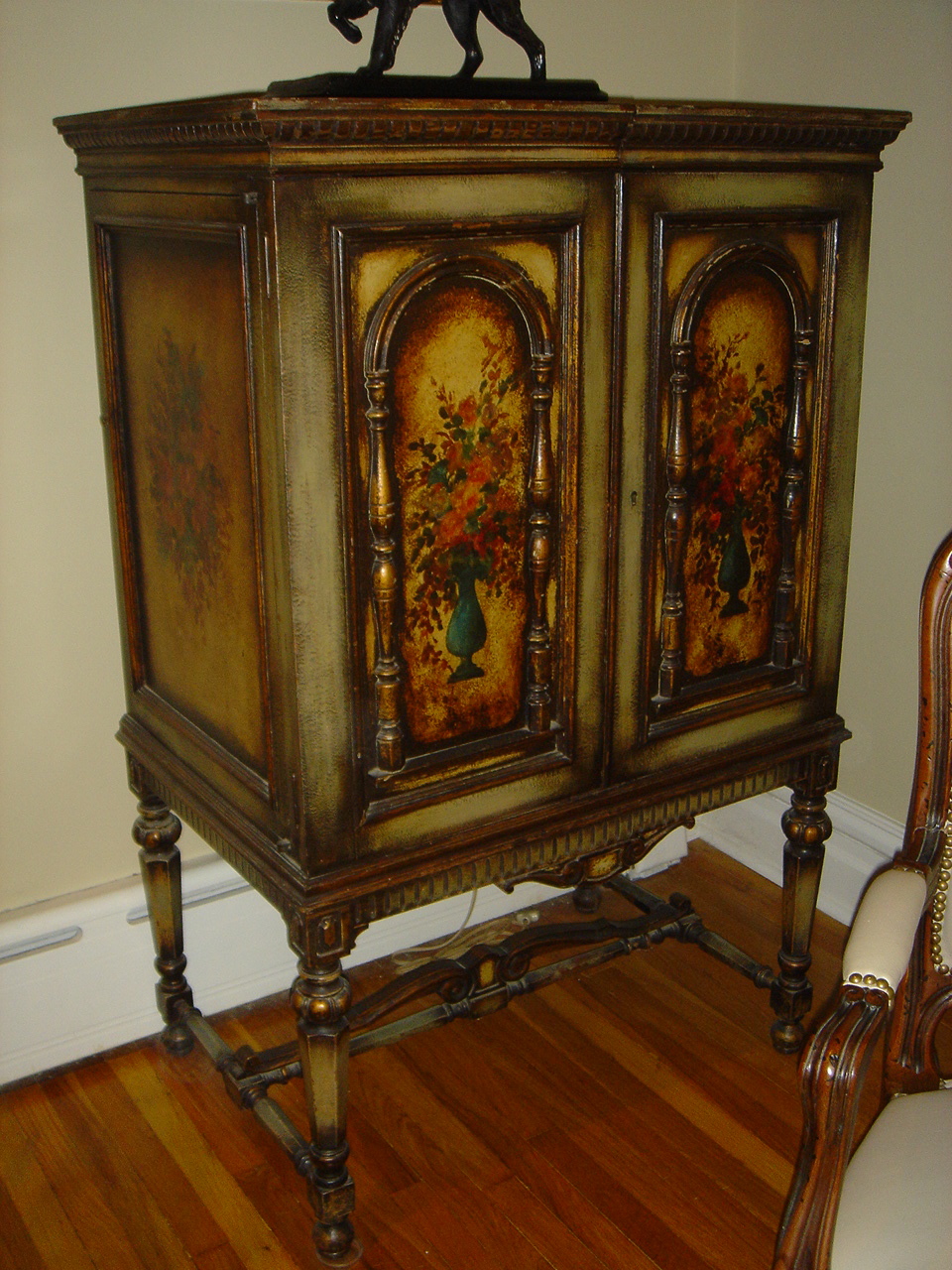

The hampton looks a whole lot like the two door acoustic Brunswick I had which had a place for a radio on the left side but none was ever put in this one. I wonder if its the same cabinet but with the updated horn?

larryh wrote: Sun Aug 15, 2021 11:01 pm The hampton looks a whole lot like the two door acoustic Brunswick I had which had a place for a radio on the left side but none was ever put in this one. I wonder if its the same cabinet but with the updated horn?
Hi Larry:
Is this the one you're thinking of?
See: https://www.ebay.com/itm/233189206438
It certainly looks the same. In relation to the cabinet, the horn looks tiny.

Yes that would be pretty close. I purchased one in Kansas City in College from and Antique Dealer who said it came from a large downtown hotel. The cabinet had been painted to suit the lobby. Naturally like everything else I managed to sell it and later on actually discovered a neighbor of mine whom is still a good friend purchased it from the antique dealer I sold it too. They still have it luckily. A few years ago I got a copy I made of the grill pattern and painted it to closely match what it might have been so no longer the open horn as seen here.
