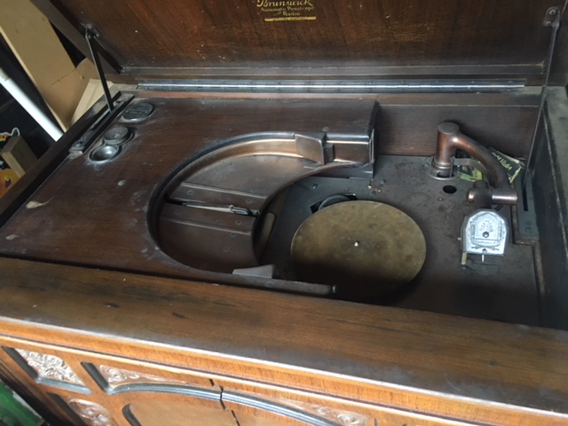

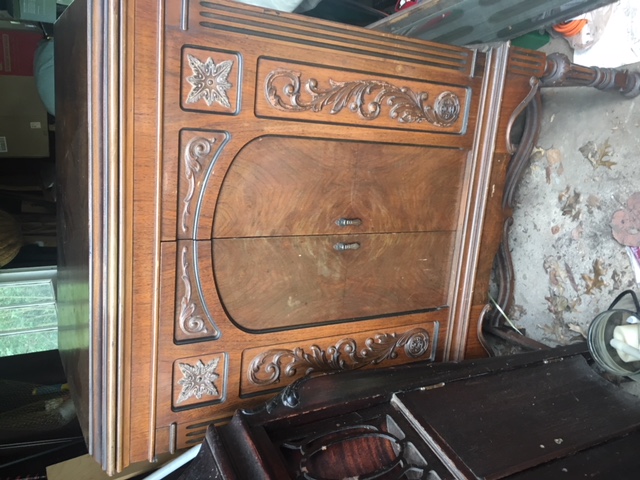

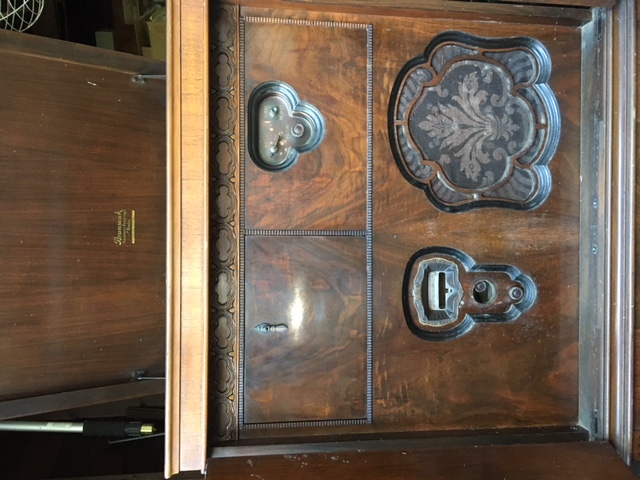

This is what I have. I haven’t done anything with it since it was given to me, but one of these days I will find room for it on the first floor of the house and put everything in working order.dzavracky wrote: Tue Sep 07, 2021 2:40 pm
Thank you! Now I need the Model 42 with the changer in it![]()
David
Bill
