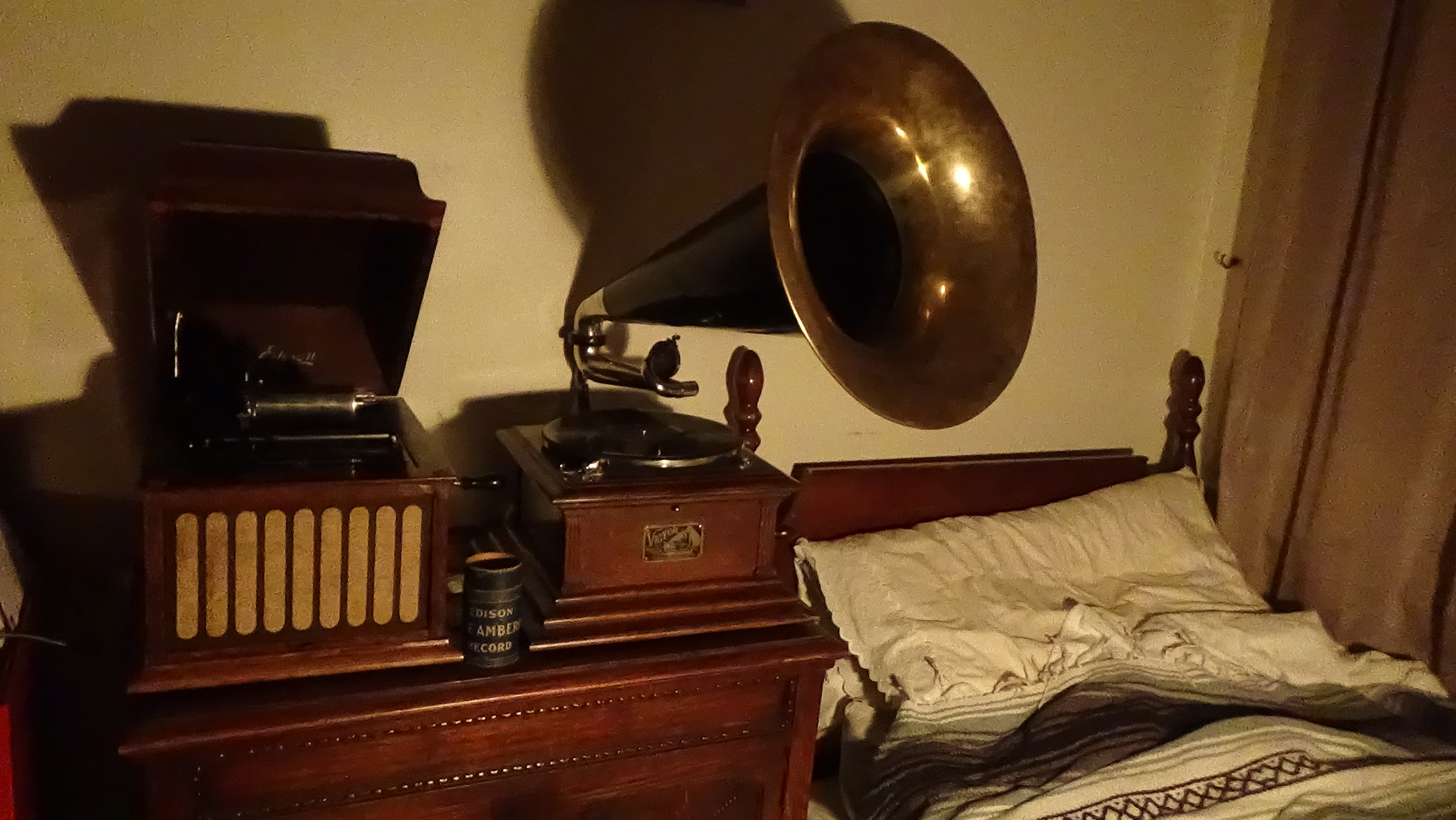

And don't worry about the bad case; the bottoms can be replaced. Here's my Amberola 30--after I got it, a few years ago. The bottom rotted so badly that the front molding fell off. It'd been in water in Florida and had been home to roaches.
And here it is after restoration; I did end up replacing side & back veneers. Of course this room at the family house has been reorganized a few times & the Victor is now in storage and fitted with a morning-glory horn (that I should repaint.) But even a rotted-out Amberola case can be redone with the right woodworking skills.
