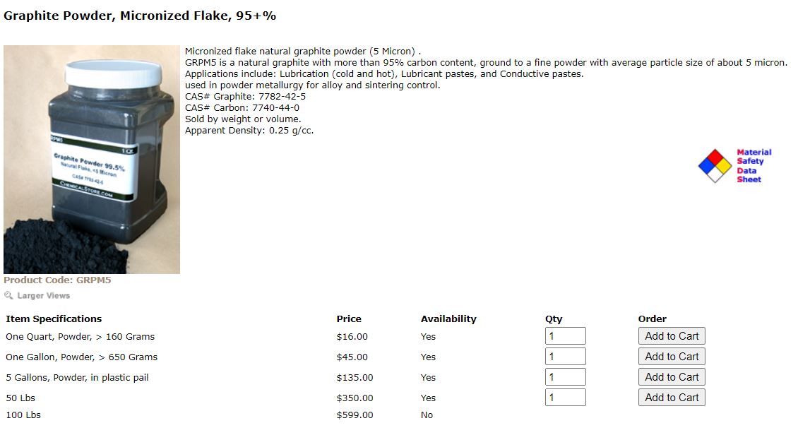

Tried using this combo of 2 to 1 and it's too thick, it winds up with some very mild thumping, but grabs occasionally when winding down, but doesn't do it all the time.
I'll try 3 to 1 next or even 4 to 1.
The grease is very similar to Vaseline, but is much more stable.
The graphite averages 5 to 7 microns, so quite small.
http://shop.chemicalstore.com/navigatio ... 4&id=GRPM5

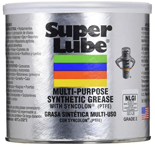

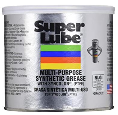

So far the most successful combination is the common Super Lube you find everywhere, see photo, a few drops of clear machine oil to thin it down just a little and 5 to 3% graphite that is at 5 microns.
This grease can be thinned down slightly and spread very thin, but still lubricate the coils while successfully preventing metal on metal contact under the tension of the spring.

The 5 micron graphite is still too big, it will eventually get squeezed out of the coils and "cake".

Super Lube also makes an O-ring grease that I'm going to play with as well.
Super Lube.JPG (35.09 KiB) Viewed 1458 times
