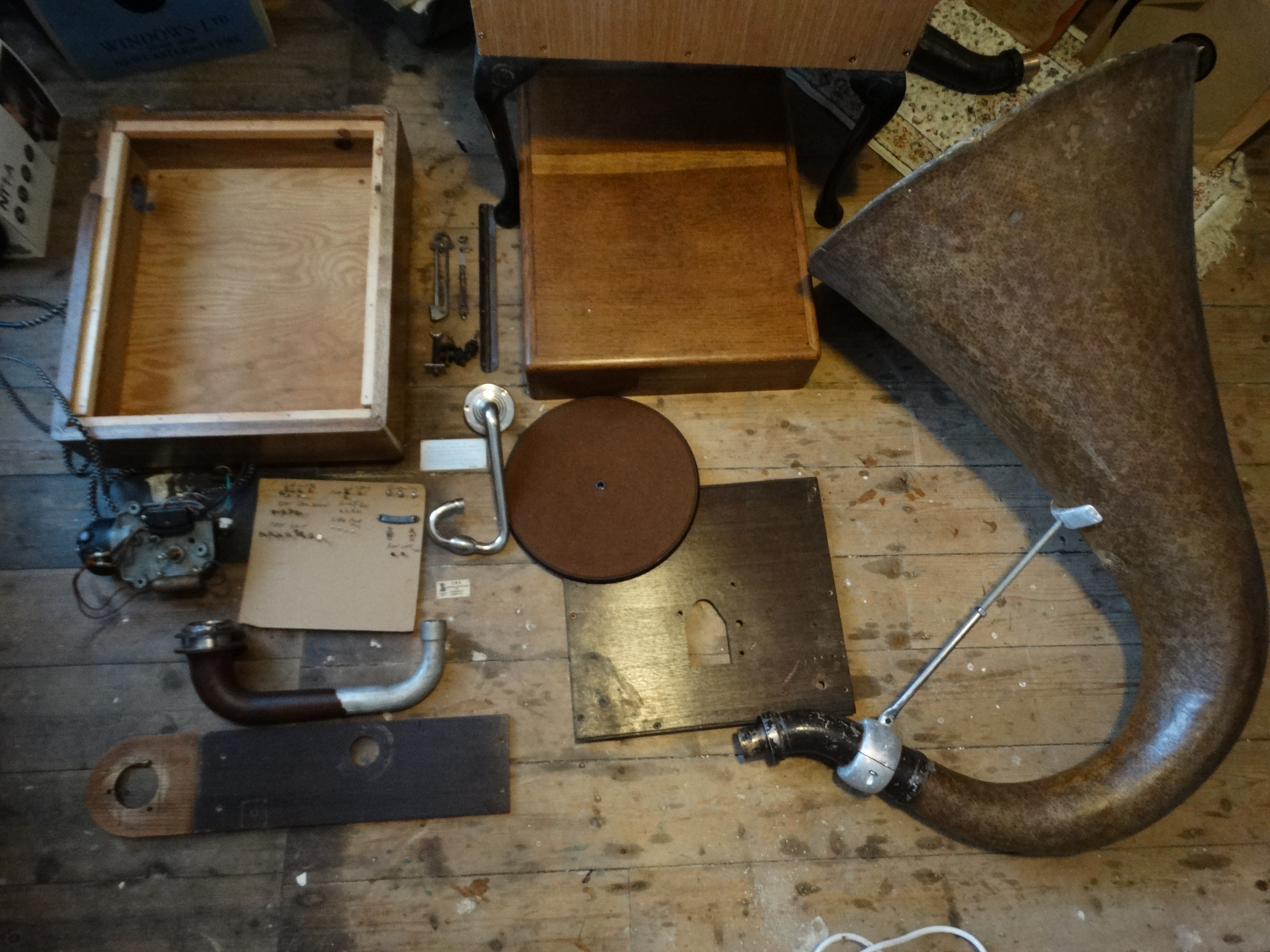

The motor fitted is a Garrard U5, It was very noisy and in desperate need of an oiling, I have gone through and oiled it and the noise is diminished, though with the lid closed is barely noticeable, and it keeps good speed, I've also removed the redundant arm rests on the motor board.
The soundbox is a large diameter EMG 2 spring, it required new screws for the springs as one does not have the right thread, new screws are on order and should be a great sounding soundbox when complete (The IX's soundbox is on the left, compared to the large diameter EMG 2 spring I got recently on my EMGCR Xb Oversize)

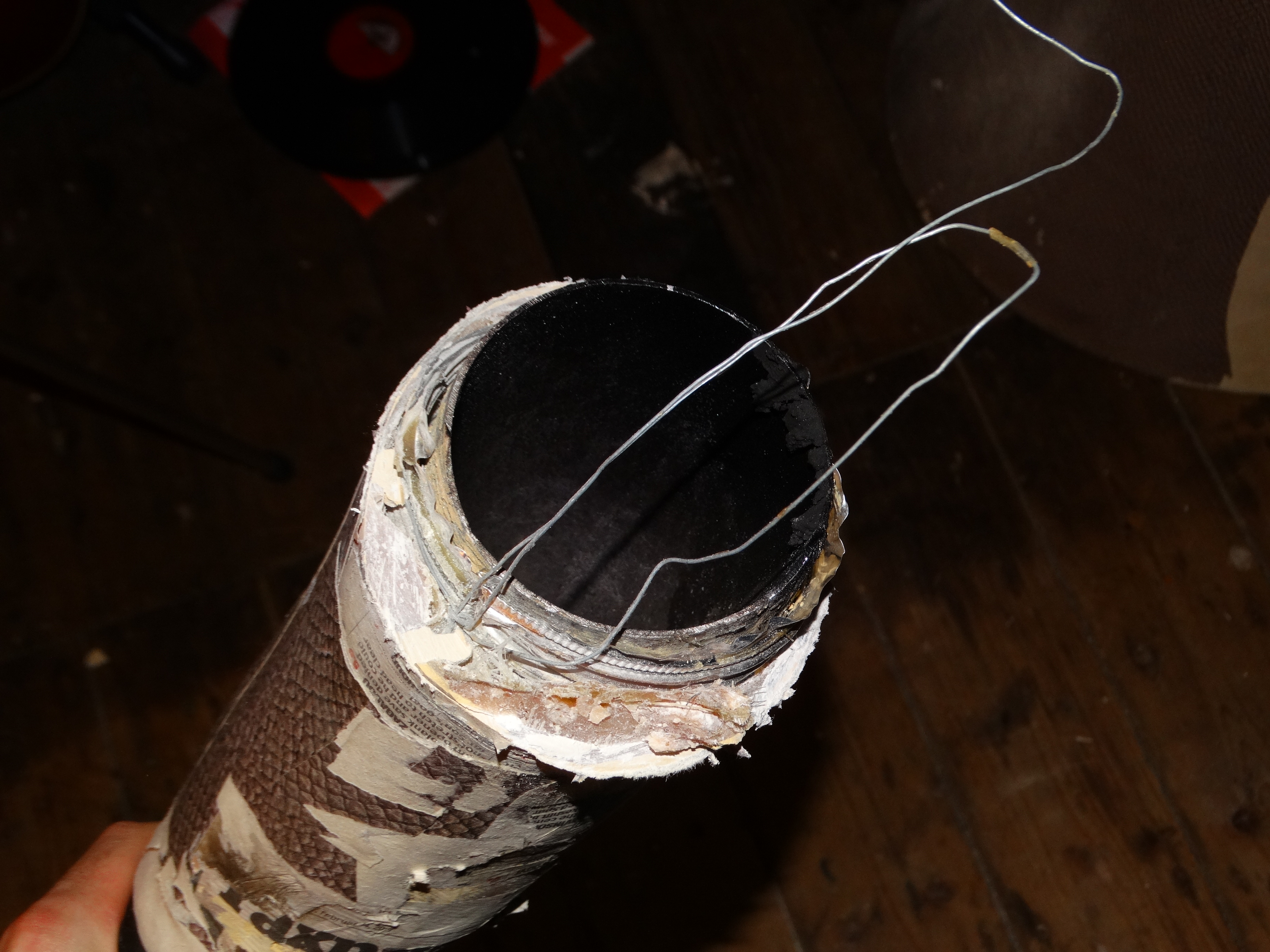

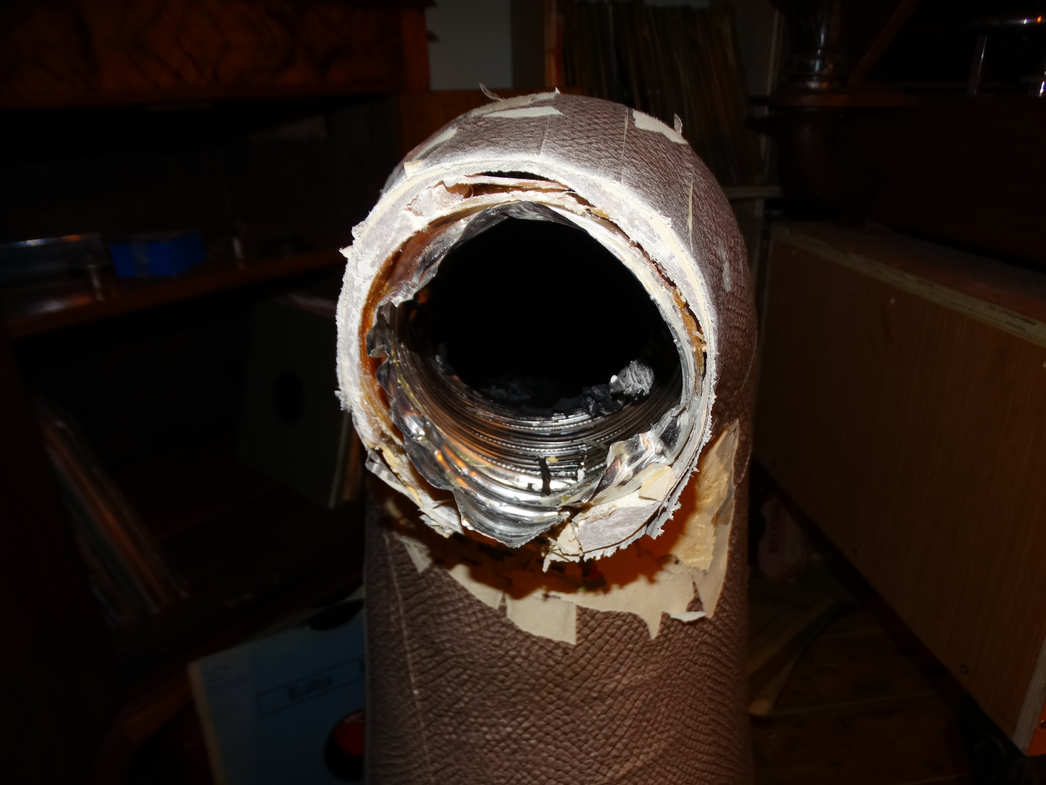

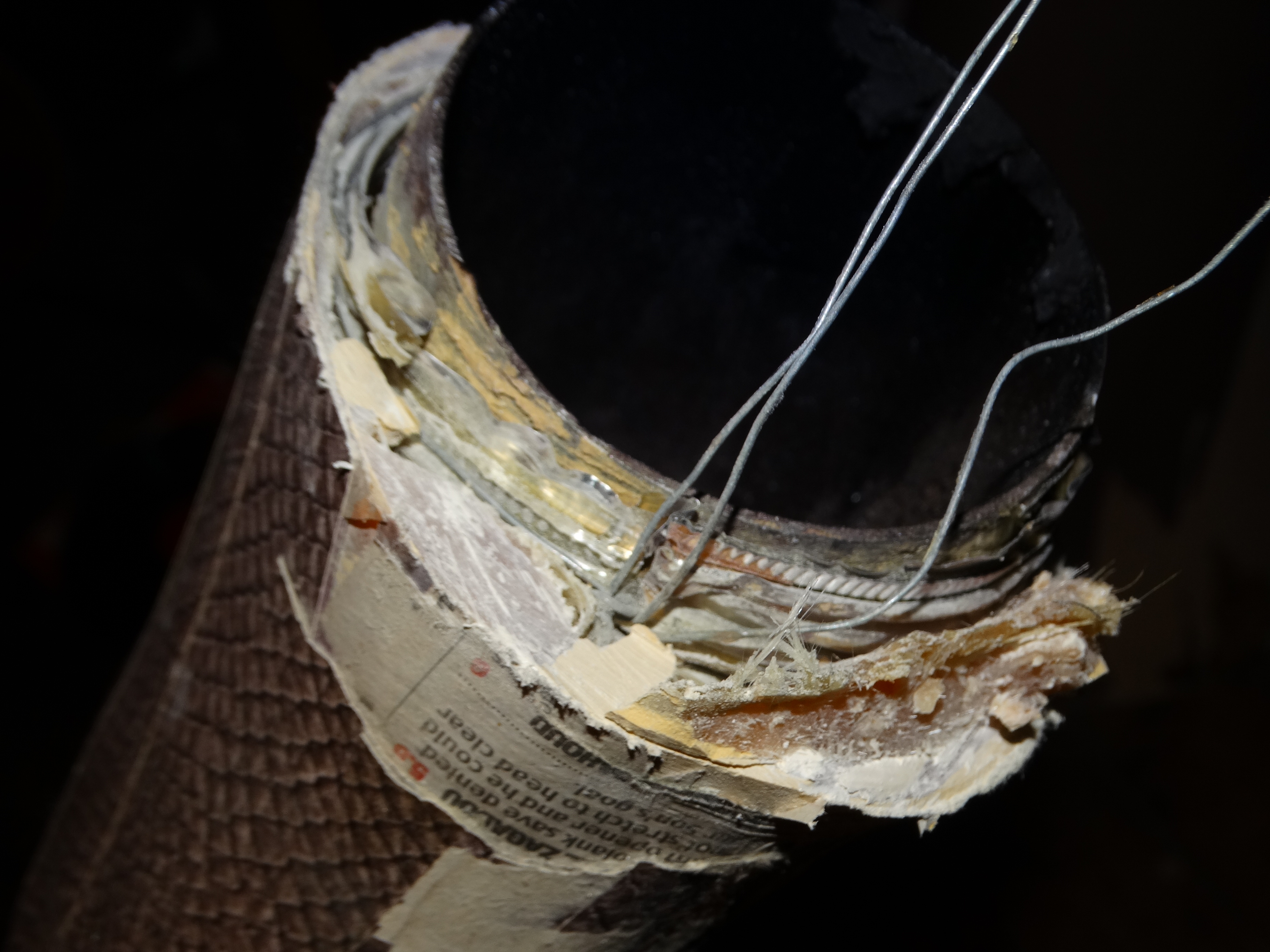

Well Happy Halloween!, here's a fright for you
It seems the previous owner cut away much of the original horn and attempted to re-build it from aluminium ducting, wire, fiberglass and body filler, a date was found in the layer of newspaper of February 14th 2019, given the gramophone sold on January 30th, the horn was destroyed in short order, chipping away all the rubbish around the casting will be fairly arduous in itself.
