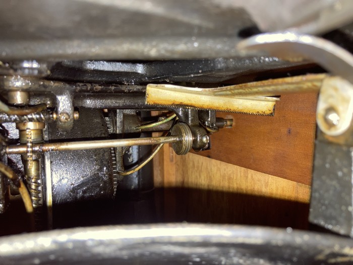

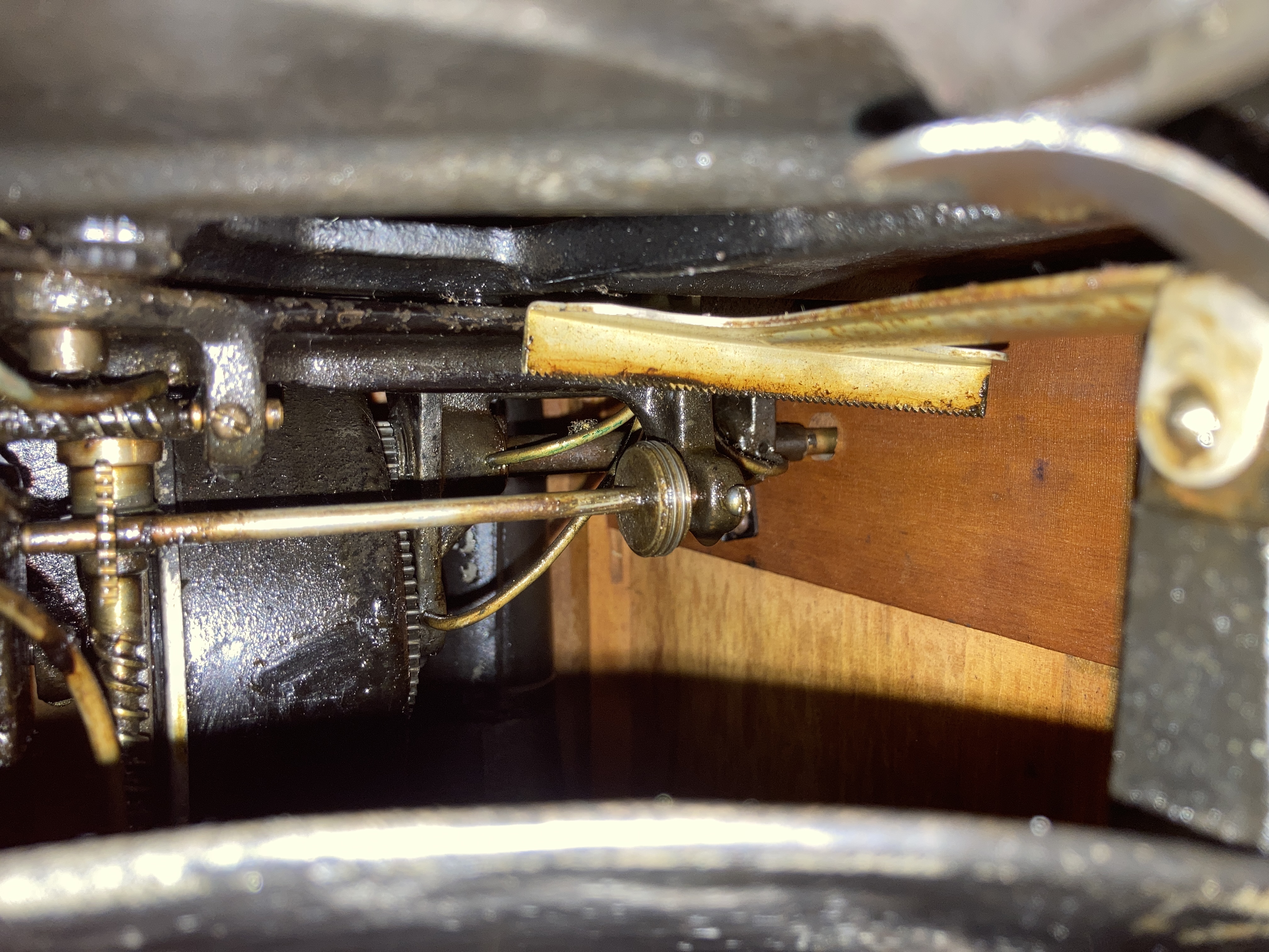

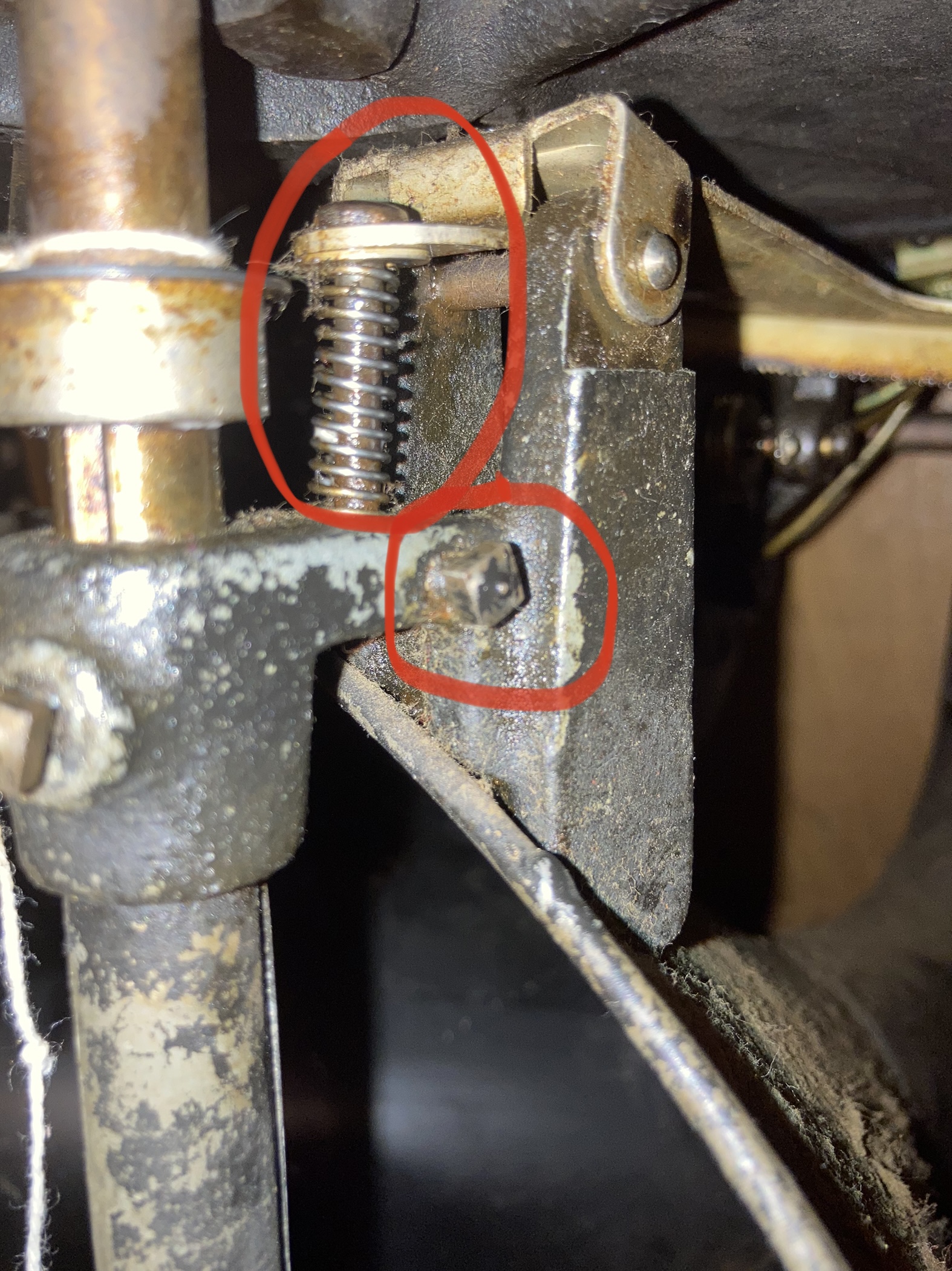

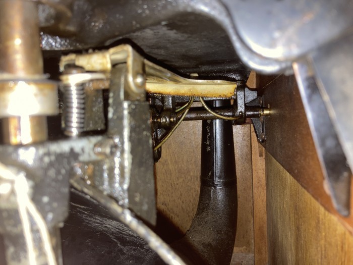

Ok: to be sure. The pin and set screw to adjust the feed rack are the ones circled in my photo. Correct? I’ve never been this in depth with a DD machine before so prepare for some dumb questions. Looking at Earl H’s photo mine seems to be leaning forward a bit compared to his photo.

If you loosen that square headed screw that will let that pin move. You just need to set it down far enough so the rack clears your gear when the horn is lifted and then engages when it's lowered. It usually takes a little fiddling around with is all.

Ok. I understand pushing down on the pin will move the height of the toothed rack up and out of the way. But just to be completely sure. The screw you mentioned is the one circled In my pic? I really don’t want to goof this up and I want to be ultra sure I’m doing this correctly.EarlH wrote: Sat Nov 13, 2021 12:37 pm If you loosen that square headed screw that will let that pin move. You just need to set it down far enough so the rack clears your gear when the horn is lifted and then engages when it's lowered. It usually takes a little fiddling around with is all.

Yes, the one you have circled. The other two will release the lift lever and adjust the height of the horn and reproducer when you set it down to play a record.

Ok cool! I’m starting to feel confident now.EarlH wrote: Sat Nov 13, 2021 12:59 pm Yes, the one you have circled. The other two will release the lift lever and adjust the height of the horn and reproducer when you set it down to play a record.
Now what tool would you recommend that would do the least damage getting that screw loose?

GOOD NEWS! My rackover problem has been fixed and the screw was way more easier to loosen than I thought it was THANK GOODNESS! My records still track just fine! And my rackover isn’t bumping into that gear! Yay now that’s one issue fixed!

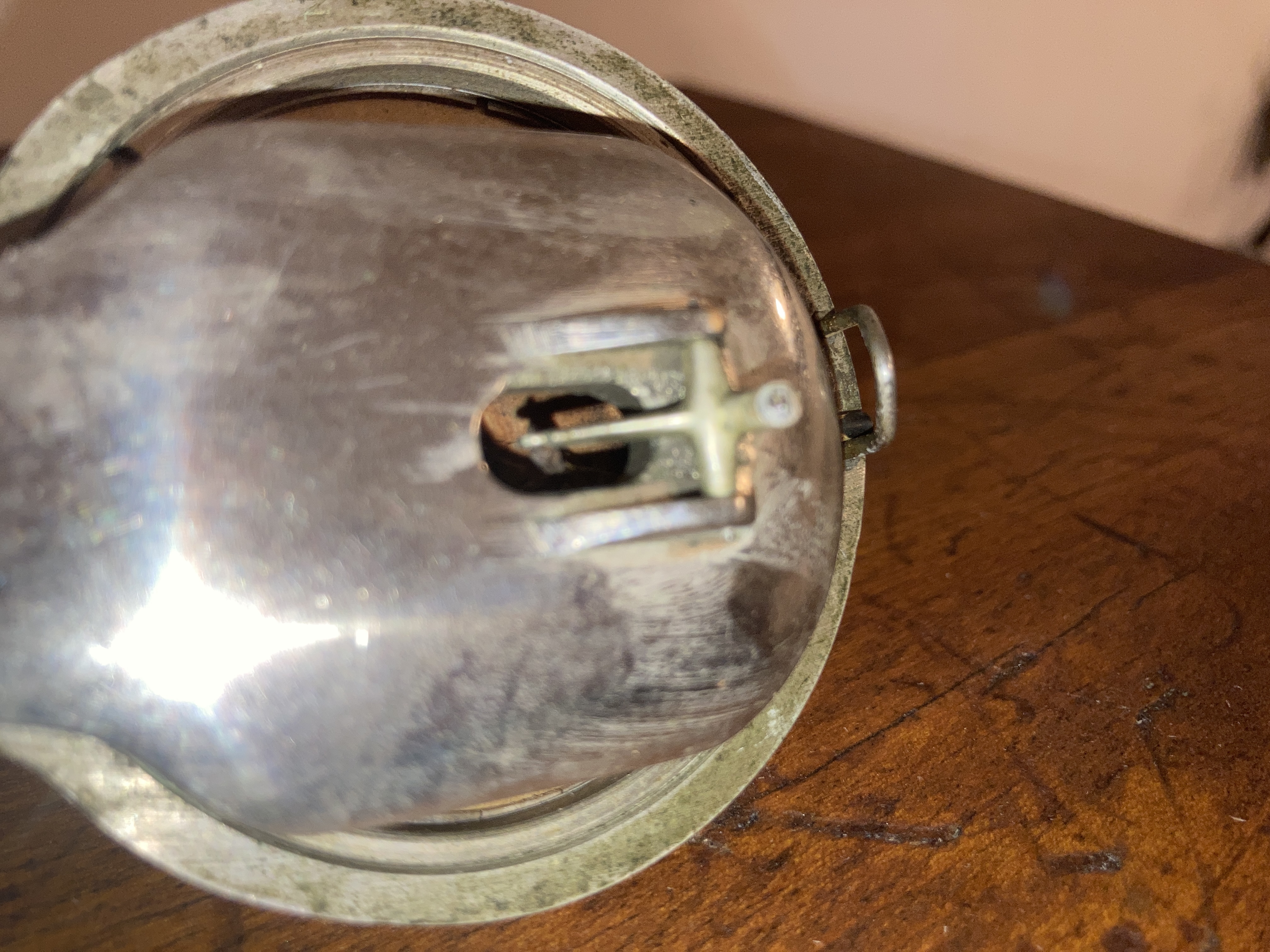

Here’s also an up close photo of my reproducer. As you see the stylus is shot so I’m using a spare that’s been rebuilt at the moment I’m gonna order new gaskets and a Phonoboy diaphragm too.
