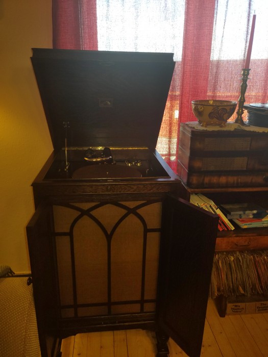

Unfortunately I live in a remote rural area, where neighbours are hard to find, and there is a very bumpy ride from my car area to the house, where a cradle would be of no use. No asfalt too, and right now piles of snow and ice everywhere having fallen from the roof.
However, with care and well planning, I received very good help from a friend, and we were able to carry it safely indoors, no bumping into door frames, no slipping on ice etc.

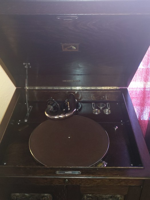

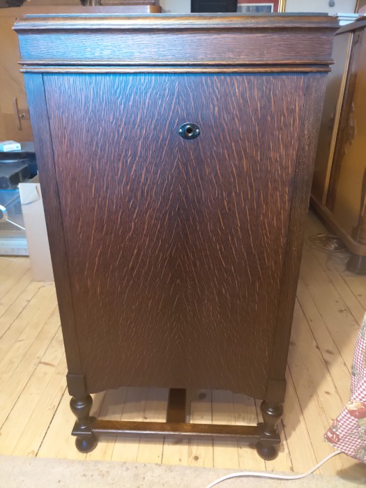

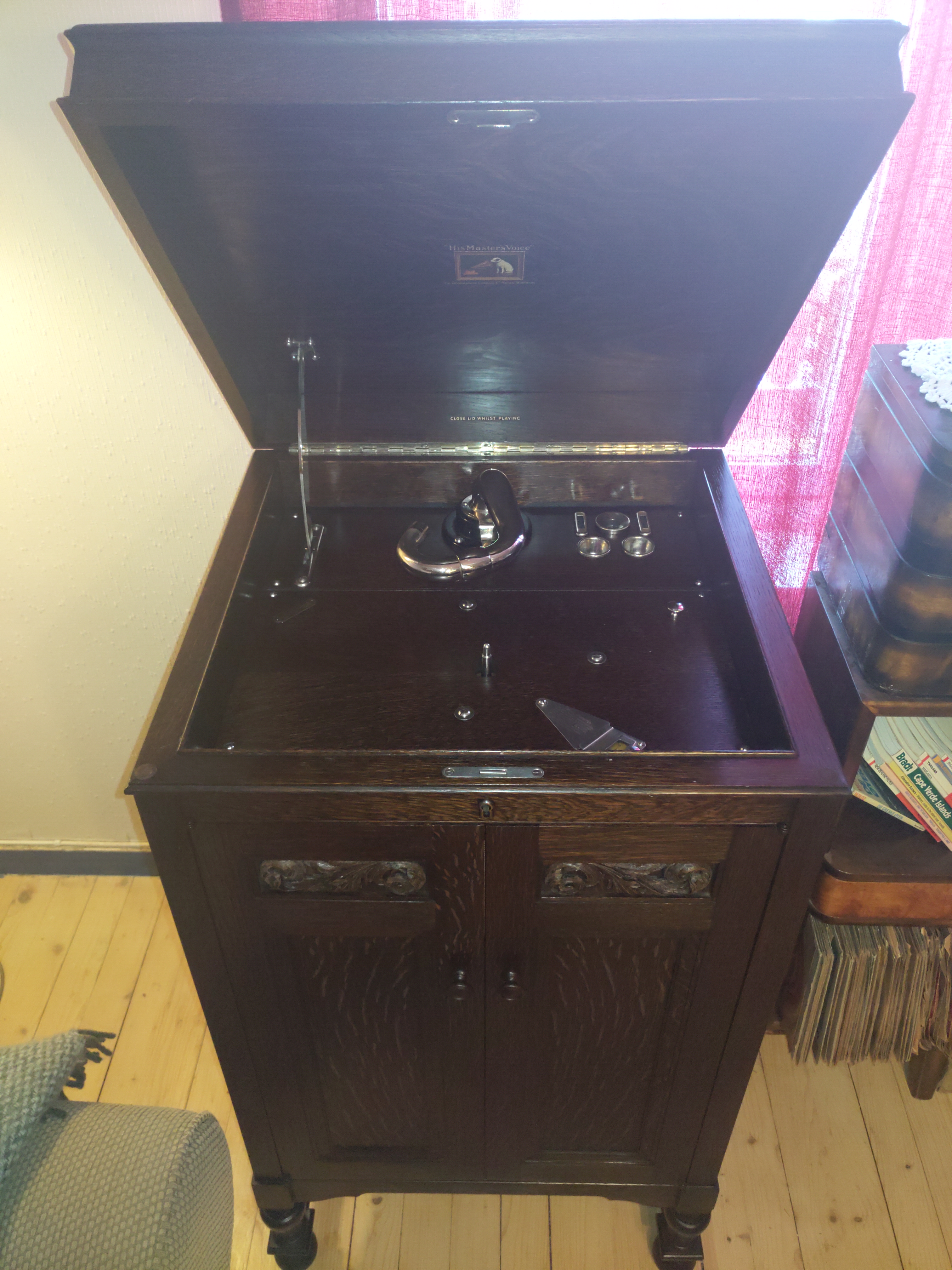

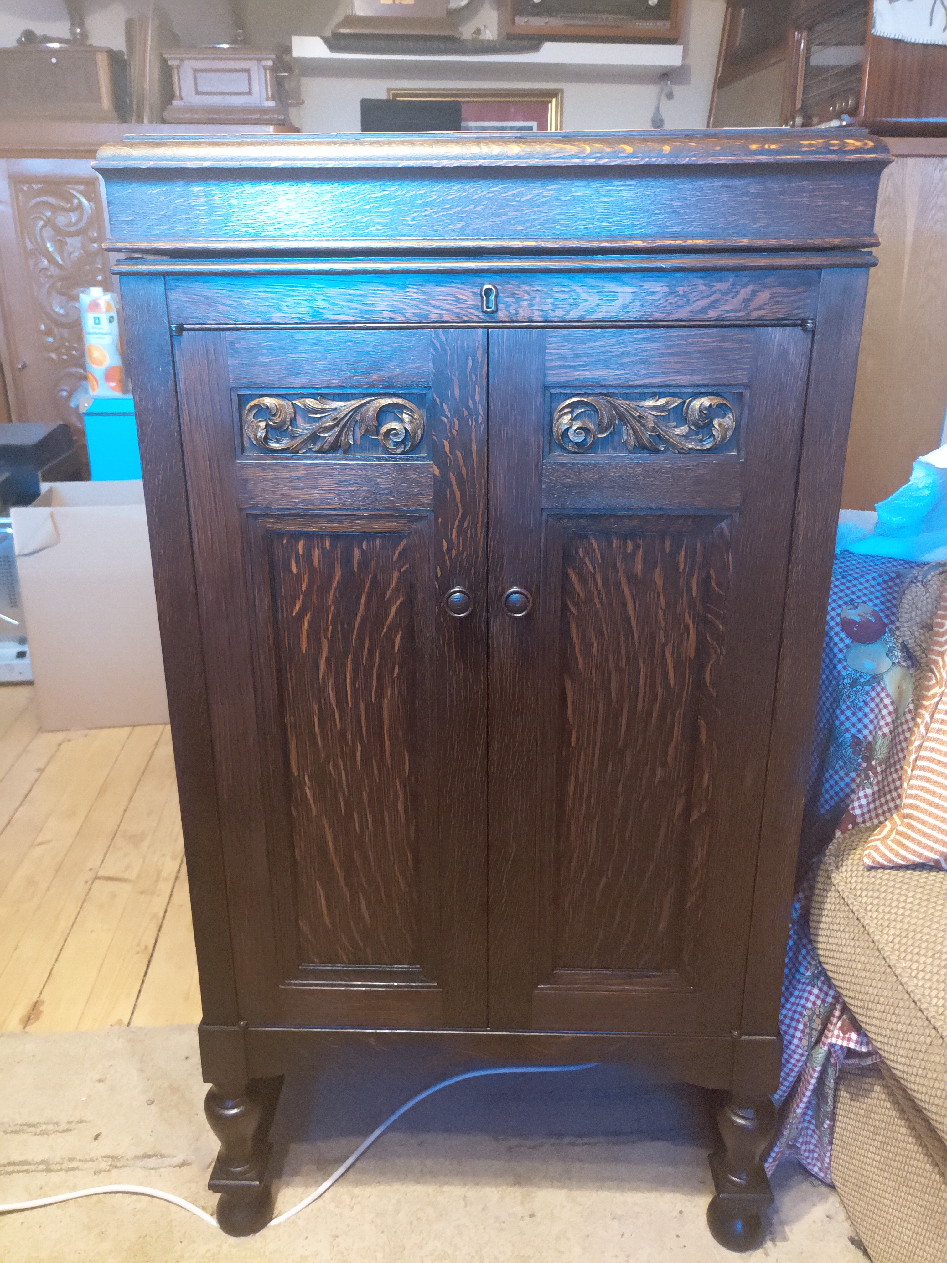

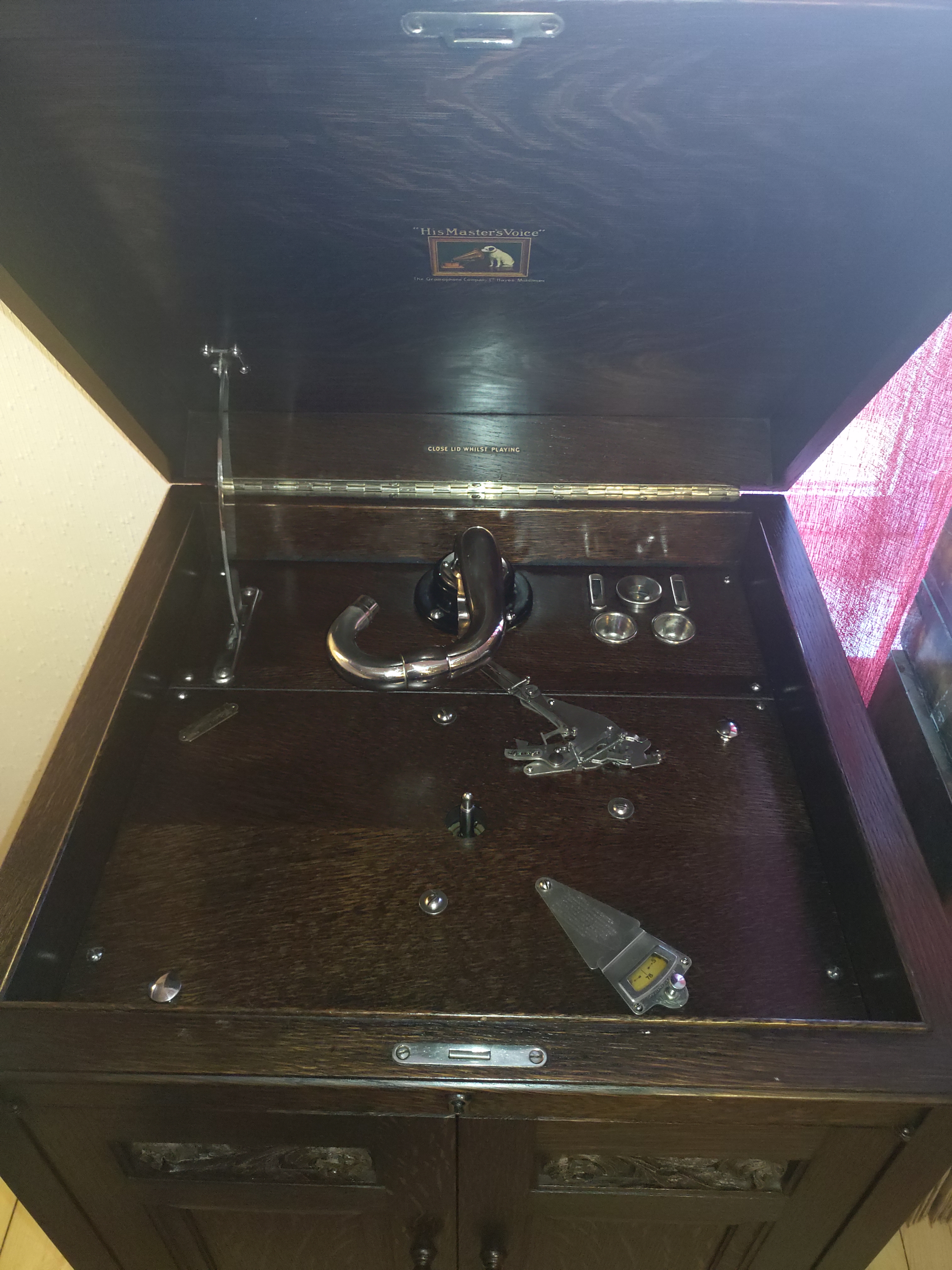

I spent yesterday cleaning it with Swarfega ( not that it was very dirty), applying Howard's Restor-A-Finish ( dark oak) before adding wax from the same manufacturer. The cabinet is shining, and well...I love it already. I have not tested it yet, but it will happen today ! I upload some more photos, so you can have a look, even if it is a bit dark indoors here so the photos really do not make the cabinet full justice.
PS. The key is not lost, it is put into the lock.......now.

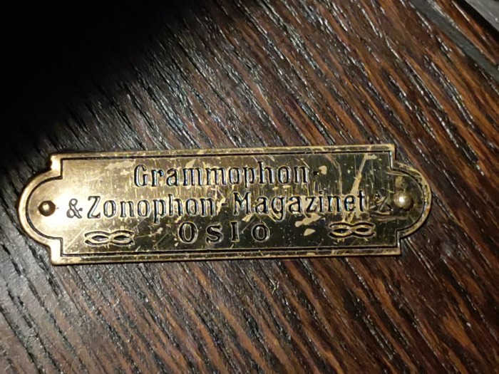

Is that a dealer's plaque on the top left hand corner of the motor board? If so, can we see it please?
If it is a UK dealership I may be able to trace it.

Roger, here is the dealer¨s plaque, these heavy machines were actually exported to little Norway almost 100 years ago, and we all know that the only way to do it back then..was by boat across the rough North Sea.
