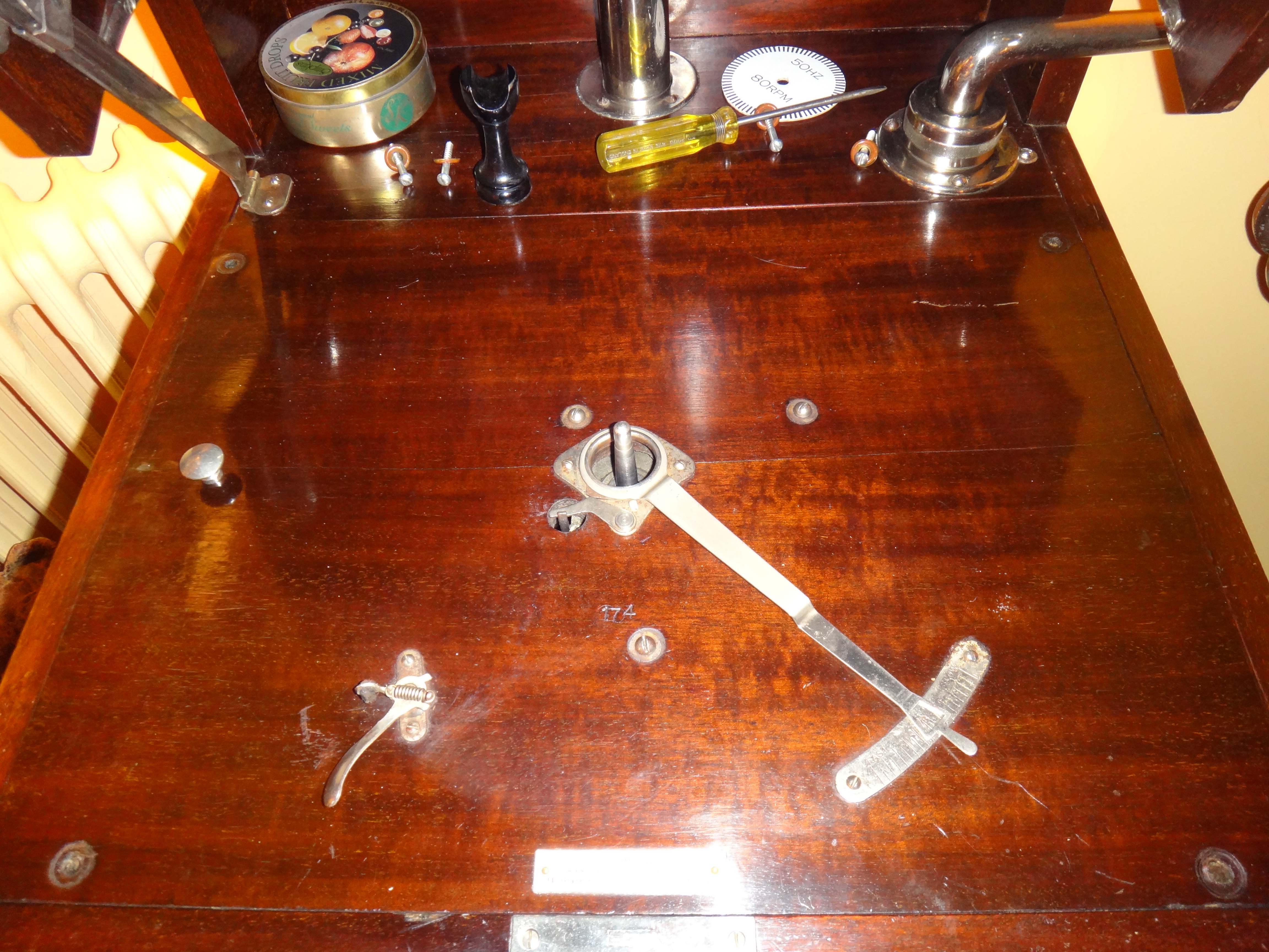

Thanks Mike. The bolts look in the right place. Where does the winding handle fit into the motor and would the hole in the deck near the tonearm pivot be the original position of the speed control?

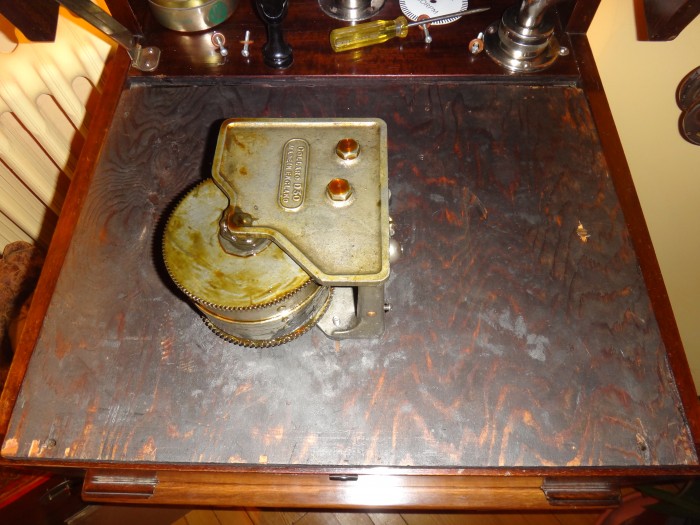

Here is a deck-board above a Collaro D30 motor. I am afraid the hole positions would only have a chance of working if the winder emerged from the back of the case !
I should have thought the speed control would have been at 4.30 much as for the HMV 34.

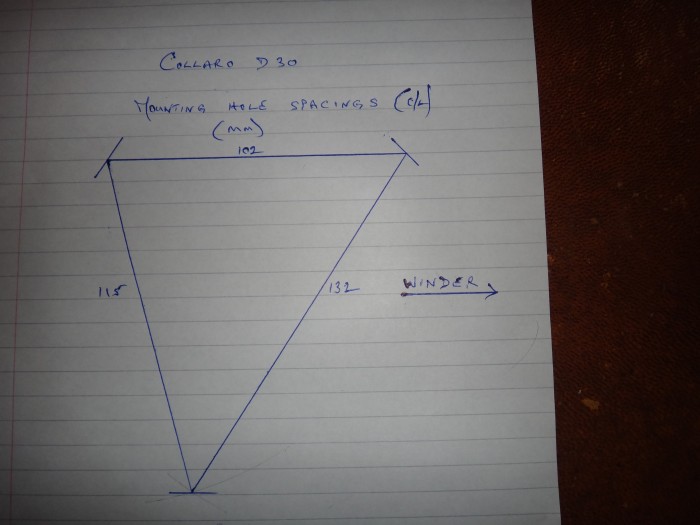

Have just measured the two holes in question, they are exactly 65mm centre to centre. Maybe this will either rule out the D30 or leave it open as a possibility.

Have just noticed in the picture of Grahams deck with the Collaro motor that the tonearm bearing is set much further forward from where the conduit emerges through the deck board. In mine the conduit is almost parallel with the back of the case which may explain why it is offset from the centreline.

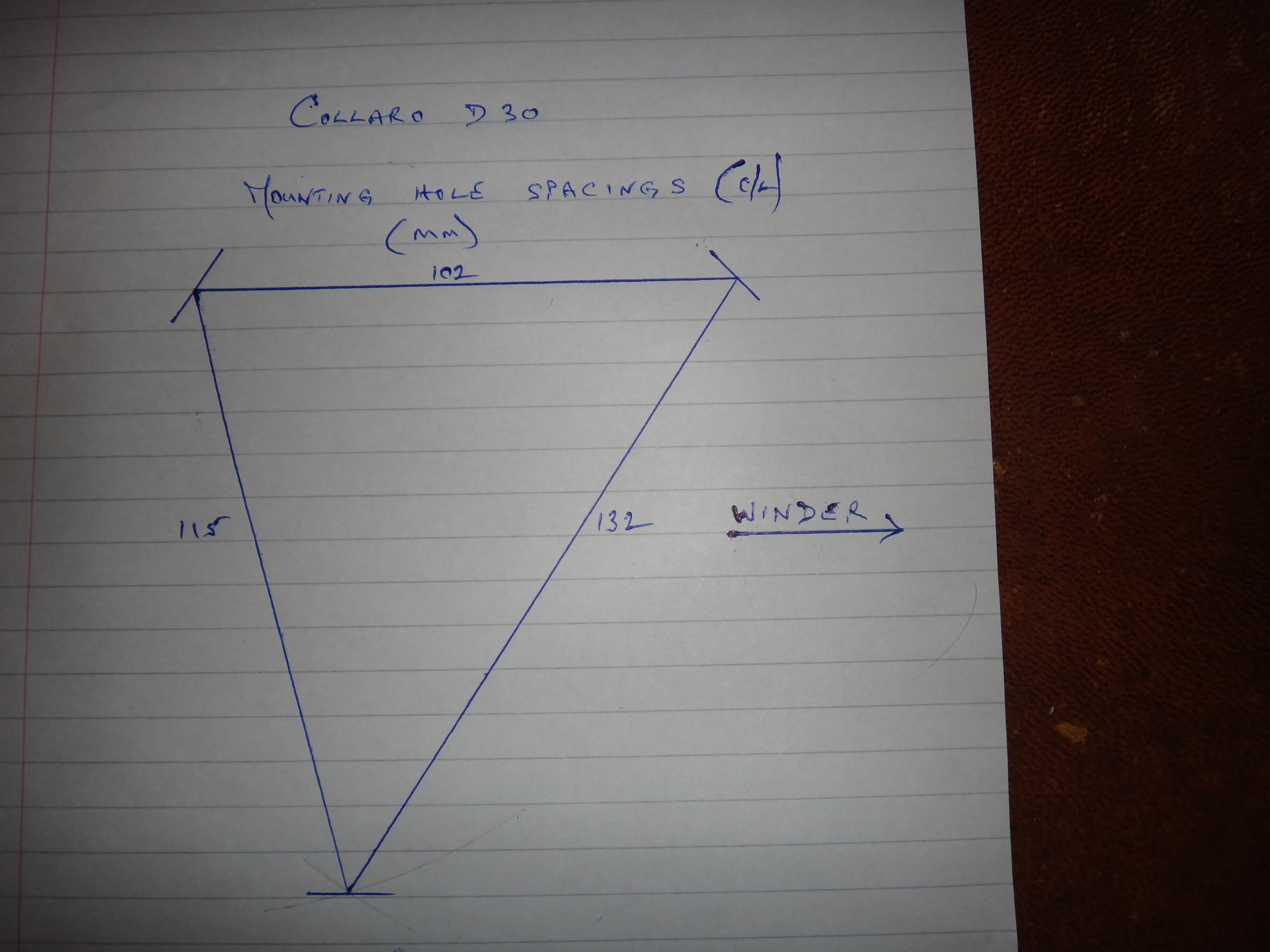

Here are the approximate coordinates of the D30 motor hole fixing centres. Iain, your 65mm compares to the 102mm shown.
