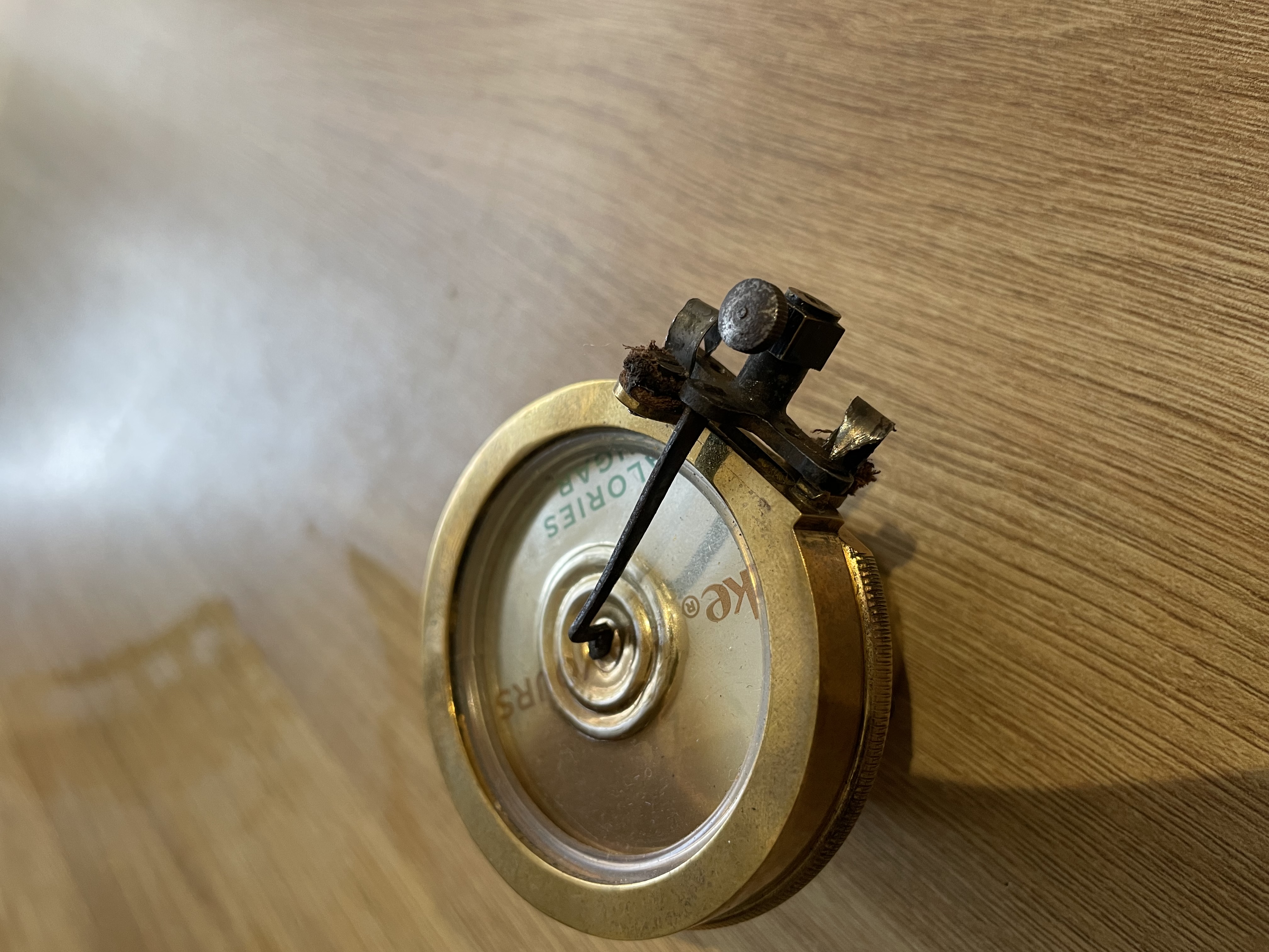

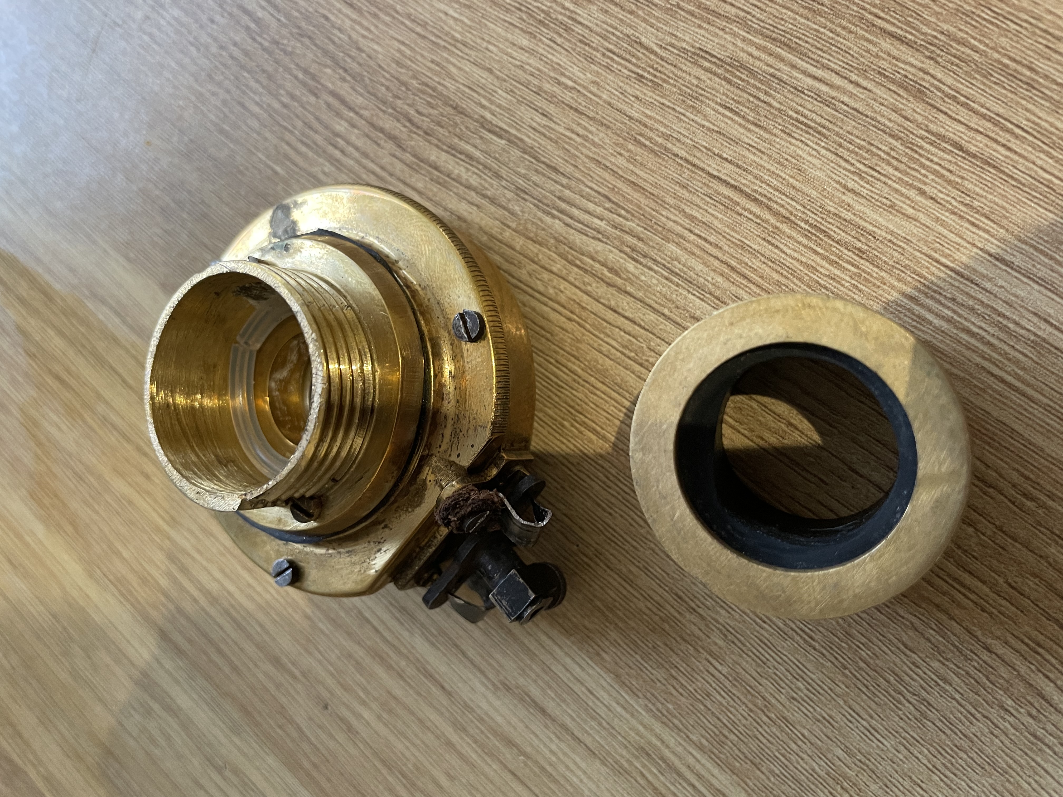

I had a play about with an Exhibition (this is a Saturn but more or less the same) trying to copy an early EMG. Fabricated some springs and made a back from some plumbing brass coupling. The thread pitch is totally wrong but was an experiment without a lathe! It’s also a little heavy I think but it works ok.
As you can see I remade a diaphragm from an annealed coke can (I put the ridges in the wrong way round in error so the front has the writing in still!), after measuring a lot of my Meltrope diaphragms it’s the same thickness but must be annealed to remove the springiness.
Sounds pretty good but the screws holding the springs need to be pretty tight to stop sideways movement (something that isn’t as much of an issue on a Meltrope II, or even III.
