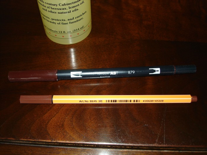

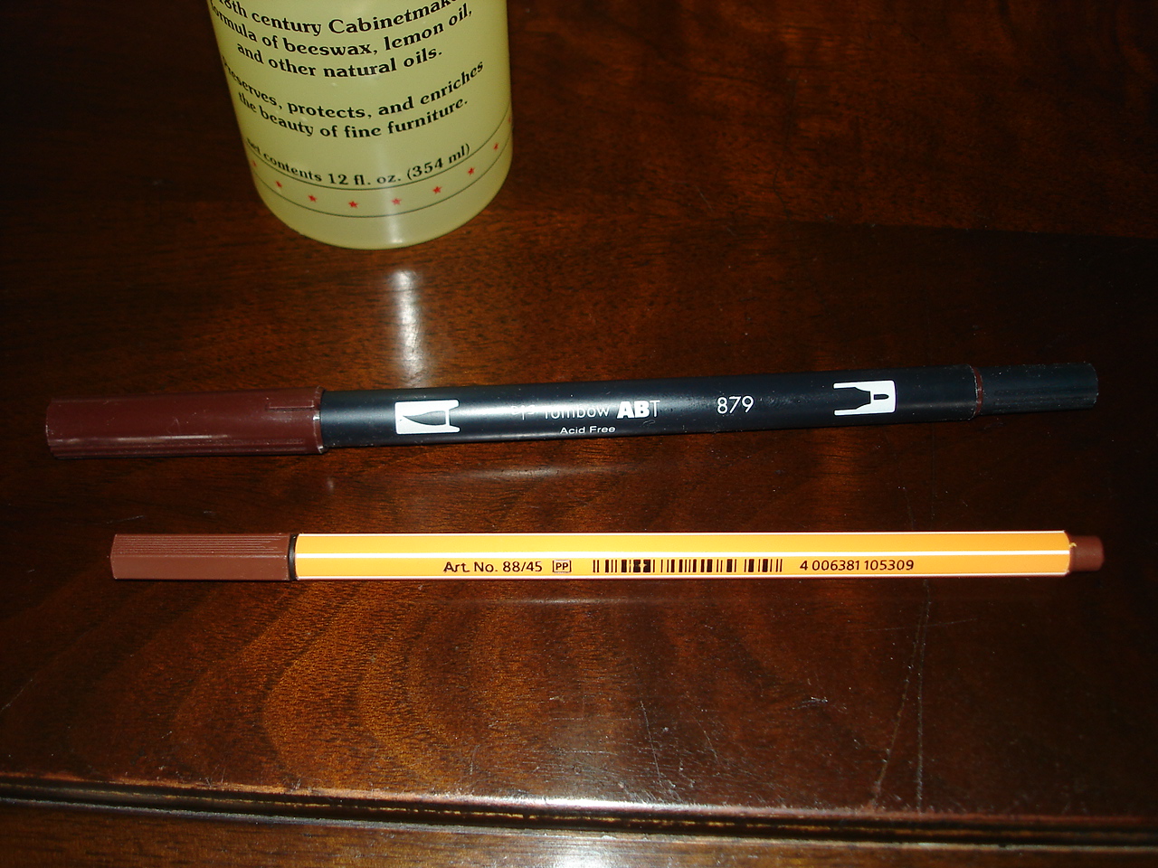

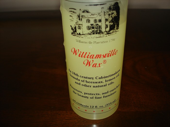

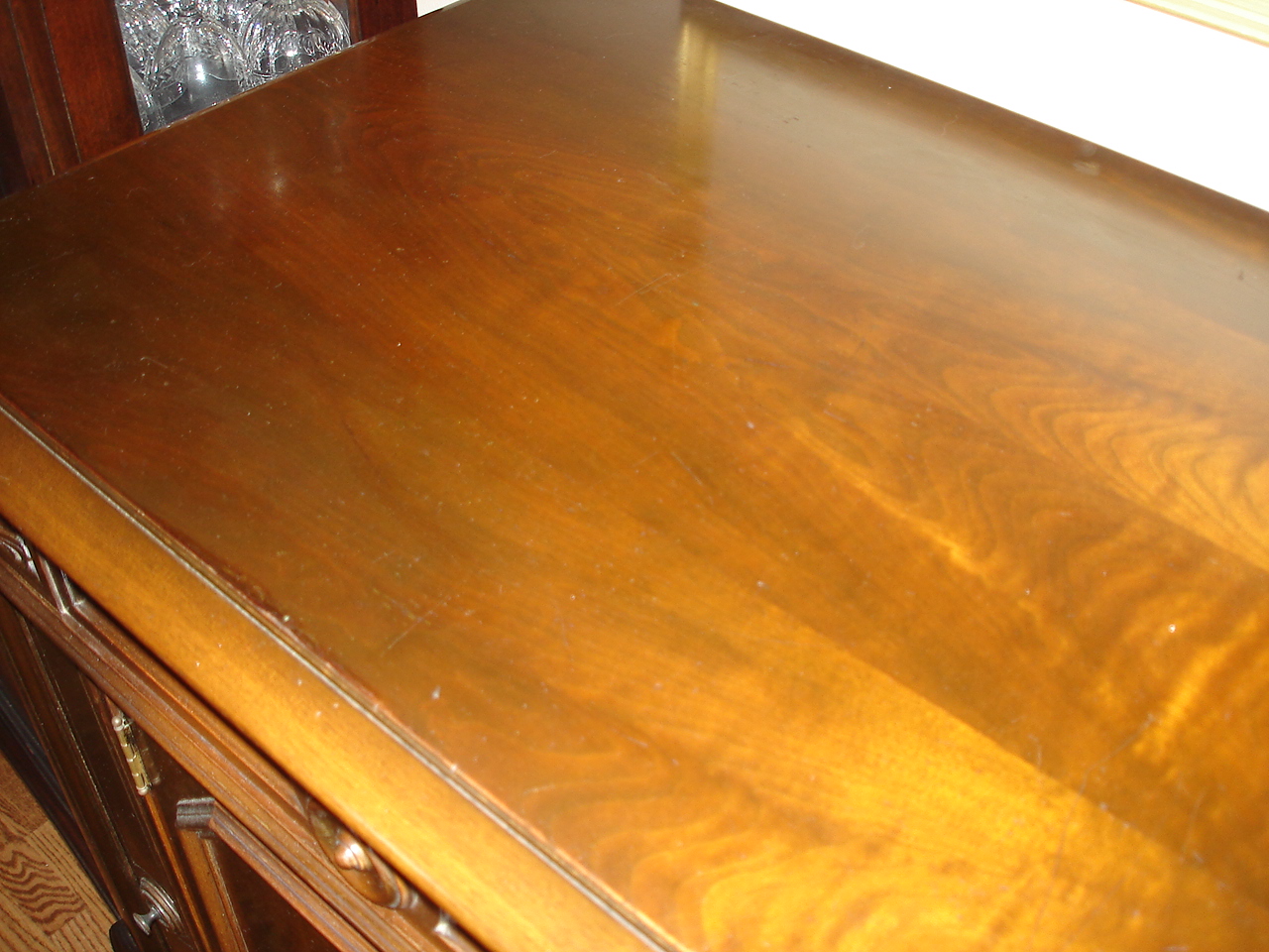

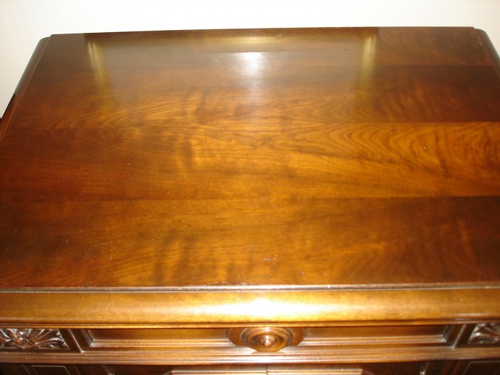

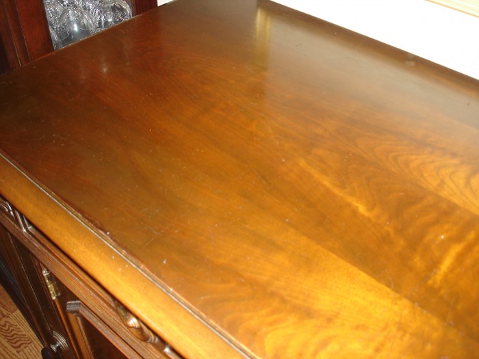

It may be that the finish on your lid is too far gone, however, I have a Credenza with a lid that looked a lot like that. I went to the art supplies aisle at our local arts & crafts store and bought a few extremely fine tipped artists markers, (while my wife was off buying all manner of stuff to use for heaven knows what :) ). More like a paint brush pen really. They have hundreds of different shades. Over the course of several weeks, when I had an hour or so I could donate to tedium, I carefully filled in the scratches with the markers, trying carefully to brush only within the scratches. Gradually, it began to look much better. Areas with thin finish, such as edges, I either used the markers or lightly brushed on some dye stain using a Q-tip, then passed my finger over it to blend it in. (Shouldn't really touch aniline dyes however!) Finally, a nice grade a beeswax finish and it looks pretty darned good. Maybe worth a try for you as well. Little to lose but some time and sanity. (Just don't use anything with silicone in it)

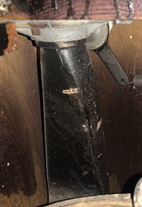

Based on the photos you've posted, your 4-20 is equipped with the cast-iron elbow-->>>
which is connected to an all wooden horn chamber. The horn, itself--think of a near-solid block of wood measuring 16 inches by 15 inches--is very heavy, as is the cast-iron elbow. In addition, though relatively small, the cabinet is not exactly lightweight thanks to Victor's excellent build quality.
The 4-20 horn is basically the same style horn used in the 4-7 which was discontinued at the time of its introduction, but turned on its side and fitted with extenders to make the mouth slightly larger. Several years ago, I posted a photo showing the 4-20 horn on this forum but it appears to have been removed from the database along with countless others :cry: .
