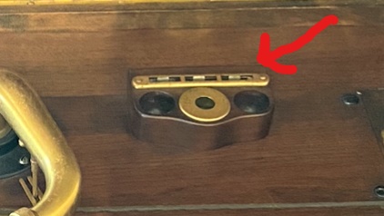

Question for the members. what is this? I am missing it along with the used needle cup.

The top strip is a holder for Tungs-Tone needle tins.

Herderz wrote: Tue May 17, 2022 11:46 am Question for the members. what is this? I am missing it along with the used needle cup.
I don't have a spare needle cup, but I believe I have a spare tungstone needle tin holder.

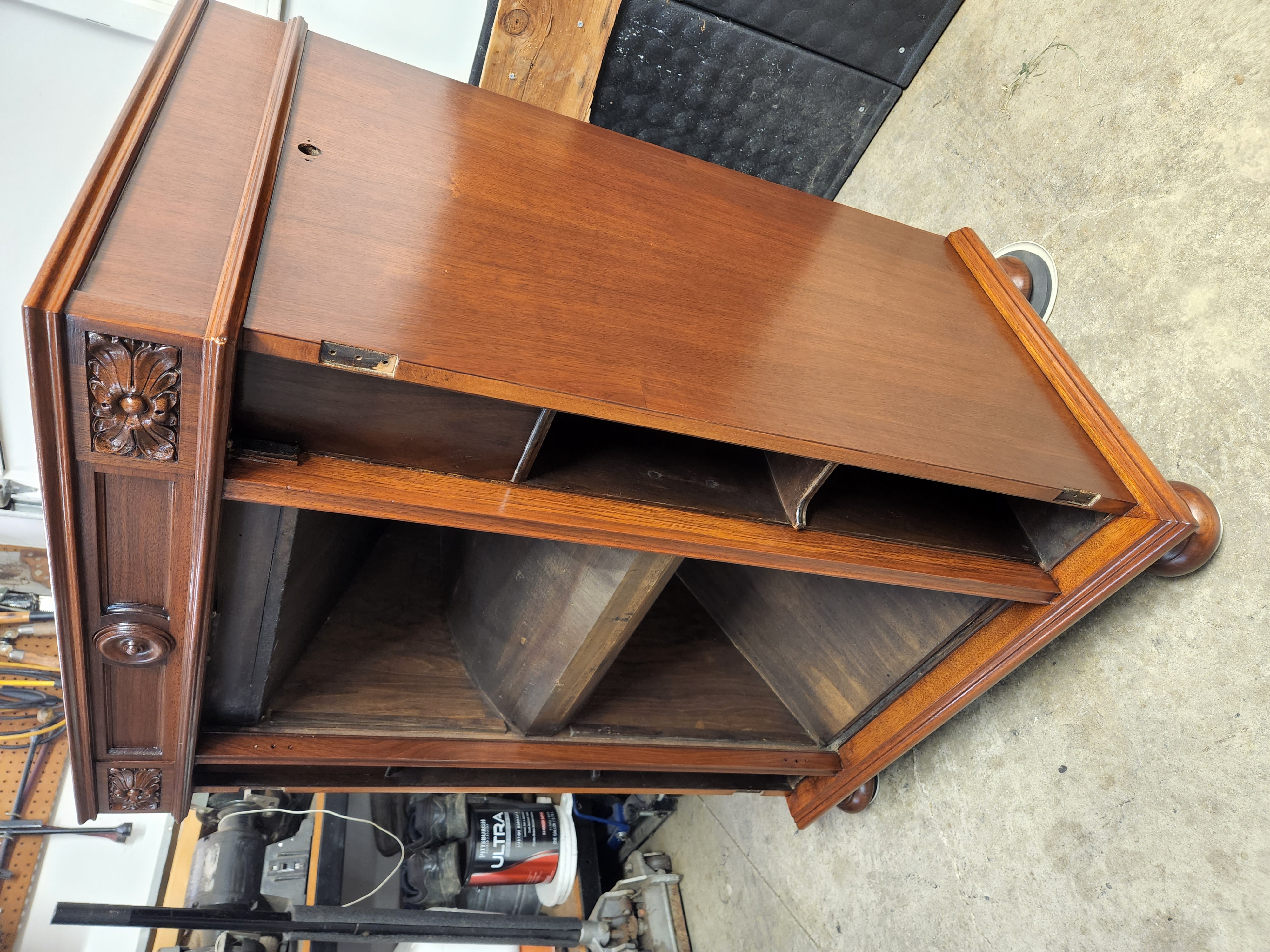

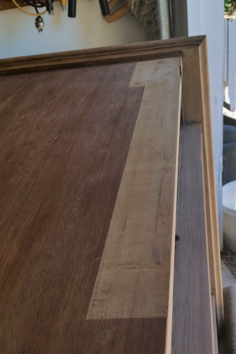

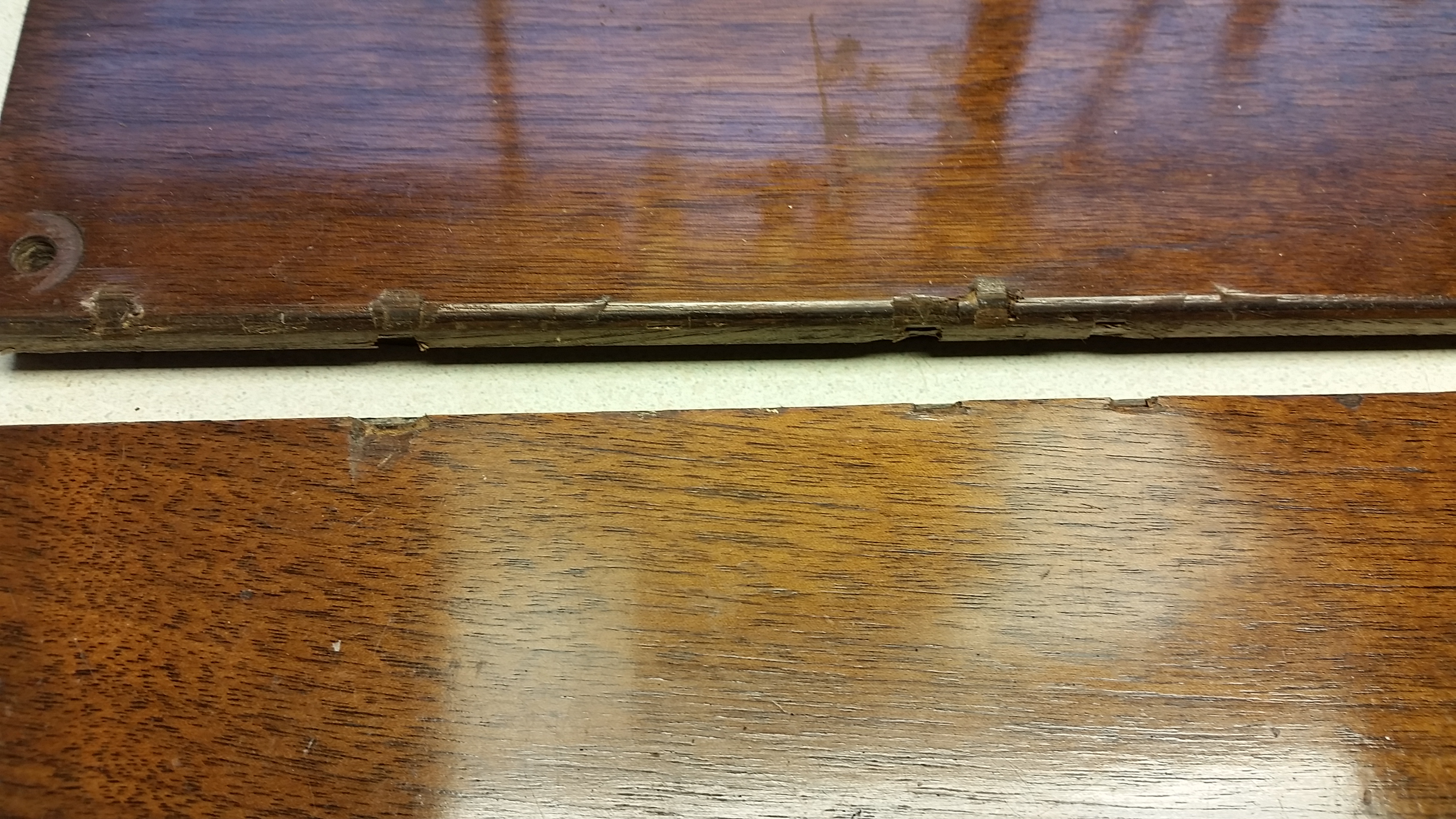

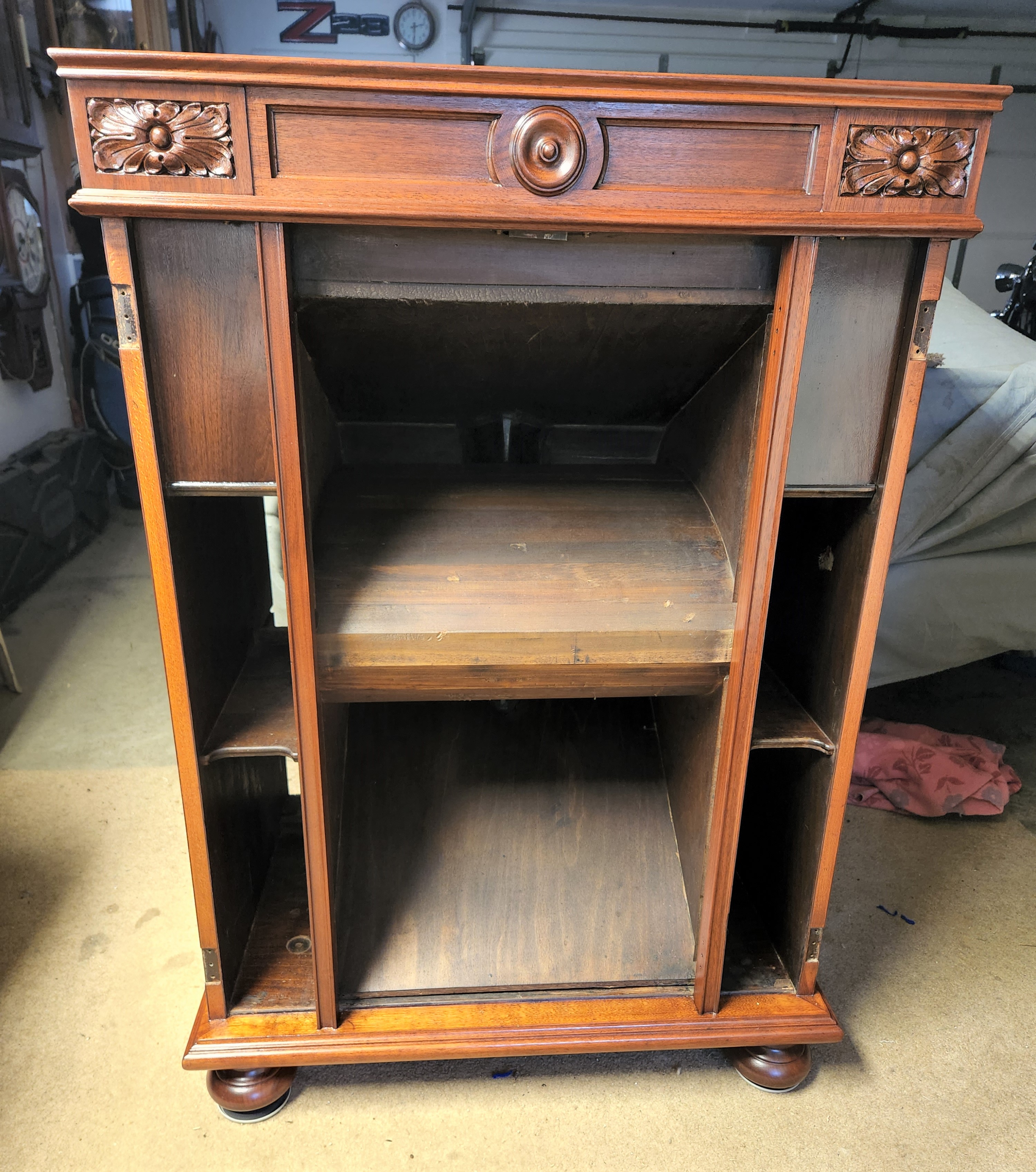

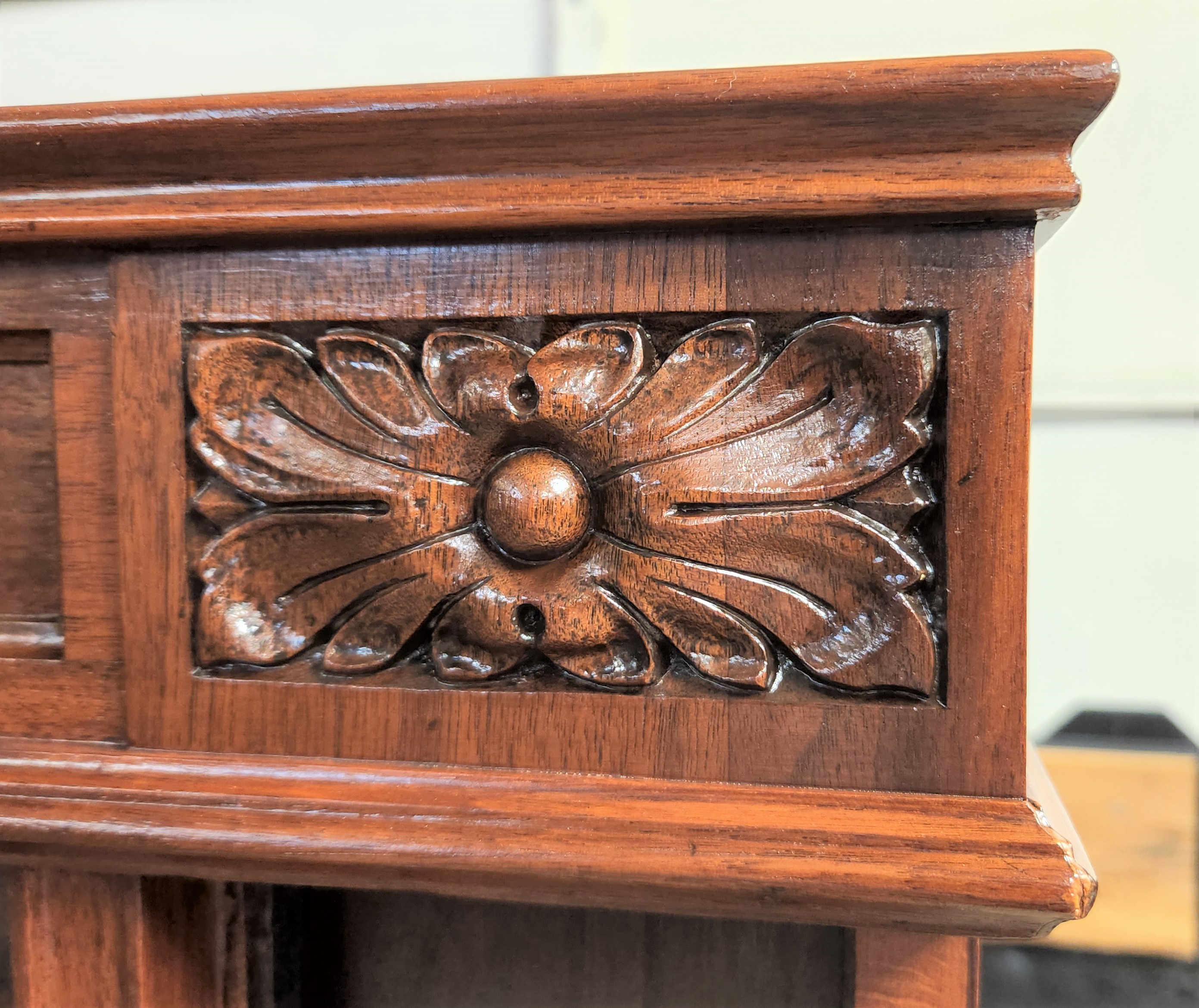

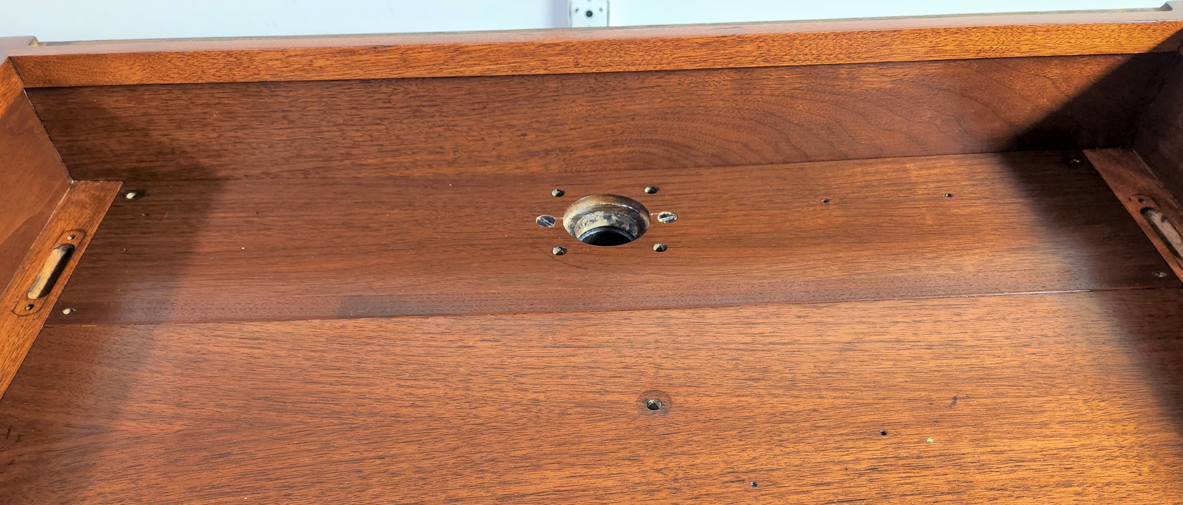

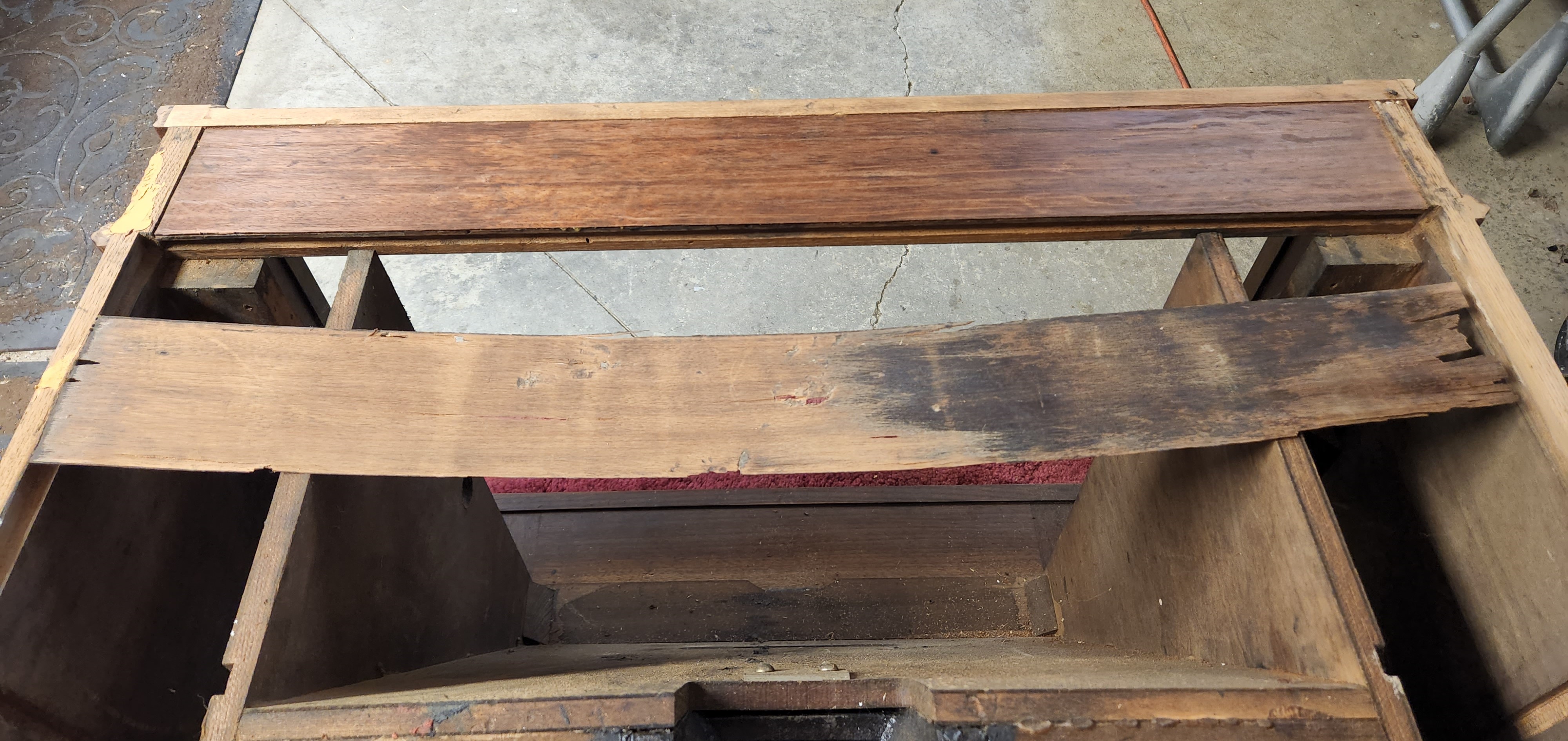

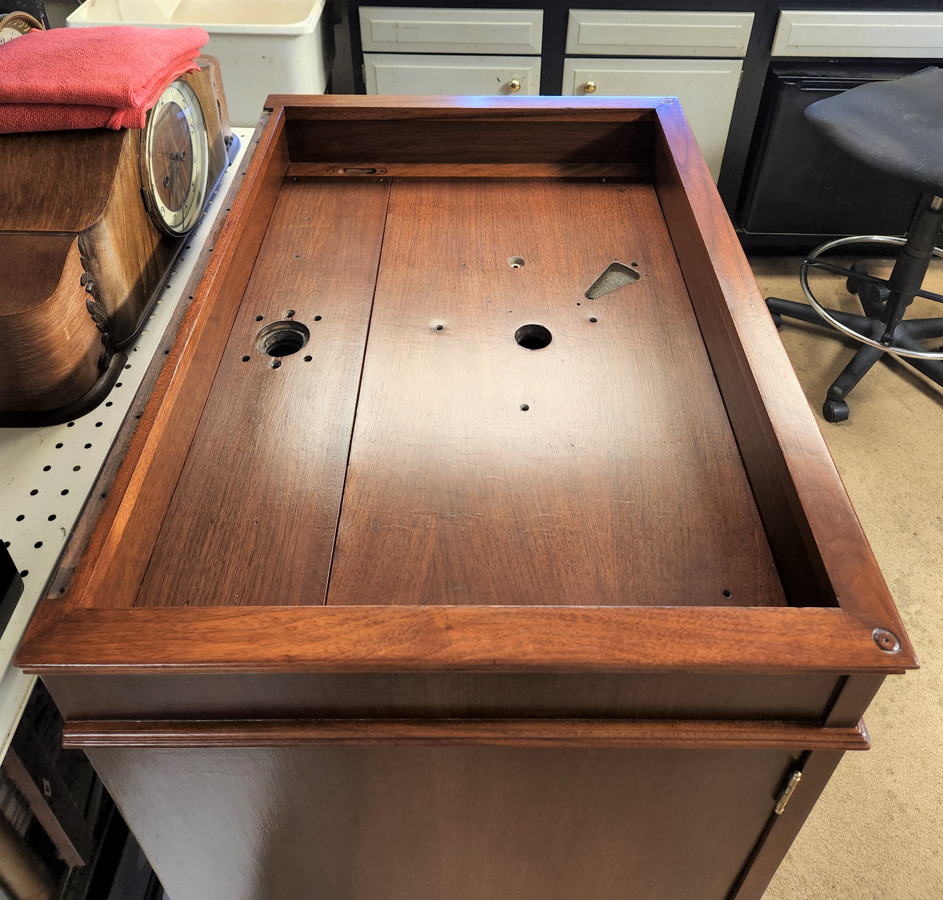

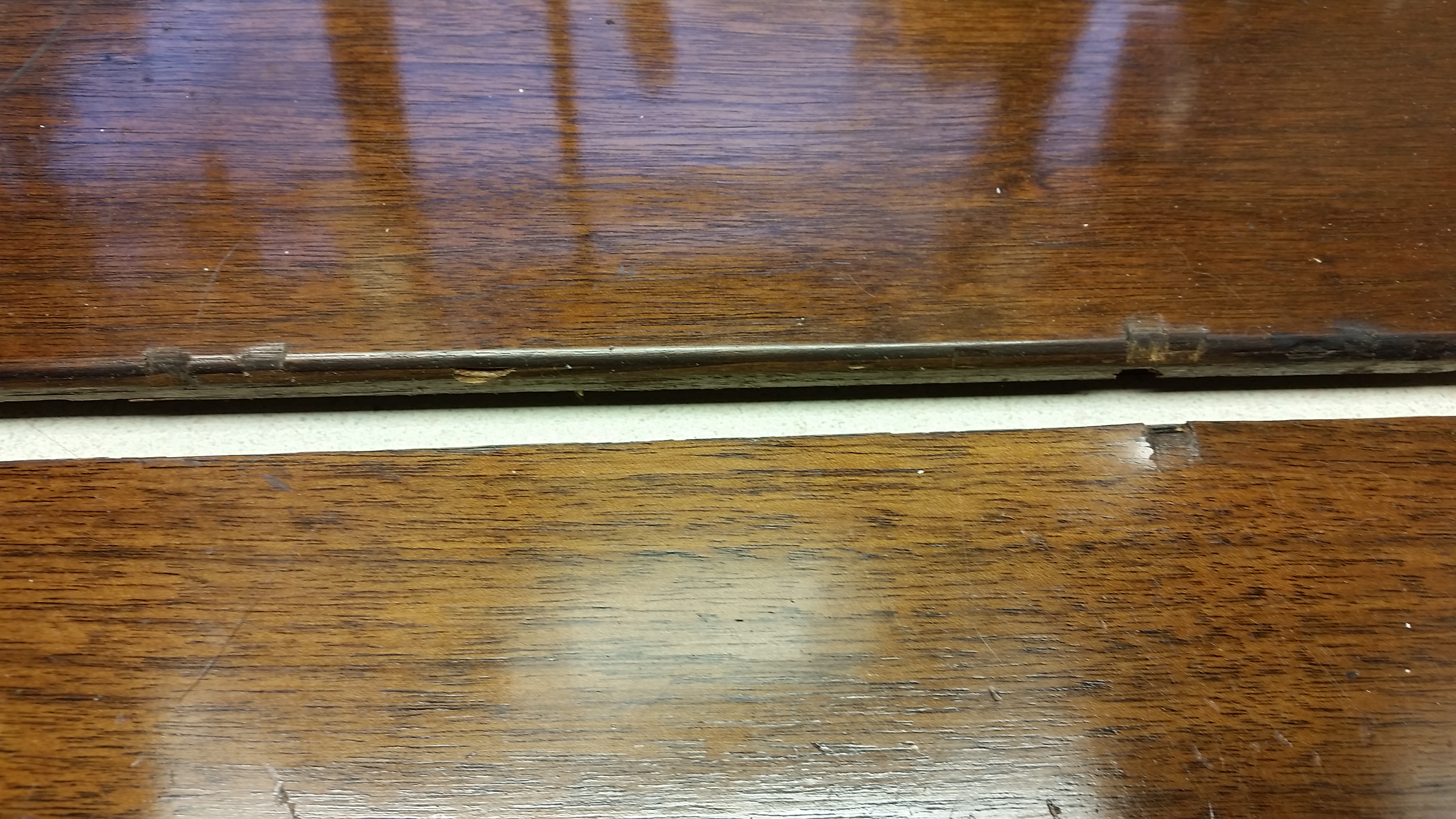

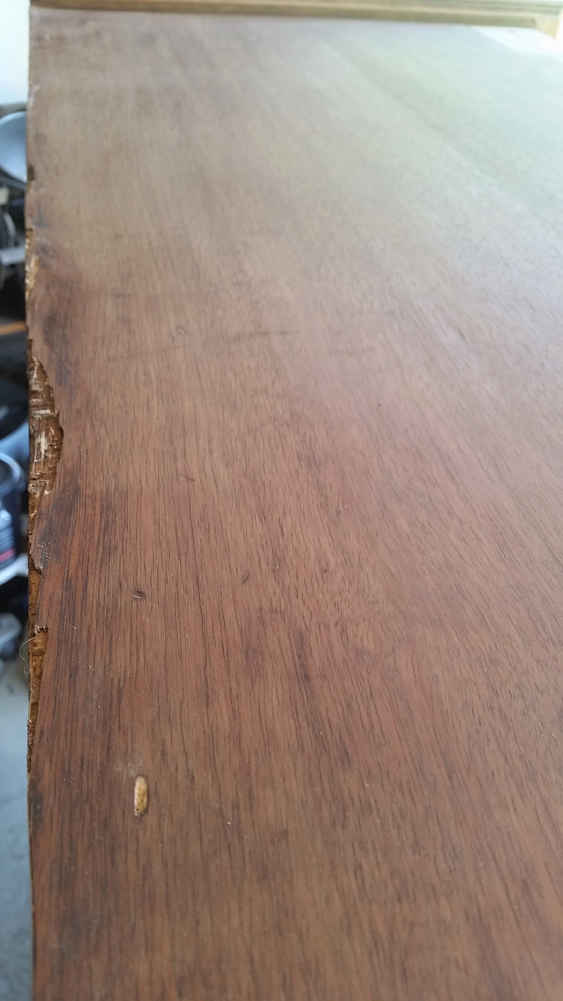

It has been over 3 months since I started on the restore. After breaking the machine down and evaluating my starting point there was way more to repair than I thought. I decided to just concentrate on the main cabinet structure. No feet but one and it was in bad shape. Major scrapes through the veneer on the right side front and back edges. Loose veneer on the left side and a gouge that went through the veneer just about from top to the bottom. Someone had taken a screwdriver to the motor board and tonearm board. I salvaged the veneer off of the lid to use on the sides, motor and tonearm boards because I thought the top would look better replacing the whole thing than trying to patch it. I decided to hand scrape the old finish off rather than use stripper. It came off very easily but very time consuming. Stripper to me takes a lot of time to clean up especially on trim and detail edges. Here is a couple of pics but by no means all that I faced.

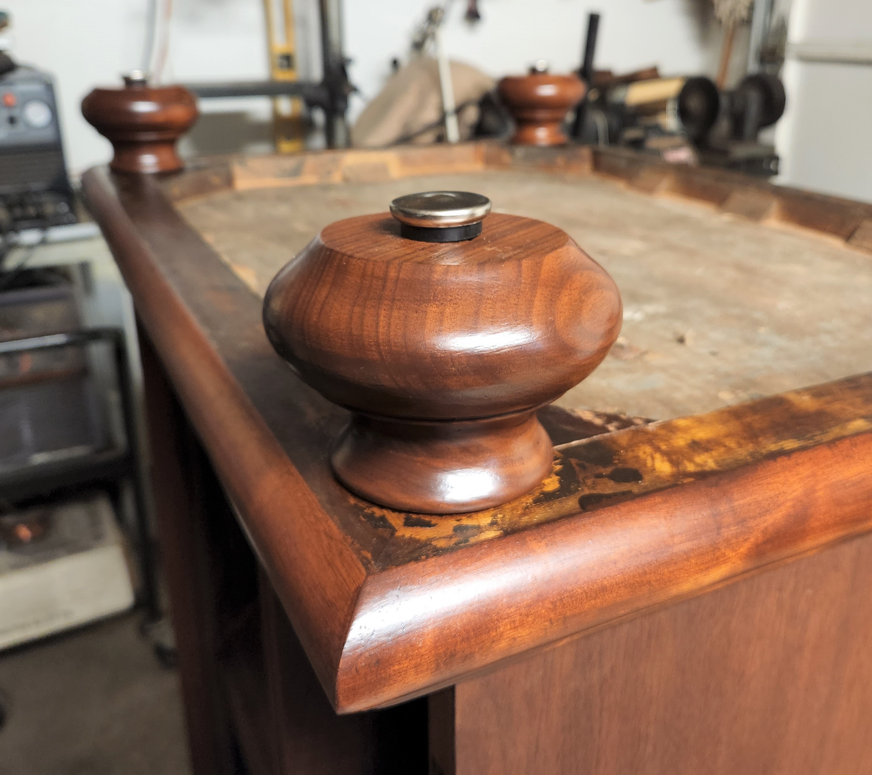

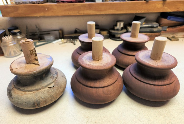

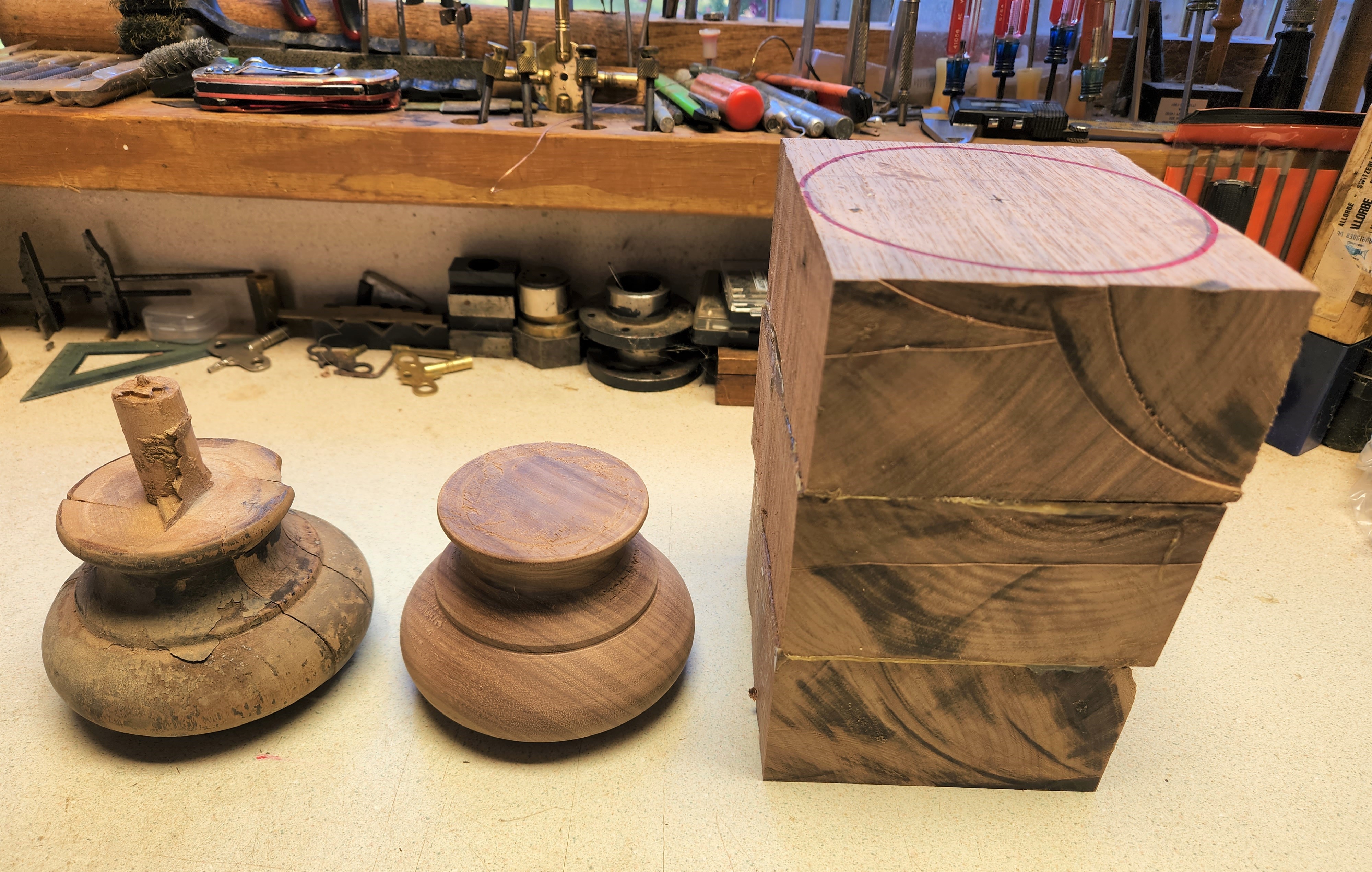

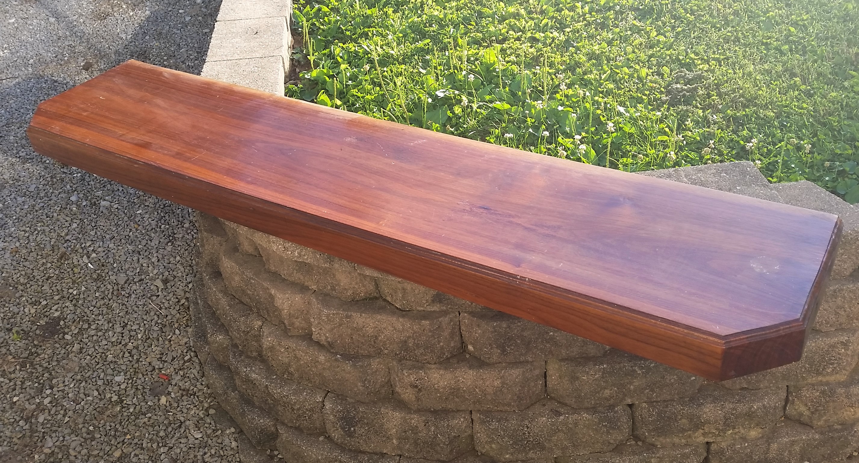

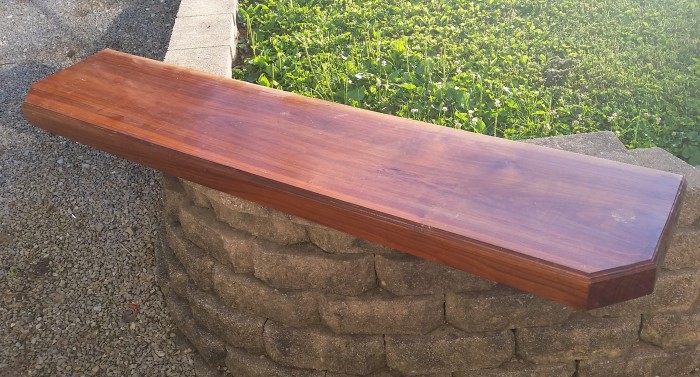

Now for the feet. I had a walnut mantle that came out of a late 1800's house in my home town that I have had for years. It is about 2 ¾" thick and 14" wide by about 6 foot long. It sounded like a good donor for foot material.
The dimensions of the one foot I had was 3" tall by 4 ½" diameter so I would need to plane and glue pieces together. I decided to cut 2 feet at a time on the lathe.
Just FYI it is not a good ideal to use over 100 year old walnut, hard as a rock. I had to wear gloves because the wood chips were so hot it was burning my hands. Also had to sharpen my chisels multiple times. The pic is a little deceiving as the angle makes them look different diameters but they are the same size.

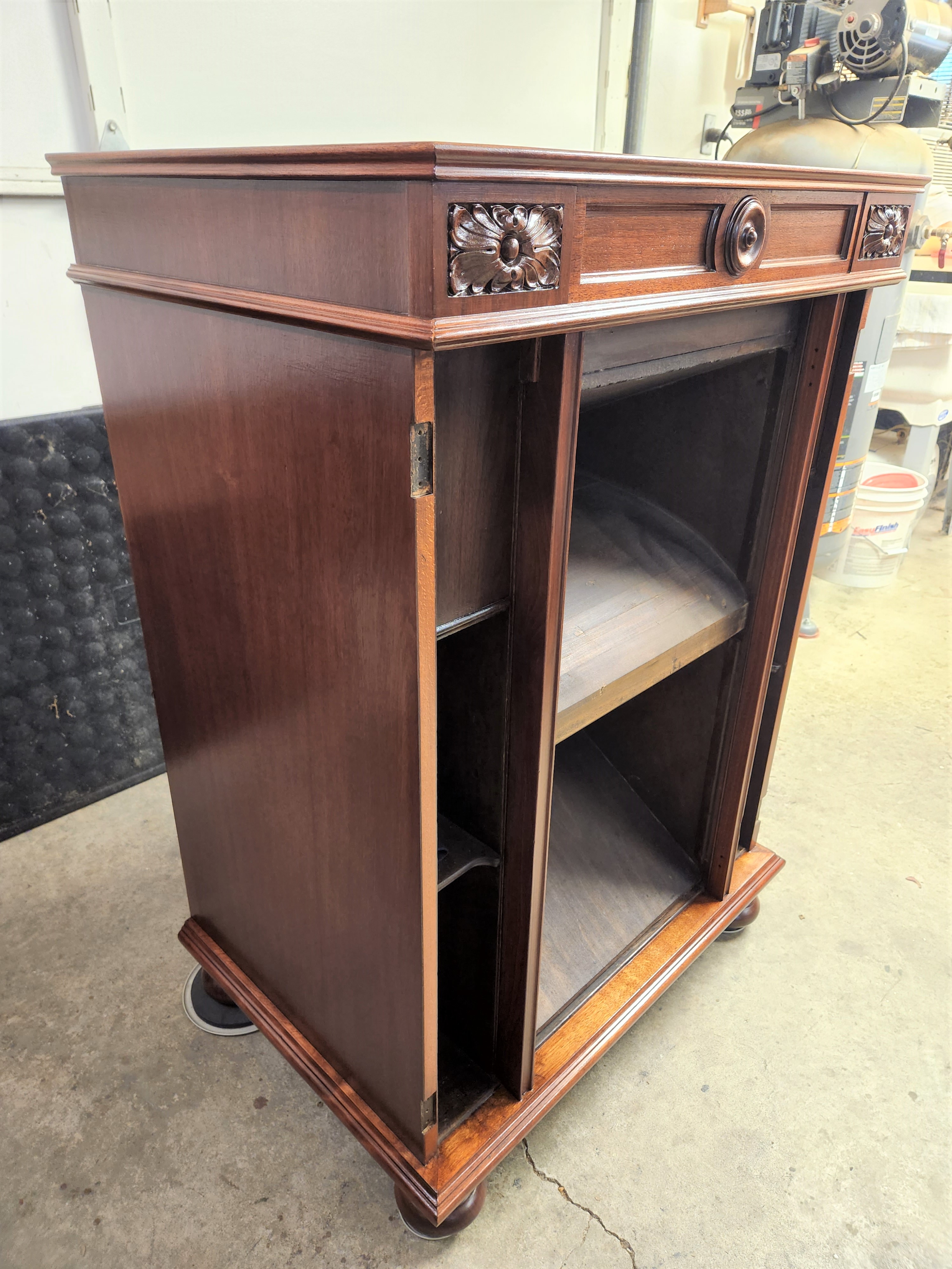

I hand sanded the cabinet and the details and trim with 220. I use small wooden blocks and different wooden dowels in various diameters to sand details and trim to keep the radius and edges crisp. I used American Walnut stain and 4 coats of satin lacquer and a light #0000 wool to finish the surface.

Re: Victor Credenza Barn Find Rescue And Info On The Restore
Post by dzavracky »
Wow that is really looking amazing. YOu did a fantastic job on the new feet.
