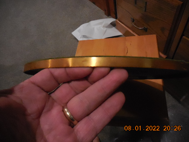

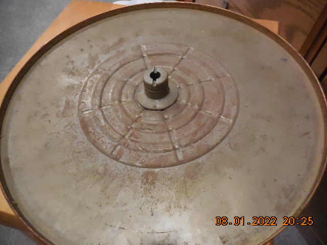

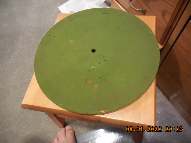

Hi Ben-- I dug this one out earlier today- It may be an extra one i have-- I have to match up some spare motors I have to see if it belongs to something :) I'm in the process of trying to organize all my parts.
But this is what you are looking for- Gold edge, 12" turntable. One caution-- Over a period of time Victor used at least two different sized spindles on various motors.-- The earlier XVI's had nickel plated edges on their turn tables, but I pretty certain by the time they got to the motor like you have, all the turntables were gold edged. I have a few motors like yours on my shelves. I will check this turntable on one to see if it fits the spindle- I'm 90% certain it will, but will double check.

Not a problem- Here's a little diagnostic you can do- Take your old turntable off. You will see three screw heads in a large triangle pattern. They are holding your motor to the motorboard. First tighten those screws to make sure the motor is secure. Then run the motor (without the turntable) Look at the spindle shaft to see if there is any wobble in it as it turns. If so, your spindle shaft is likely bent. The shaft should run smoothly with no wobble. If it does, then your wobble was probably from the wrong turntable. The spindle shaft should have a pin through it--side to side, that engages the slot in the correct turntable (see the pic I sent).
