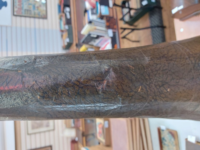

As I was in Cheltenham this morning I took the opportunity to view this and I took some pictures.
Something potential buyers need to know is the horn is damaged although this is not mentioned! There is a hole through it where it has been dropped at some time and the edge of a cabinet has dented it in quite noticeably. The damage is visible inside and out. It's awkward to repair as it is near the throat but the paper had torn right through and made a hole. The picture below is the outside. The photo inside just came out black so I haven't loaded it up.
Also, the auctioneers confirmed the winding handle is missing. The motor does turn but only very slowly although it is obviously wound up and is not simply just "running down".
Caveat emptor!

The photo makes it look a little less noticeable than it does in the flesh.
