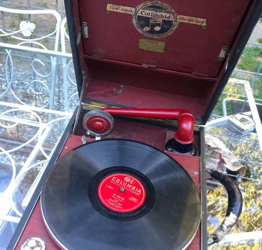

alang wrote: Fri Oct 21, 2022 8:53 am RE the Columbia Grafonola Portable 130, it is correct except for the reproducer. It had a black exterior, red interior, blue velvet turntable covering, red painted tonearm and Viva-Tonal reproducer. Unfortunately, they used terrible pot-metal especially on the reproducer, so most are crumbling beyond repair. I have two in bad condition that I hope to combine into one usable machine at some point. It looks so funky with all those colors that my daughter said that's one even she would like ;)
Andreas
Many thanks for confirming! The one I posted a link to above -- https://bellingham.craigslist.org/atq/d ... 31758.html -- on the site link that La Cah supplied in his original post looks to be totally authentic, then. It also appears to have its original sound box:
It seems well-designed, and should sound pretty good once restored.
