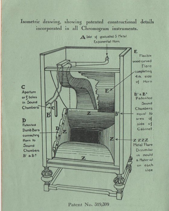

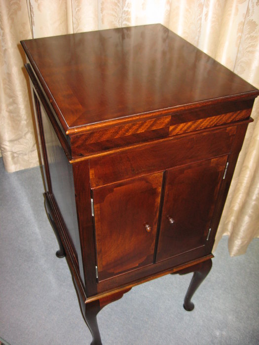

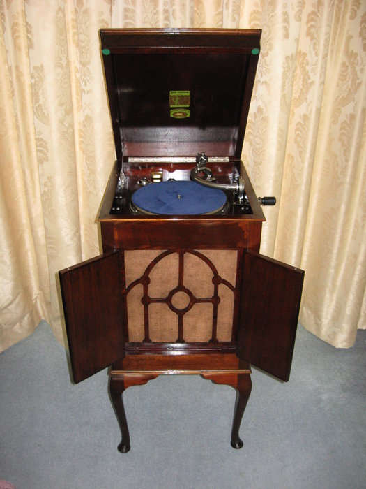

Some owners have filled the void around the horn with loft insulation, less heavy than sand and less messy than foam.
Attaching the horn to the cabinet sides with resonating panels was a feature of the Micro-Perophone Chromogram, the best cabinet gramophone most people have never heard of. I used one as my everyday player until the EMG/Expert bug bit me.

epigramophone wrote: Tue Dec 06, 2022 7:14 am Some owners have filled the void around the horn with loft insulation, less heavy than sand and less messy than foam.
