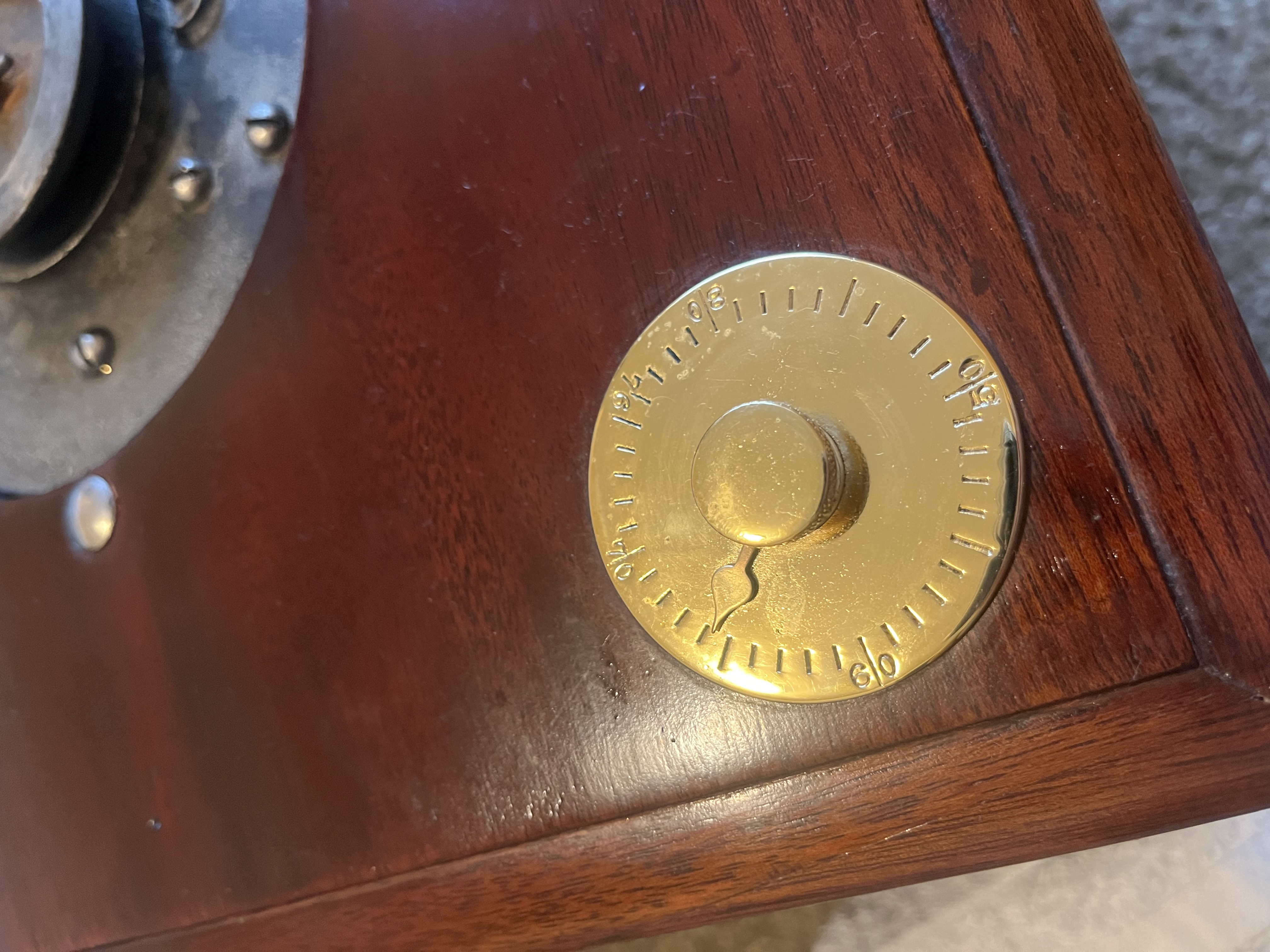

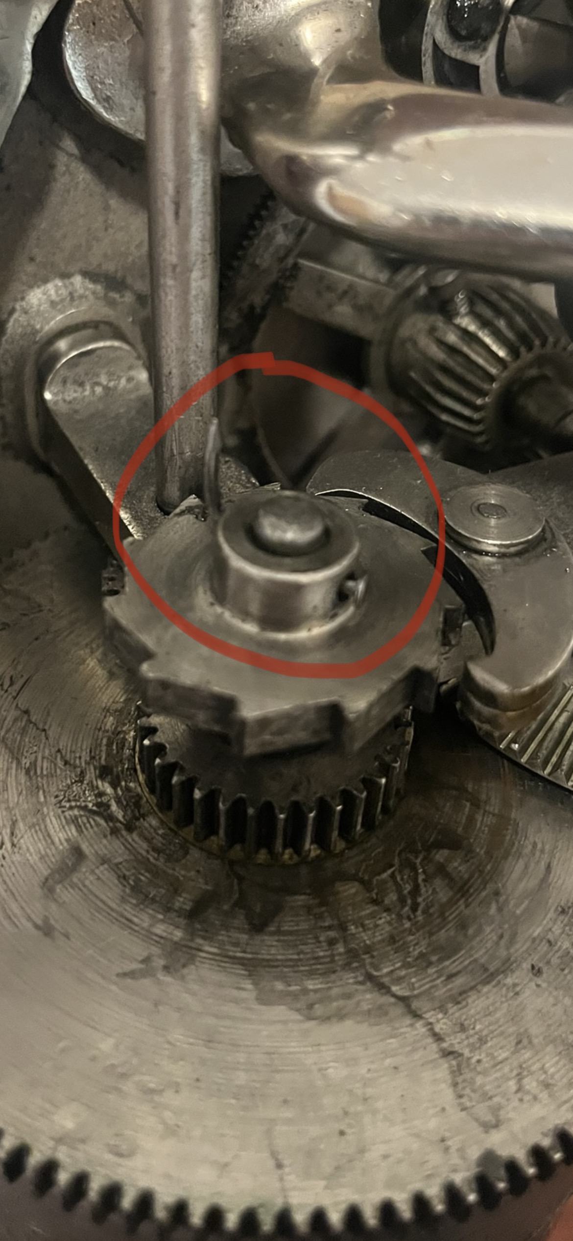

There is a nail holding the ratchet gear in place instead of a pin or screw. However that that I have gone through it more, all the motor needs is some greasing. The speed control knob is stuck in position. Something is too tight. Does the gold knob on top loosen?

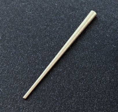

Can someone please advise me as to what part I need to replace this nail holding the gear in place.
Roaring20s
Posts: 2811
Location: Tucson, AZ
Re: Victor 6
Post by Roaring20s »
A parts supplier will have a suitable "tapered pin".
It looks like this example that's used in a clock motor ...

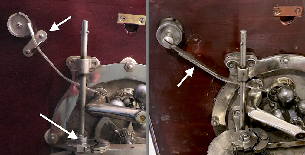

Here is a comparison too.
The speed control arm has been modified, but may still function correctly.
The missing slotted guide may help if it is not maintaining the proper speed.

I just noticed that on my speed control arm. The two metal pieces came apart and now it is too short. My speed control arm must have broken at some point and then it was modified. Will a new arm and guide be difficult to track down?

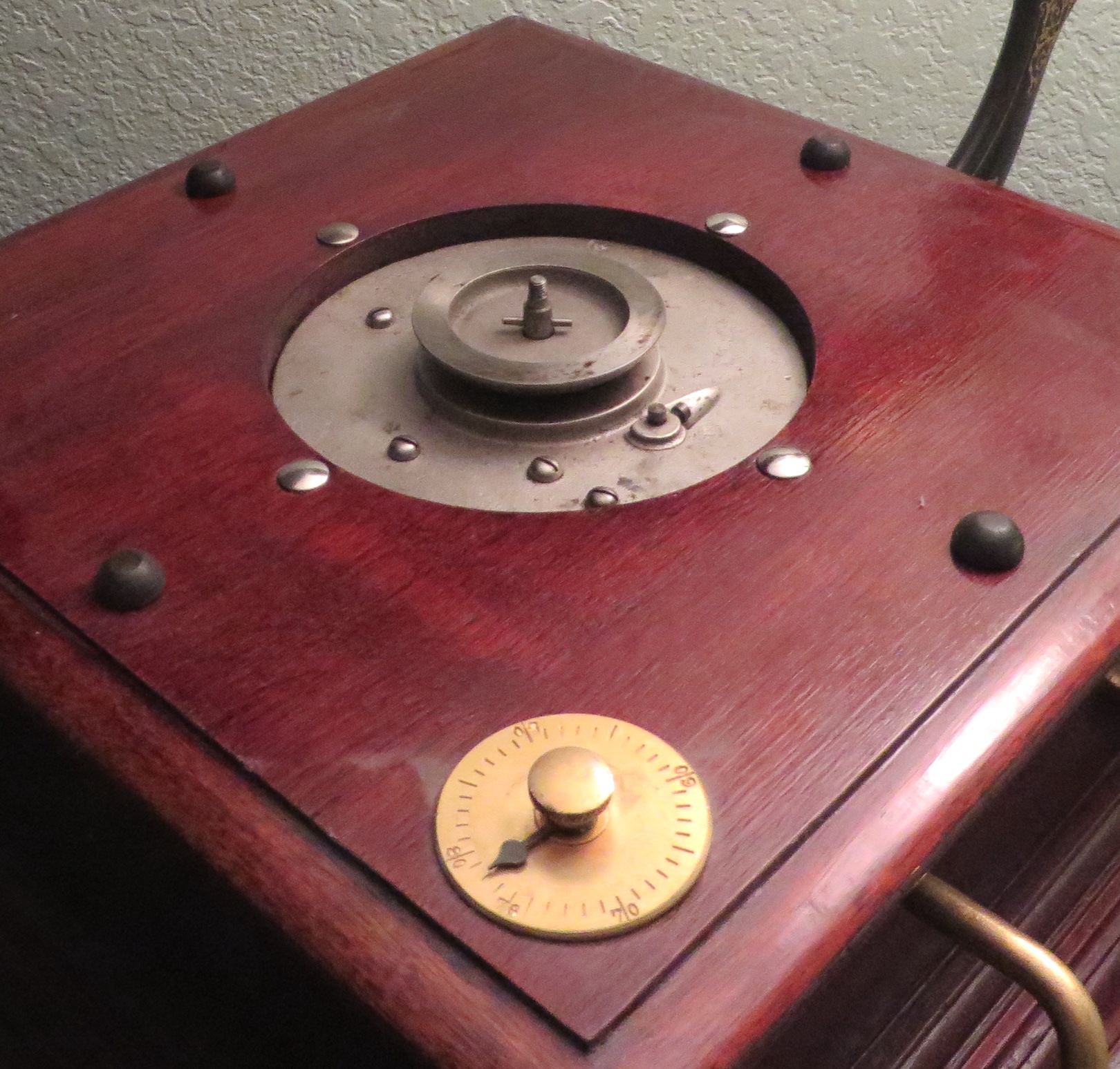

Adding to the motor conversation, my motor matches the one in this post.
The number is 5092.
