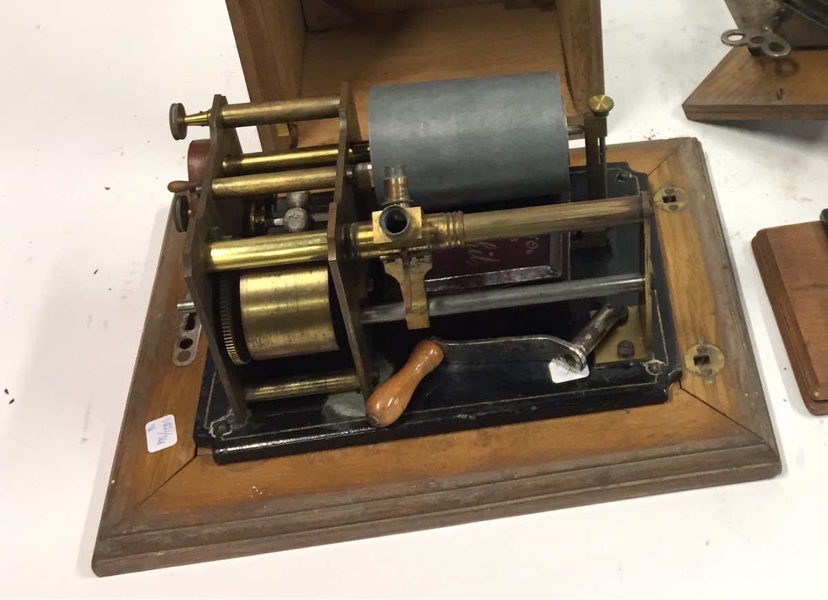

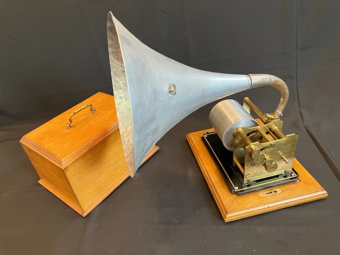

My guess is that this was an experimental disc machine built on the basis of a cylinder phonograph by the French manufacturer Louis Lamazière.
We can compare its various elements, similar to those of Lamazière n° 2 (1899), predecessor Ideal sold later by La Maison de la Bonne Presse, of which here are photos.
Julien.
Julien.
