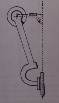

The tag figures shown in photo No.6 are individual measurements of the achieved offset following initial bending. It is nearly impossible to bend thick-wall tube to a consistent fine accuracy but, after having taken measurements on an assembled EMG base unit, further secondary bending calibration can be made---thus exactly achieving the desired 3 ¾ inch offset. The secondary bending was carried out using a custom built holder held in a vice and with the aid of a simple specially formed tool.
