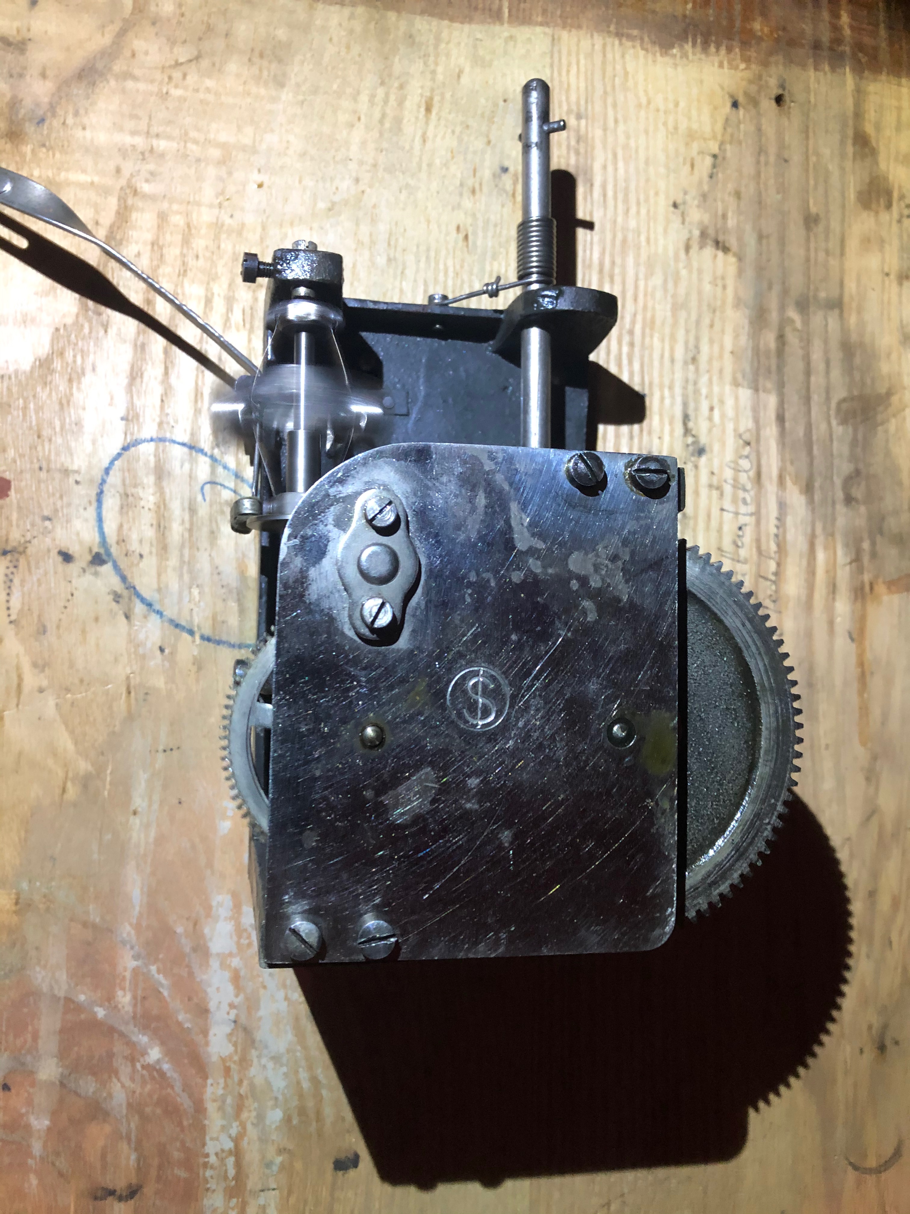

Do you know what brand the motor is?
It almost looks like the Thorens motor that resembles the Garrard 1A, though I'm not sure which company copied the others design first.
A picture of the bottom plate of your motor would be helpful in identifying it.

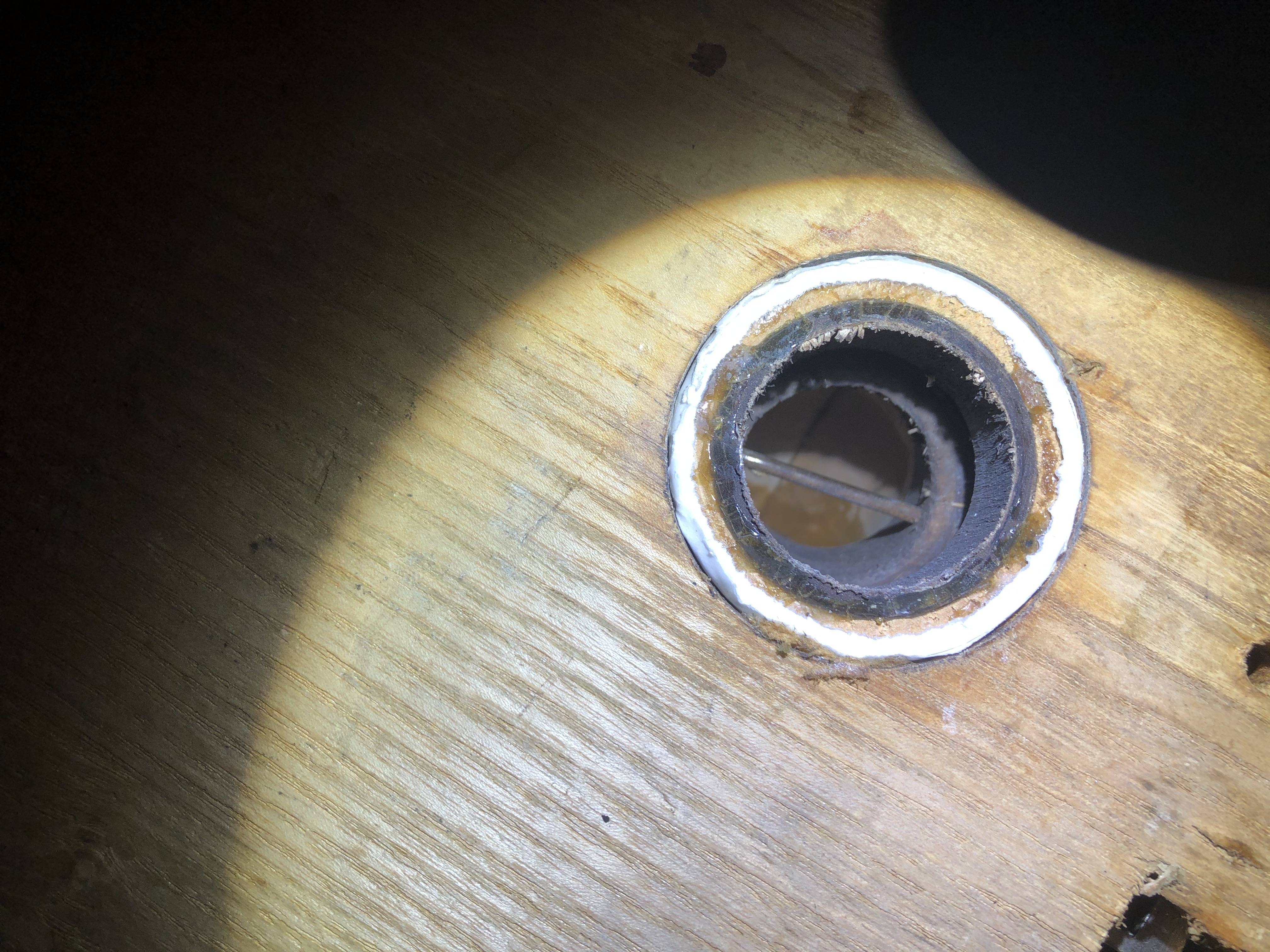

Hmm! Must admit I am a tad disappointed. I spun it up and played a few records. Although the wind wanted to be smooth after the third side it developed a hard clunk every few turns of the handle, so I´m thinking I may take the motor back for a check.
I also find that the turntable needs balancing, without the plate the motor runs very smooth but with it on it gets kind of rumbly, as it is one of the older types with holes I could get away with a few strategically placed lead fishing weights.
A big problem is that I cant figure out how to dismantle the ball join without breaking anything, it seems to have been glued in recently, whereby recent is a relative term, there is a rusty bolt though the ball that you can see if you turn the head upside down and look into it, to dismantle this construction I think would take more tools and more knowledge that I have available , (I´m a WD40 if it doesnt move then hit it with a club till it does move, if it moves too much then Duct tape kind of guy) so I am not sure what to do, I think I´ll take it to the local carpenter who has a thing for old furniture restoration and tell him to have fun.
It is going to be a beauty when I am happy with it, but until then it is going to be polished and admired but put to one side until my other projects are done and I am going to play my records on the HMV and the Serenade.
Looking at the bottom side picture over a meditative beer, it may be possible to tap the entire arm out of the hole.... Now where did I put the club?

The logo on the bottom plate of the motor could be Steidinger.
slammer
- Victor O
- Posts: 78
- Joined: Sun Jul 24, 2022 1:02 pm
- Personal Text: I love the smell of Shellack in the morning
Re: Grammoporn
Uff! If my google-fu is strong, then Seidinger is the granddaddy of Dual, and as I just read, the name "Dual" comes from Steidinger´s hybrid electric-spring mechanic gramophone motor.epigramophone wrote: Tue Jan 24, 2023 1:12 pm The logo on the bottom plate of the motor could be Steidinger.
The more I dig into this passion, the more I see how things are connected, it is astounding how interwoven todays brand names are connected to the past.1907 als "Gebrüder Steidinger - Fabrik für Feinmechanik" in St. Georgen im Schwarzwald gegründet, in der neben Uhrmacherwerkzeugen auch Grammophone mit Federantrieb hergestellt wurden, entwickelte sich das Unternehmen unter Leitung von Christian Steidinger (1873-1937) nach dem Ersten Weltkrieg zu einem der führenden Phonohersteller. Seit 1927 produzierte Steidinger als neuartigen Antrieb eine Kombination aus Federlaufwerk und Elektromotor, den Elektro-Feder-Motor, der "Dual" genannt wurde und zunächst den damit ausgestatteten Plattenspielern, später auch der Firma den Namen gab.
Just need to figure out who built the device from the manufactures logo, have not idea but I am enjoying the hunt.
