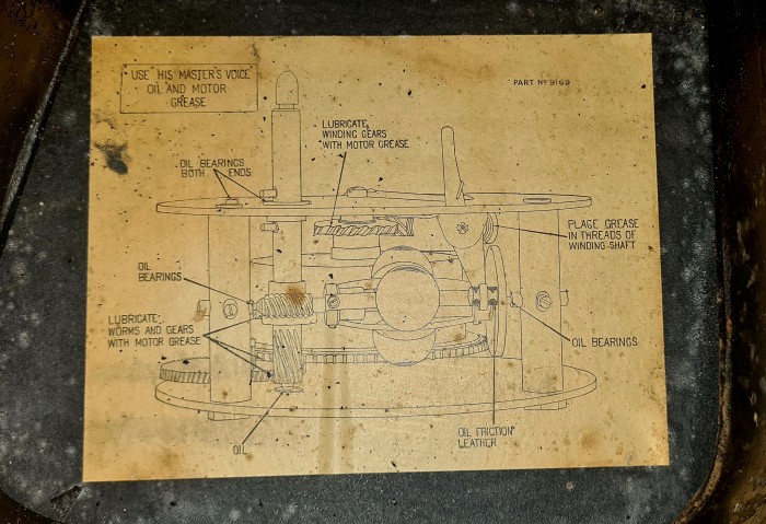

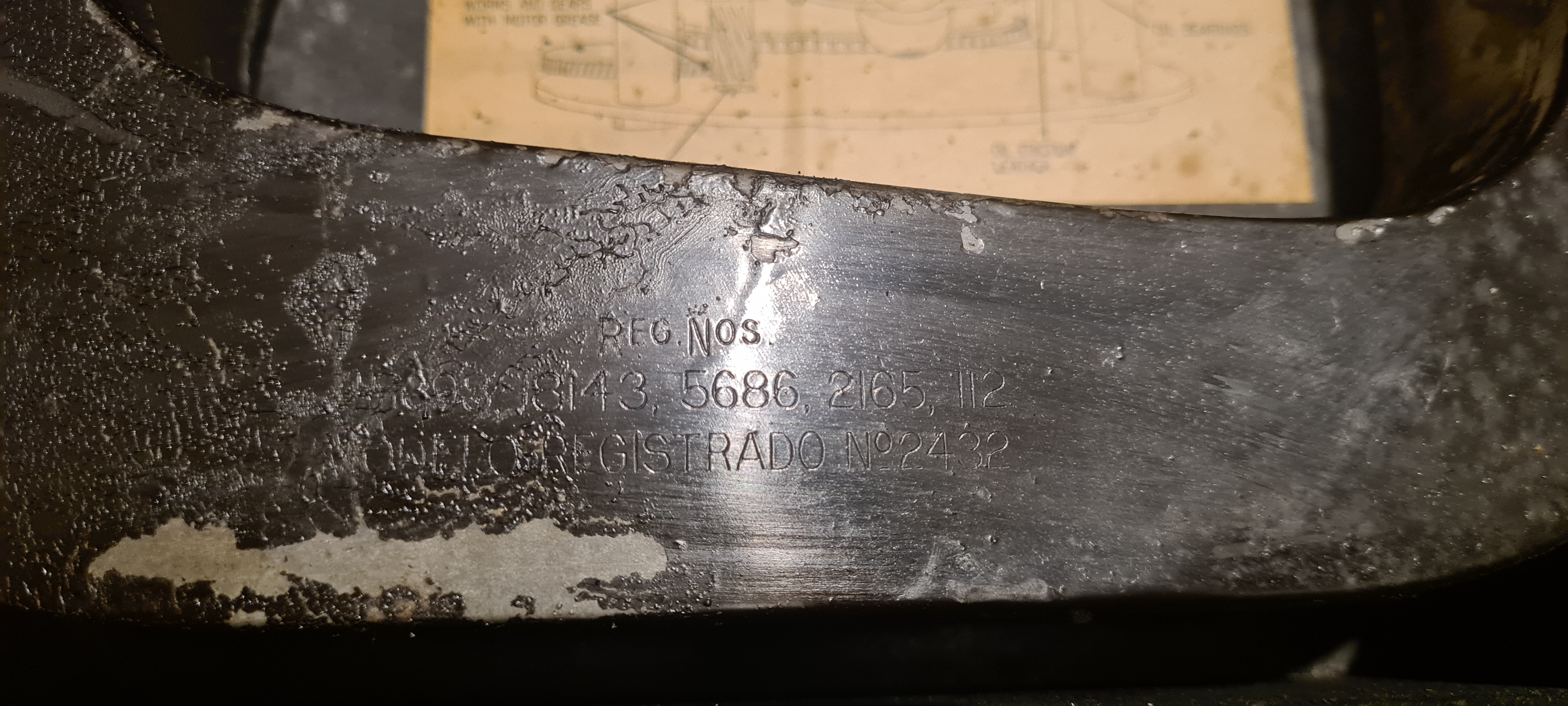

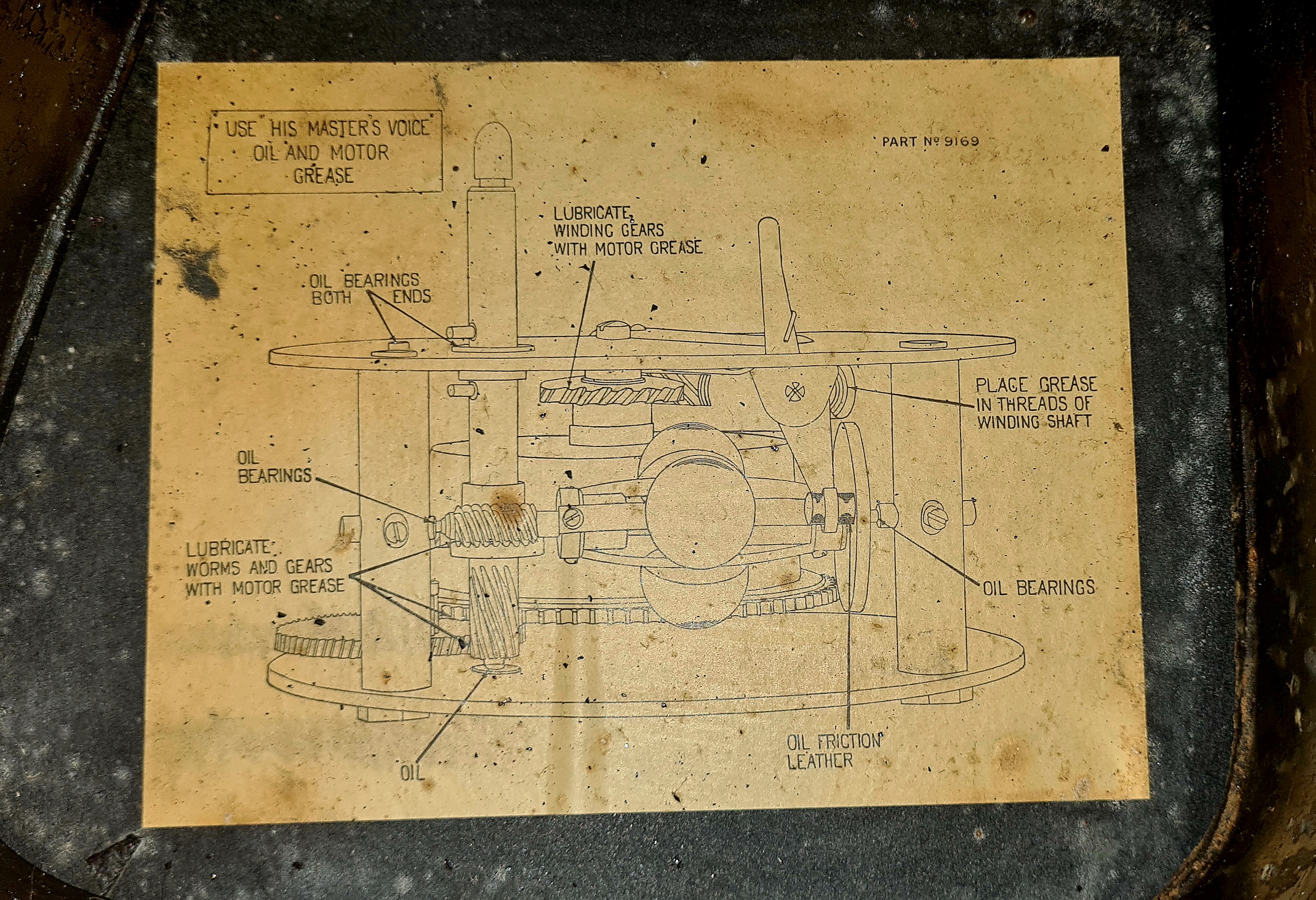

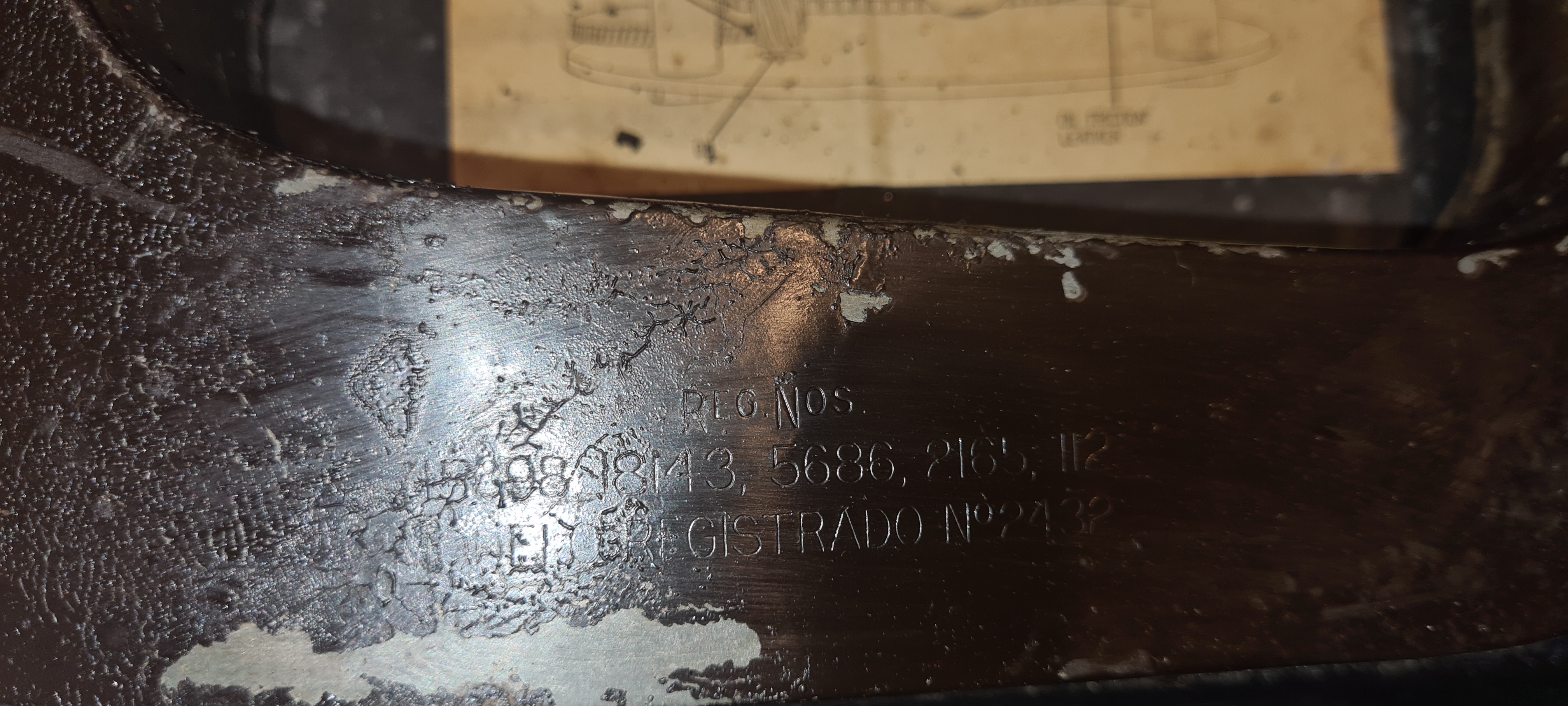

I carefully removed the wooden panel under the turntable, no labels or ivorine plaque but did see these part numbers and oiling diagram.

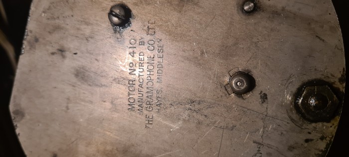

It's a 410 motor, and the early type of lid catch, so a 101C, 1927-8.
