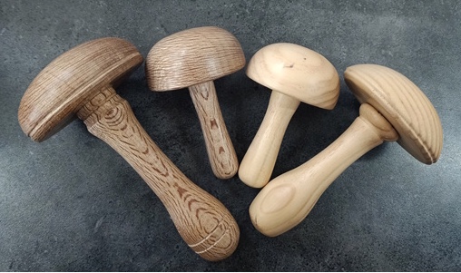

No no they shouldn’t make you nervous. It’s the safest method I’ve found. Not like getting a hammer out. I see the dents are pushed inwards so why not try taking just one darning mushroom and try pushing the dents out from the inside of the horn. Rubbing up and down with a bit of strength. Anyway I’ve seen worse dents so it’s still a good horn.

I actually had to google what a darning mushroom is. I have never seen one of this before here. I will buy one online, I understand they are made of wood.
Thanks Jamie, I will try it...carefully.

Yes made of hardwood normally beech. Probably best to get a rounded one rather than a flattened one. Isn’t there one in mother’s old sewing box? What about the old lady next door? I think folks just buy new socks now. Darn useful items to have to roll out small dents.
Jamie

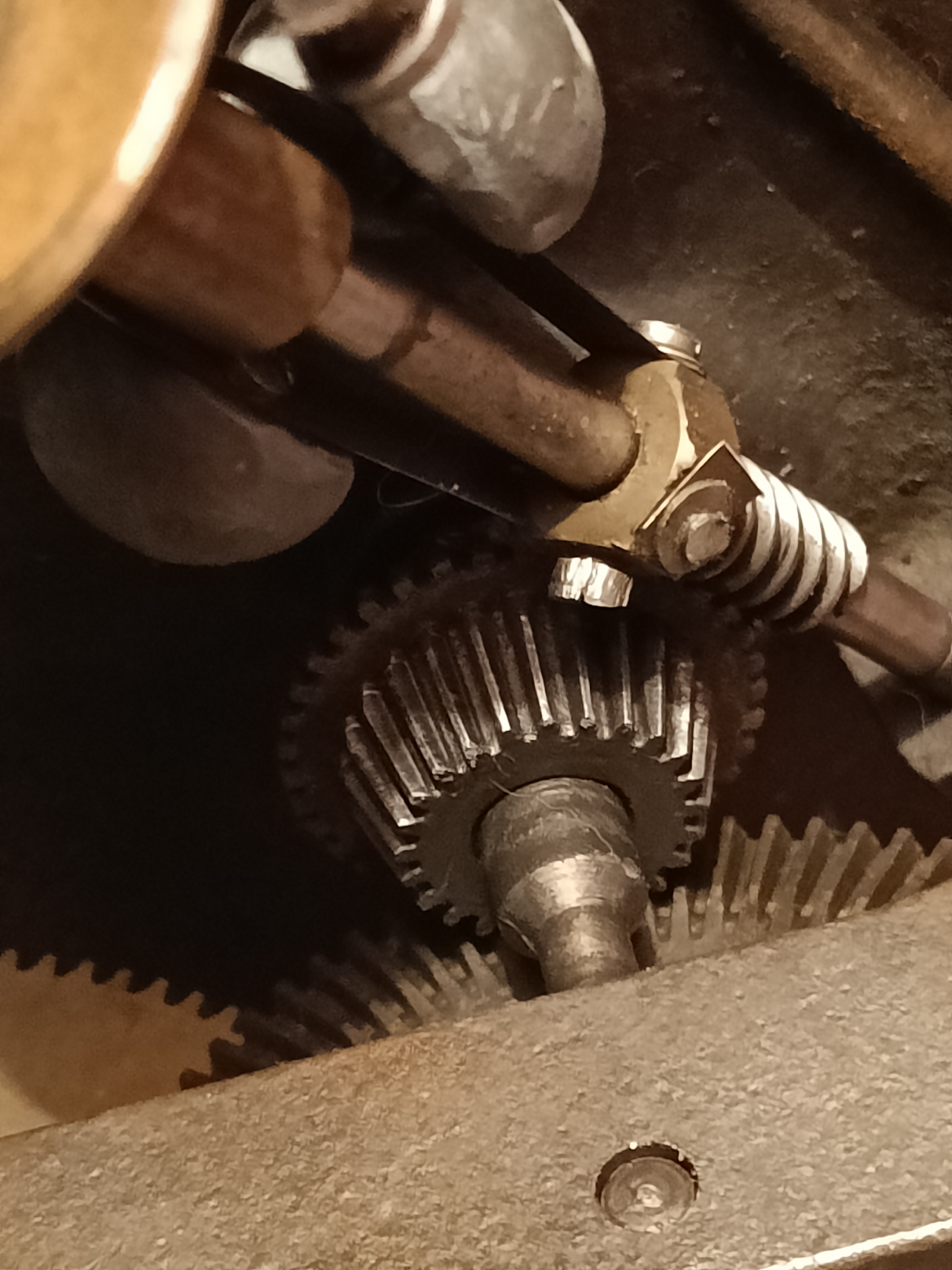

I need some guidance, from someone knowing these early HMV motors, since I have not yet serviced one of those.
Should I take any precautions before removing the turntable from this motor, or said in other words, is the turntable fastened in a similar way as on the later 32 motor? (I have removed plenty of turntables from the 32/34 motor) It is somewhat stuck, and I wanted to ask before applying some force.
We can see someone has tried to repair one of the governor springs, and substituted a probably lost screw with a small rivet or something similar. I hope they have not ruined the threads, I have not yet been able to remove the rivet, but am working on it. The rivet has later on caused the spring to break.

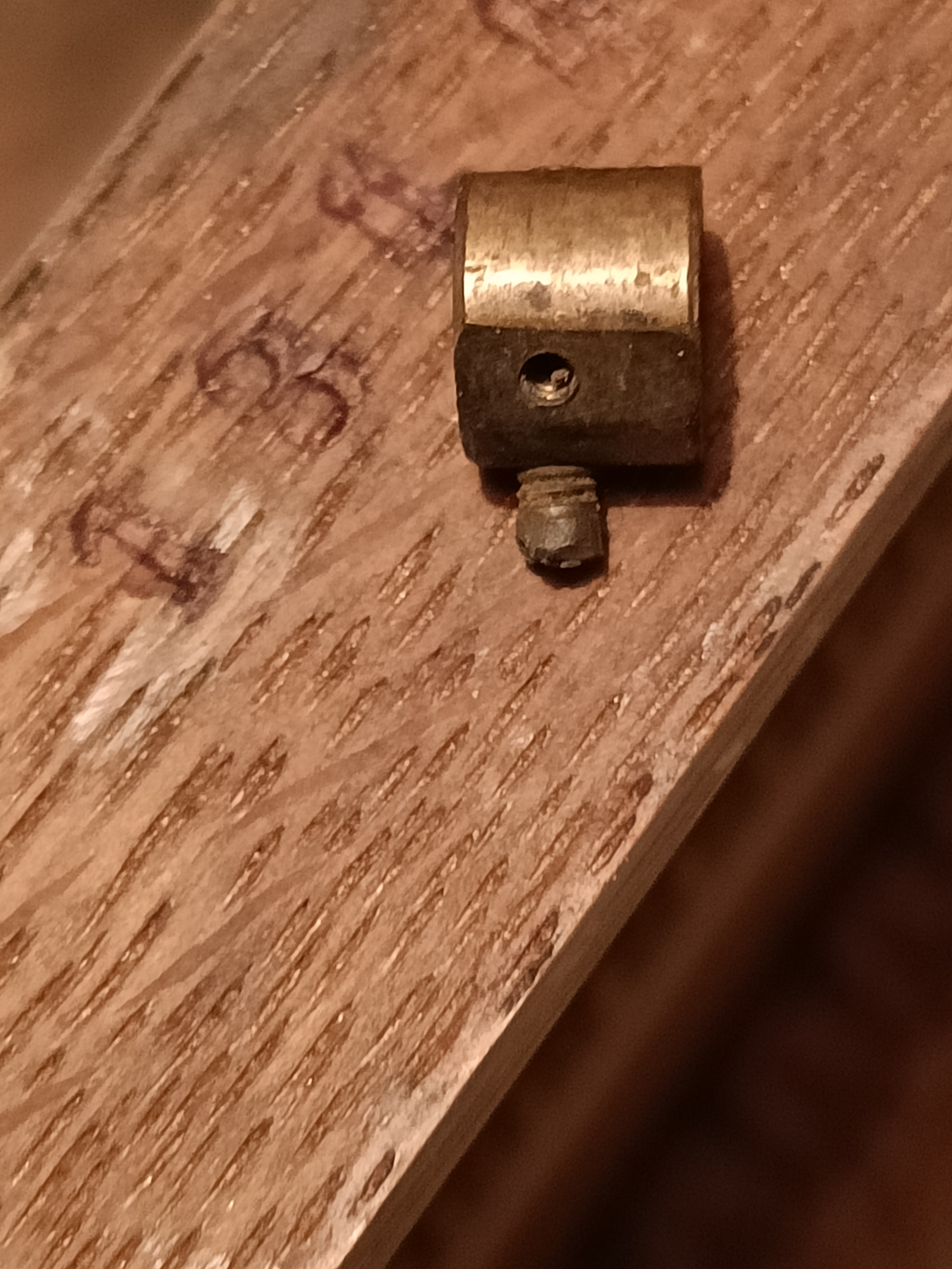

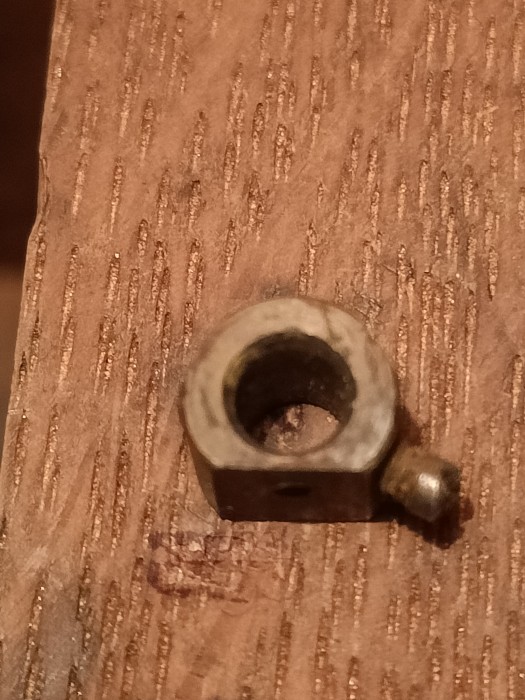

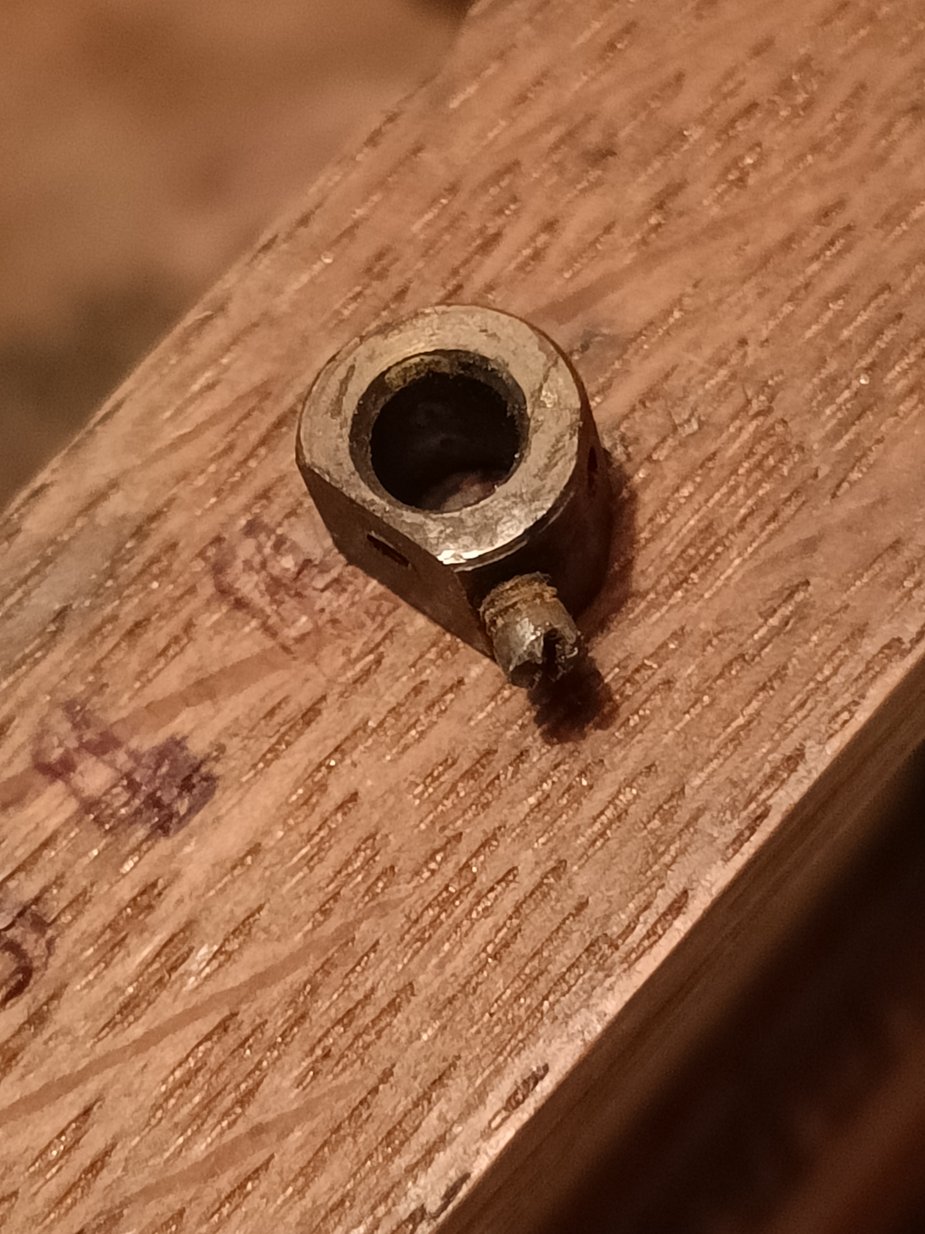

I also found this small part at the bottom of the cabinet, does someone recognize it, and what it is, or if it even belong to the motor? The size is approximately 8 mm.

I believe this is the type where the spindle unscrews to remove the turntable. There is a slot in the top of the turntable spindle where you place a well fitting screwdriver or you can place the length of a thick knife, that fits tightly, for more leverage. Hold the turntable tight and gently attempt to unscrew the turntable spindle counter clockwise.
In the older type, generally seen with the clamping plate, the whole turntable unscrews from the spindle shaft.
Jamie

nostalgia wrote: Fri Feb 24, 2023 5:43 pm I also found this small part at the bottom of the cabinet, does someone recognize it, and what it is, or if it even belong to the motor? The size is approximately 8 mm.
It appears that this part was originally from the governor. It has been replaced by the hex nut.

The stray part does look like part of the governor, but it should have three equal size flats, so it has been vandalised, which may be why someone has replaced it with a nut.
