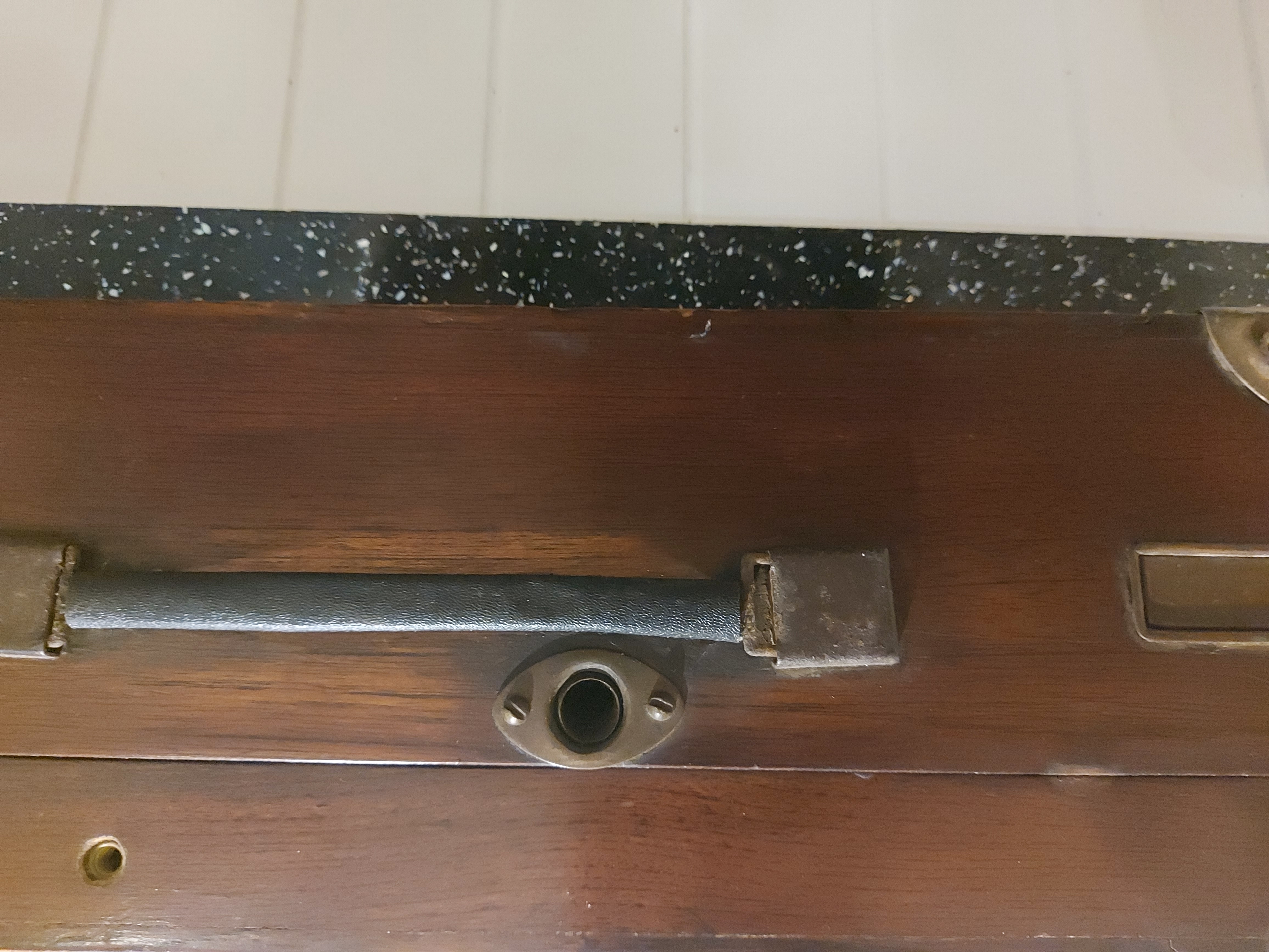

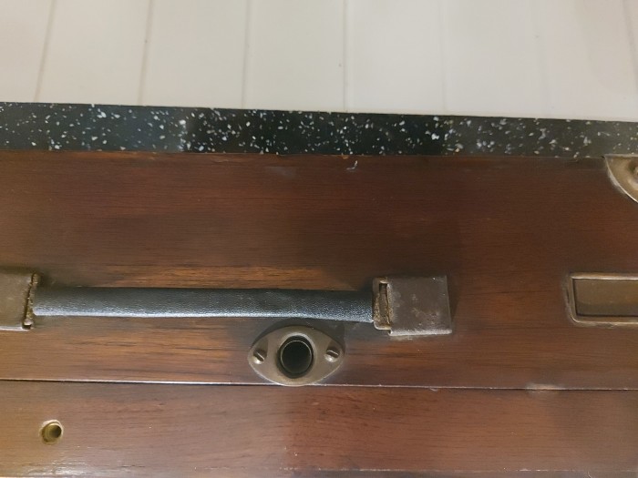

Can we conclude then that the one in discussion is authentic? (apart from the escutcheon installed in the wrong way)

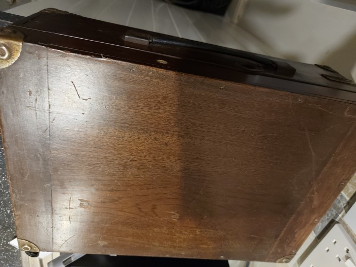

Check out my side winder below and tell me if you spot the difference!

Shall I put you out of your misery? :lol:
No, I can't tell anything conclusively from the poor quality photos but it doesn't appear to have the normal HMV motor? Notice the winding position is further back than mine which is quite standard by comparison? It has to have a different motor but maybe its Swiss or something even stranger? No HMV double spring would fit in that space but a cheap Swissy double spring might!

I could be wrong with this but it wouldn't surprise me to find a Swiss or German motor in there. Some years ago a colonial machine turned up in the shape of a 102 but it wasn't HMV and was Swiss made. Who knows how many different "spare parts" from different makers ended up in the collective pool in India at one time. These machines were kept going for long after they were obsolete in the west. A retailer could have cobbled anything together.

Steve, your eagle eyes detected a subtle anomaly! There is a high probability that this machine was tampered with and had its motor replaced, which may even explain the outside-in escutcheon. There is no visible original winder hole, but as you said the photos are poor and there could be an original hole filled up.
