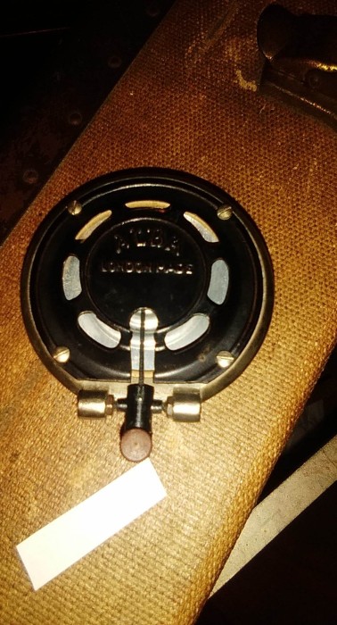

This is the reproducer. I massaged a dent out of the diaphragm but will have to change the gasket tubing and perhaps put an Orthophonic isolator in the back of it fits.
The whole machine is pretty cool. Paillard motor, steel horn, mouse nest and torn up grill cloth, the works. I'm going to get the old thing working in a while and start stripping it then after that..

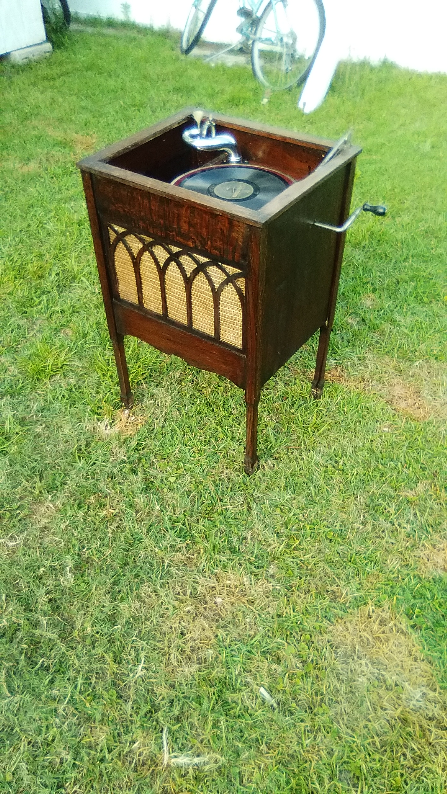

Getting somewhere.
Still needs a little work.

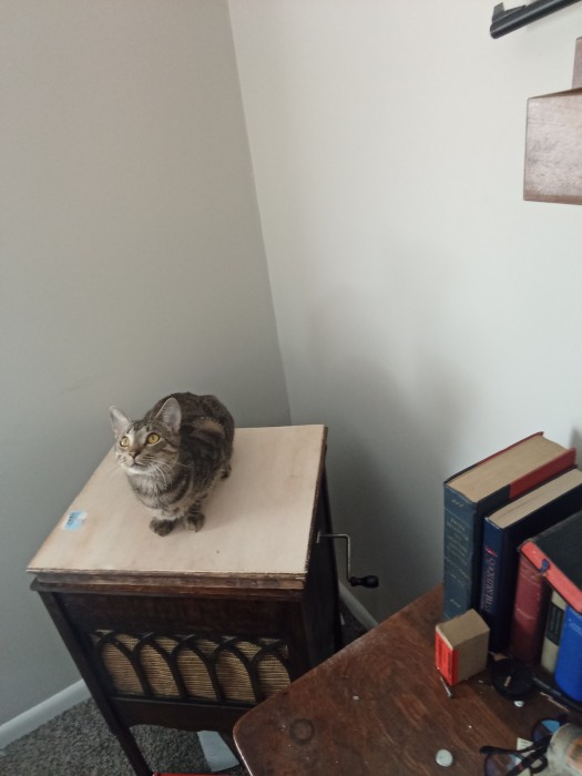

Long time no work. I moved to Florence instead of home, and in the process somehow the Vokal got along for the ride but I haven't really done much to it.
I was thinking about getting rid of it. The top warped worse and worse. My girlfriend Kelly and I steamed the top of it with an iron and a wet towel and peeled the flaky remnants off the plywood substrate.
It then warped again.
The machine has set in my apartment and been played relatively seldom.
I knocked the lid apart and replaced the rotting plywood top with a piece of Lauan plywood, aka "Philippine mahogany" back in the 1950s, which isn't quite accurate for an English machine of the 1930s, but it's better than a swayback lid.
It will be in line for some peel-stick veneer, later, only on the exterior surface of the top.
Weight testing right now with the official gramophone weight tester.
It does still play. The soundbox was on my VV-XIV for awhile and picked up a buzz so I need to adjust it. An older style open face soundbox would be interesting to swap into this. A lot of the wood screws out of the lid are also missing so I'm looking to get more cabinet hardware, and finish the machine up properly.
