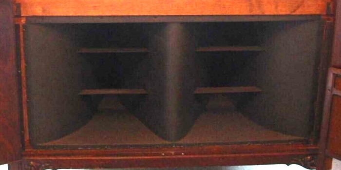

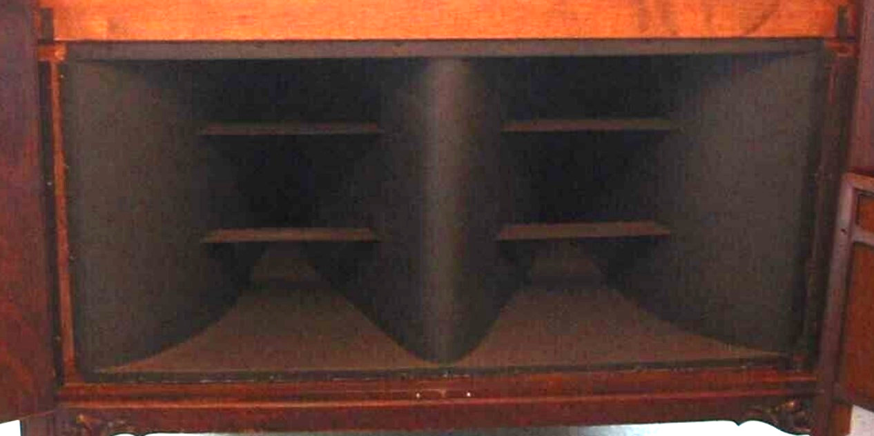

Steve wrote: Thu Feb 22, 2024 4:27 am I'm not sure from the poor photos but it doesn't appear to have four chambers either, only two? That horn is a completely different proportion to a 202 or indeed any of the upright models.
(Click Image to View Full Size)
I upped the brightness and resolution and can clearly see the center "heart" encasing the four chambers--typical of all HMV re-entrant horns. (It looks very much like the type installed on the HMV 163, in fact.) As you know, the two chamber HMV 157 horn simply shows an open mouth with no divider in the center. It also differs from the bifurcated metal horns (British) Columbia installed in their Viva-Tonal cabinet models.
I agree that the horn looks very elongated horizontally, but I also see some distortion in the photo, perhaps caused by the cellphone camera's lens. Judging by the size of the record on the turntable, which looks to be ten inches--possibly 12--the horn measures at least 30+ inches from side to side in its horizontal position.

OrthoFan wrote: Thu Feb 22, 2024 1:07 pm

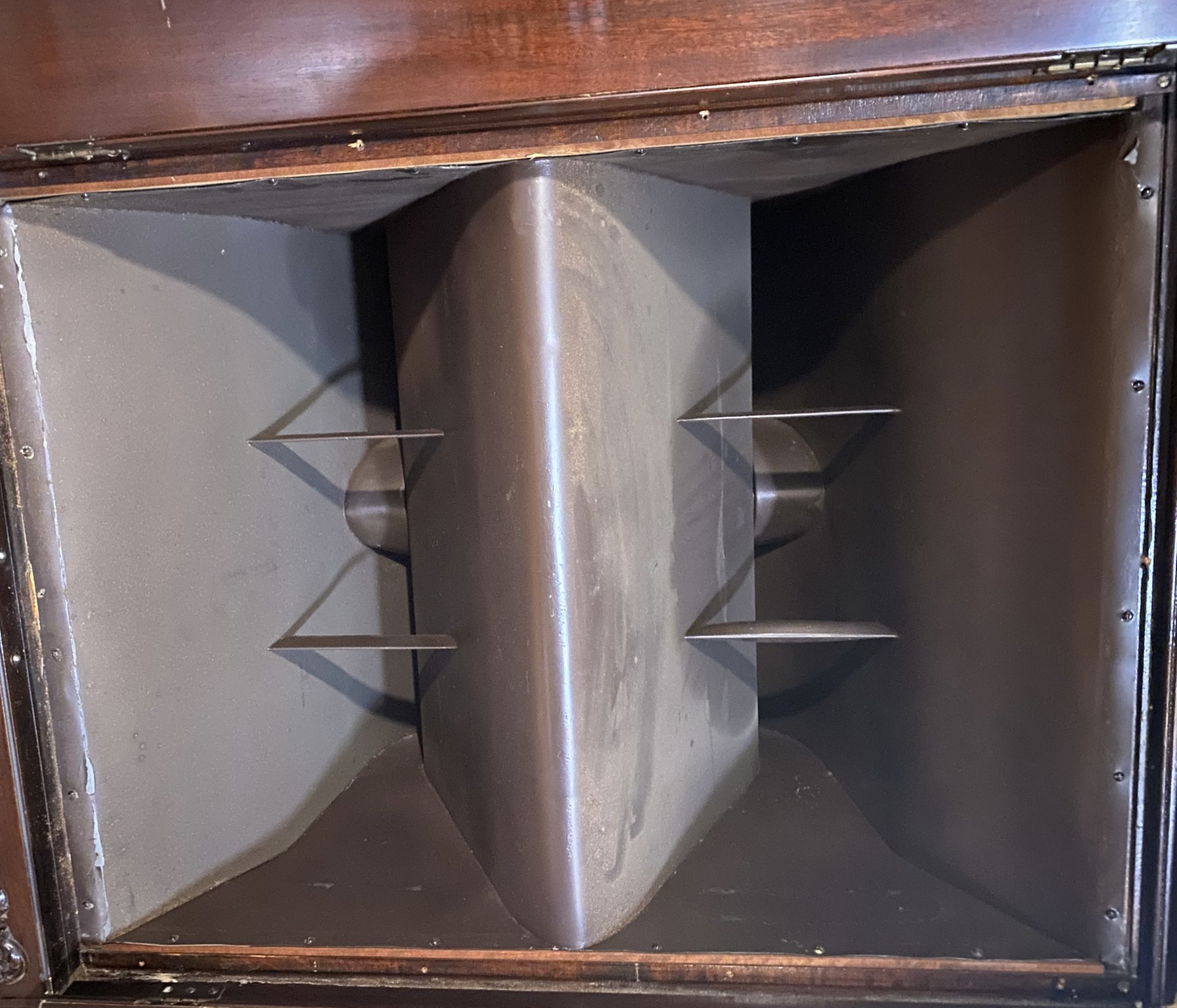

For comparison the horn of my 203
Thanks for the upload. I didn't want to take the grille off my 202 to show what you have done but I think you've confirmed that the 202/3 horns were in fact different to the 1A's, just as I thought!

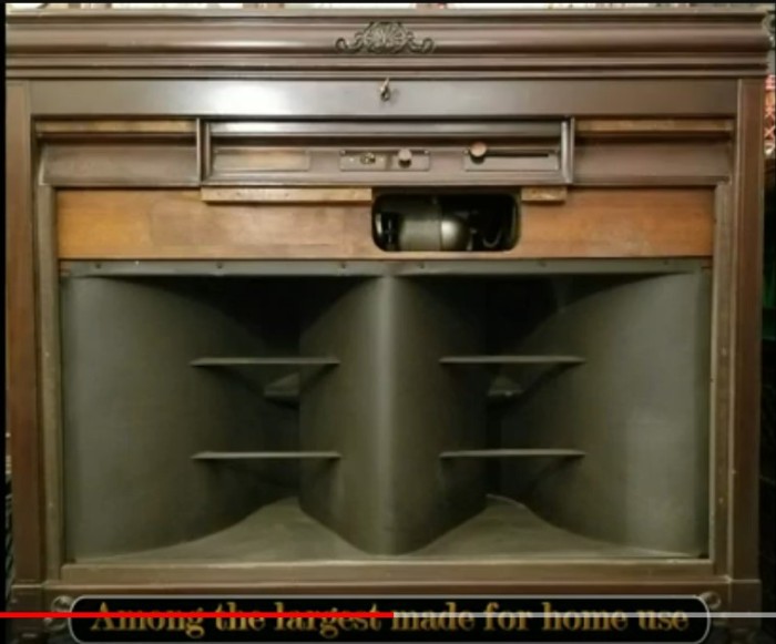

Here's another screen shot of an HMV Automatic 1A horn. (This one is the door-less model described in the link I posted earlier in this thread, which nobody probably read... :? )
FROM -- https://www.youtube.com/watch?v=Qi70G1Rzqpo
It looks to be about the same as the horn installed in HMV 1A in the OP's post and is obviously a re-entrant style four chamber horn, though compared to the 202/203's horn, I agree that it's very different. This leads me to believe that a horn specifically designed for this model was installed, contrary to what has been reported.
It's interesting to note, though, that according to the contemporary review of the 1A (which appears in my earlier post) a NINE foot horn was described. Perhaps a conventional 202 horn was installed in the first demonstration models, but never made it's way to production.
It would be interesting to know the dimensions of this horn. I'm wondering if the one or two lucky owners of an HMV 1A also own a tape measure.... :roll:
