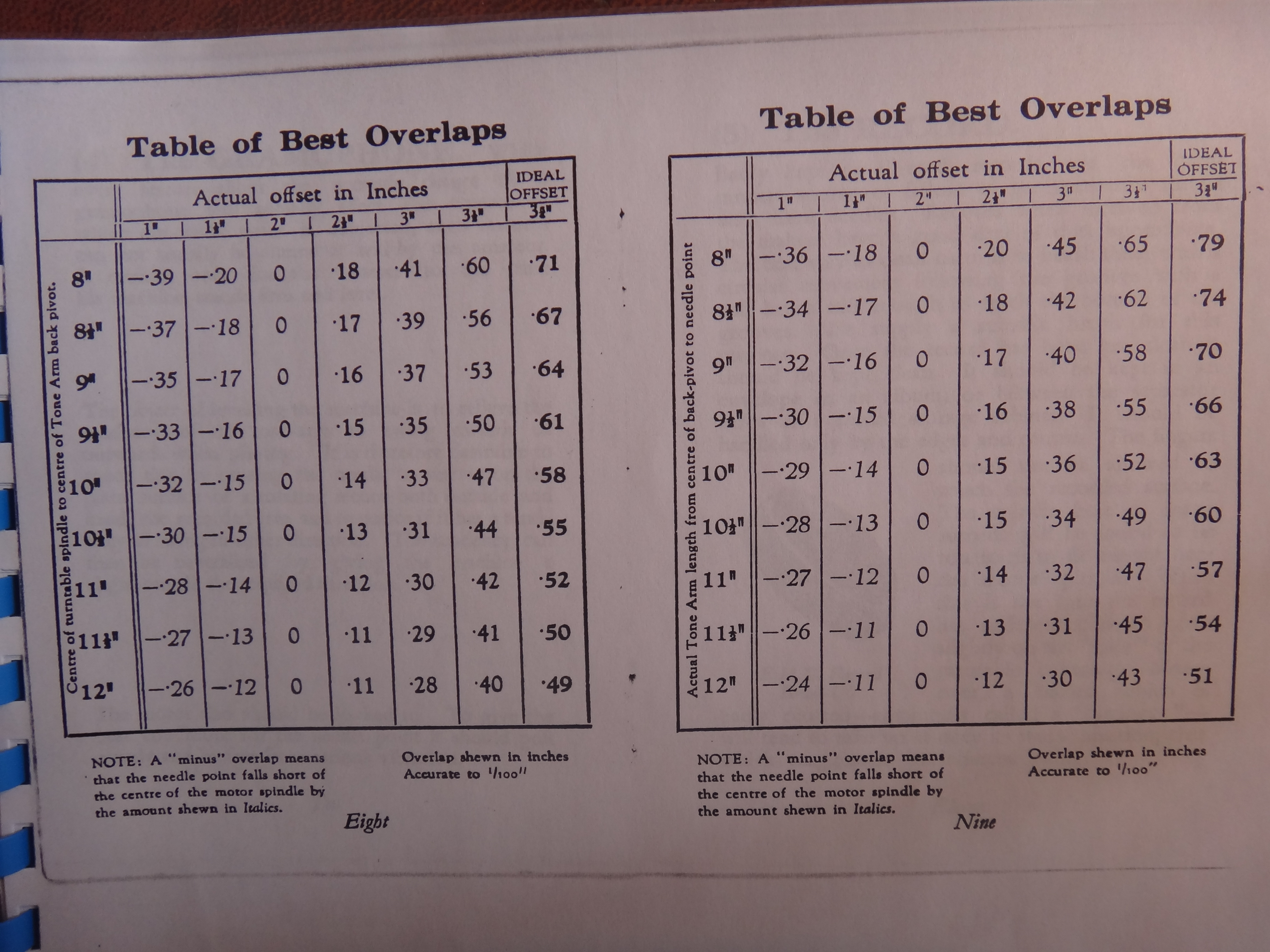

The angle, as such, is relatively unimportant and is dictated by the correct overlap. The latter is the really important factor to have right. Even companies like HMV did not understand this in the mid nineteen twenties and offset, and therefore tracking, was not good. The cardboard angle plates supplied by some companies to aid tracking were only ever a very rough guide. Results and angles are varied by factors like turntable height, needle extension etc. The extracts below are taken from an EMG handbook prompted by Percy Wilson who was the first person to sort out the definitive geometry for the industry.

emgcr wrote: Tue Jan 30, 2024 10:26 am
poodling around wrote: Tue Jan 30, 2024 5:21 am As you say these sound-boxes can be twisted so the needle meets the centre of the motor-board but then, when using this 'adapter', the needle angle (as it meets the record) is incorrect I think. Too 'up-right'.
Very interesting. Thank you.
