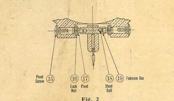

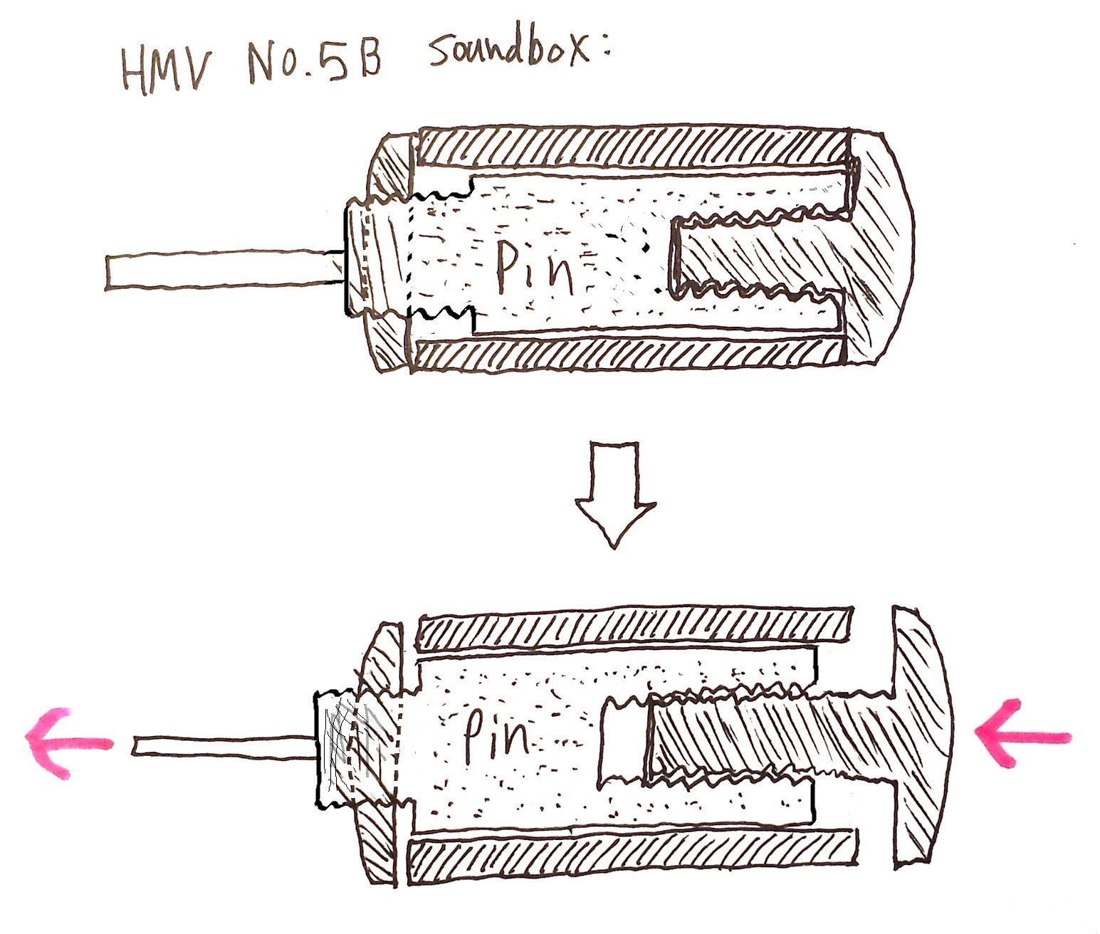

Be aware when adjusting the pivots that they are not quite as simple as they look - as these two images will explain.
APOLOGIES to whoever on this forum posted the useful hand-drawn one some years ago, I have long forgotten who that was (and thanks again).

Orchorsol wrote: Tue Feb 27, 2024 10:23 am Be aware when adjusting the pivots that they are not quite as simple as they look - as these two images will explain.
Those are great! Just got it on the bench now as I'm wondering if the bearings are dirty/seized leaving it all a bit to rigid.
Good advice!
Also worth noting that the little brass tube things that the pivots sit within are soldered to the front of the soundbox with very little solder. It’s really easy to put too much force into unscrewing them and breaking the mount off. It’s a real pain to get them back on and re solder but can be done, carefully!
Thanks for posting, pal! It's curious how they made it so uselessly complicated when all they needed to do was to thread the receptacles; surely some patent issue involved. :coffee:
I also have a 5A that sounds horribly; I've always blamed the felts (and could never find the time to replace them...) but now I wonder if it could be worth re-adjusting the ball/pivots first and forget about the felts.
