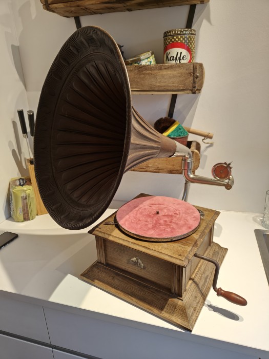

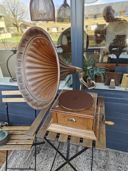

I have a picture from when I got this and a new one ass well I want to show you
If you find a soundbox that would fit this machine and the winding handle I would love to know
Kind regards Patrick
